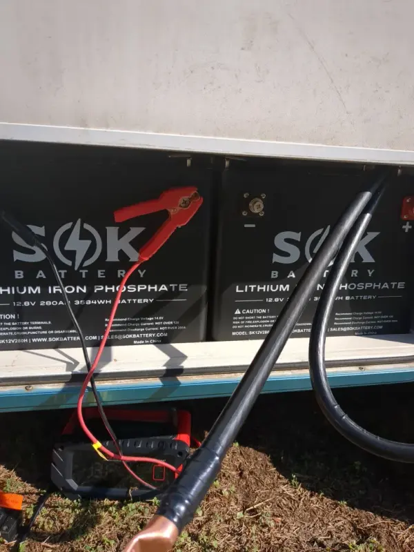

I've currently have the entire system switched over from the existing lead acid coach batteries to these new lithium SOK batters as pictured here.
My current issue
I'm trying to entirely remove the LVD from my system, it doesn't really serve a use for me as far as I can tell as the rest of the AC and DC side of the system has been moved over to the lithium. meaning the lead acid is only doing two things, the engine boost and generator start, I'd like to remove the LVD but retain those two functions for my lead acid (probably looking to replace the old lead acid coach batteries with a smaller battery just dedicated to this function, trickle charge off the lithium batteries)
I'd like remove it but wire power to the coach battery switch so I can still use the boost and generator start as that would be nice. as of right now it sort of beeps because it detects low voltage (the lead acid batteries are pretty shot) and you have to keep a constant charge on them as the prior owner of this Chinook hadn't done anything to really maintain the health of the batteries.
