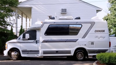

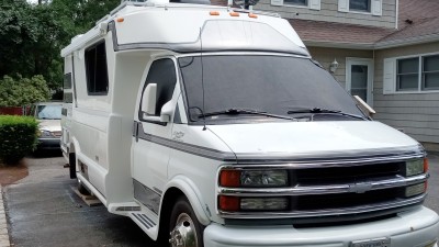

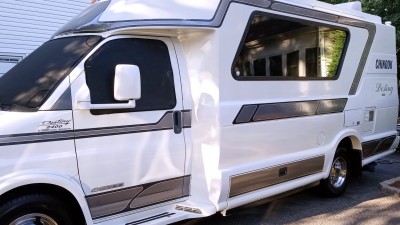

Over the last four or five years, the logo’s and striping on my RV have become unbearable due to the harsh Long Island weather. I tried numerous compounds, polishes, and protectants with some success.
I sought advice from various paint shops, ranging from boat repair to professional auto body shops, but nobody could definitively tell me if my RV's graphics were vinyl decals or painted on. Quotes to repaint the entire RV ranged from $12,000 to $19,000, which was way beyond my budget.
After watching several online videos and asking questions, I decided to take on the challenge myself. I purchased some inexpensive tools from Amazon and started this journey. While I've put a lot of time and effort into my RV over the years, this has been one of the most difficult projects I've taken on.
I'll be posting before and after pictures as I progress. My goal is to save as much money as possible, and I'm also getting new logos that will enhance the overall look of my RV hopefully for the better.
Just for your information the Strips and Logo's are painted on :shock:
Left Side Logo
Left Side Logo
Left Side Logo and Strip
Left Side Logo and Strips
Rear Logo and Strips

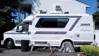

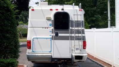

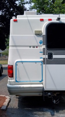

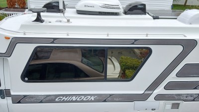

I've begun the process of removing the painted-on striping and logos from my RV. As I mentioned before, it's a lot of work and time-consuming. My motto is "slow and stop," and it's been about two weeks since I started.
I'm not an auto body professional, just someone who watched some YouTube videos. So, it's not perfect, but it's good enough for me. The removal process involves wet sanding with various grits sand paper. Due to my arthritis, I can't use a large professional sander, so I'm using a smaller, lighter-weight air random orbital palm sander. It works well with my 8-gallon air compressor.
After removing the painted logos and stripes, I compound, wax, and buff the areas for a nice shine. When I'm completely finished, I'll spray on a protectant to help repel dirt and grease. This DIY solution is my way of staying within my budget. I would like to also mention I'm only around $200 in on supplies and equipment. One and done, if they last for this job only that would be fine with me. If anyone is interested with the equipment and products I used feel free to post it. And I'll go back and find the links for those products.
NOTE: I'll upload images as I go along.

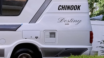

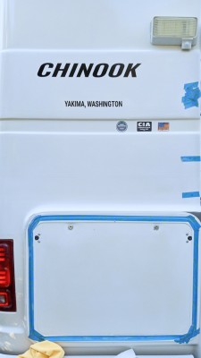

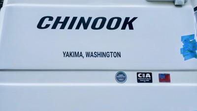

Project update: Today, I received a couple of decals that I had made to see how they would look. This was my first time applying decals to a vehicle, and I quickly realized it’s not as simple as applying a screen protector to your phone :shock:. I should have read the instructions beforehand.
Two issues came up: First, there were air pockets in the vinyl, which I tried to fix, but without much success. Second, I removed the backing from the vinyl too quickly, and some of the letters stuck to the backing, requiring me to place about four letters on manually. The end result didn’t look too bad, but it wasn’t up to my liking.
In hindsight, I made two mistakes: I didn’t measure the width of the original CHINOOK logo correctly, and I should have created two separate decals—one for "CHINOOK" and another for "YAKIMA, WASHINGTON"—instead of one combined piece. However, this is part of the trial-and-error process. I’ve since ordered new decals with the correct size, and fortunately, they were inexpensive at under $20.
I’m sharing this to help others avoid the same mistakes—remember to read the instructions!
Best regards,
NOTE: This is still a work in progress "Slow and Stop" 8-)

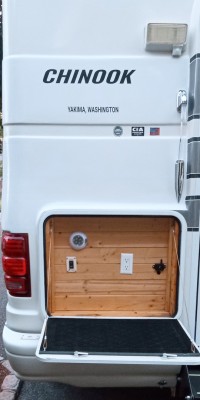

Original Painted on Logo's and Strips
Stips and Logo's replace with new Logo
Replacement Logo without Strips and Handle Reattached
Up-Close Replacement Logo's

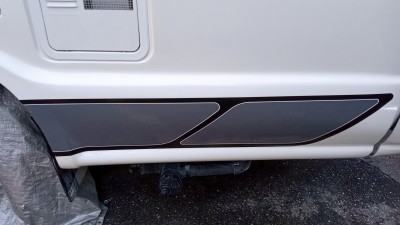

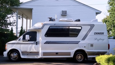

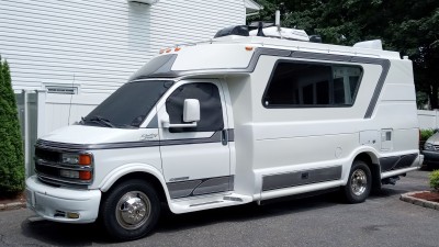

Project update: Today, I received a few more decals for my project. My goal is to give it a more modern look. Instead of wrapping the stripes completely around my rig, I’m opting for a shorter cut. I’m taking it step by step to see how it turns out, and so far, I’m pleased with the results.
I’ll be replacing the top and bottom painted stripes with new ones in a slightly deeper gray, which might be closer to the original color before it faded over the years. I’ve also decided to add logos instead of stripes towards the rear of the vehicle. The great thing is that if I’m not satisfied with the final look, it will be easy to make adjustments.
Best regards,
New Driver Side Vinyl Decal Strip Layout Before Applying
New Logo's Decals
New Logo's Decals

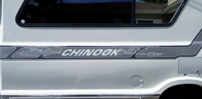

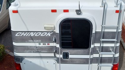

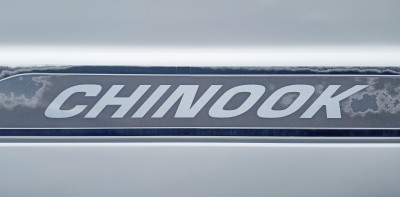

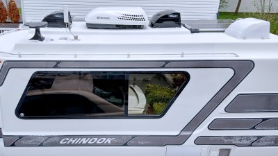

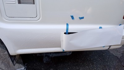

Project update: It's been a few weeks since I restarted this project, and I initially underestimated the time and effort involved. As I always say, my motto is "slow and stop."
I'm almost finished with one side of the RV. It took a while to decide on a look that complements the original design but with a modern twist. I'm waiting on a few more decals to arrive before finishing the passenger and driver sides.
So far, I'm pretty happy with the results. There will be some touch-ups needed once everything is in place, but I prefer to wait until the end to avoid constantly second-guessing myself and getting bogged down in minor details.

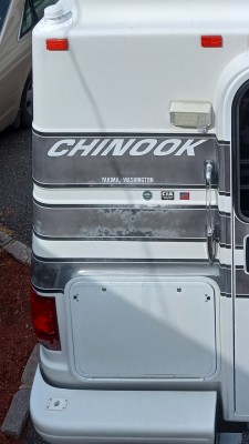

Deteriorated Driver Side Painted Decals and Logo
Restoration Processed Decals and Logo's
Driver Side Rear Lower Decal Replacement Process
