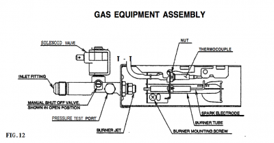

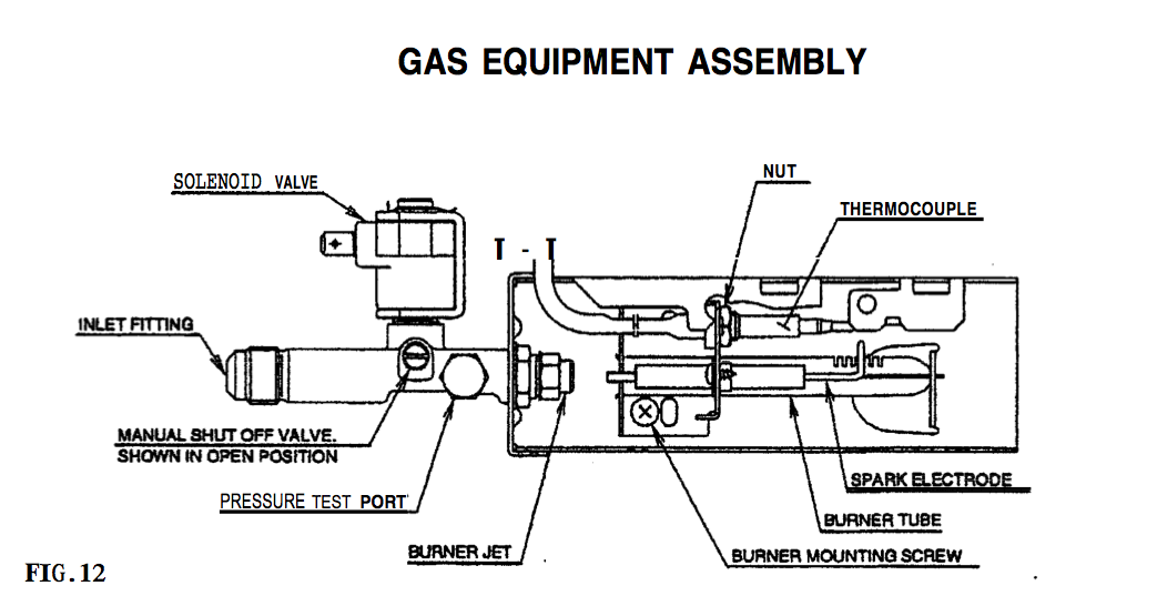

My friend Omar helped me fix the refrigerator. He has a degree in engineering. I followed the Periodic Maintenance steps on page 12 of the Dometic Manual.
I soaked the orfice in acetone. I cleaned the burner tube with acetone and q-tip and canned air. I should have had a stiff pipe cleaner type brush. There was a visible cloud of dust that came out with the first blast of air. There was black soot on the Q-Tips after cleaning the burner tube.
Omar explained the spark electrode. It’s like a spark plug. The spark jumps from the exposed electrode to the burner tube. The gap to the burner tube needs to be just right. He got shocked by touching the Spark Electrode so he was confident it was working. I made sure the Re-Igniter box was working (vertical box to the right of the Dinosaur Board) by disconnecting and reconnecting all the wires to the Spark Electrode.

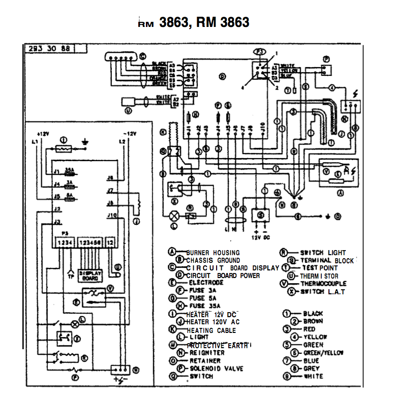

Omar read the wiring diagram and explained it to me, a little. I will ask him to go over it again, and how to read them. The legend list shows in plain english what the components are. They each have a letter in a circle annotating them. Look for the matched letters along with a graphic symbol of the component in the diagram. The wire colors are listed and numbered in a circle in a separate legend.

Tools needed: One phillips head screw driver for 2 screws. 1 for the Burner housing cover. 1 holding the burner tube in place. 3/8” or #10 wrench to remove Burner Orfice, aka Burner Jet. Acetone or some other solvent that burns off. Long handled Q-Tip or stiff wide pipe cleaner type brush would be best. I had regular Q-Tips. Canned air. Paper Towels.
