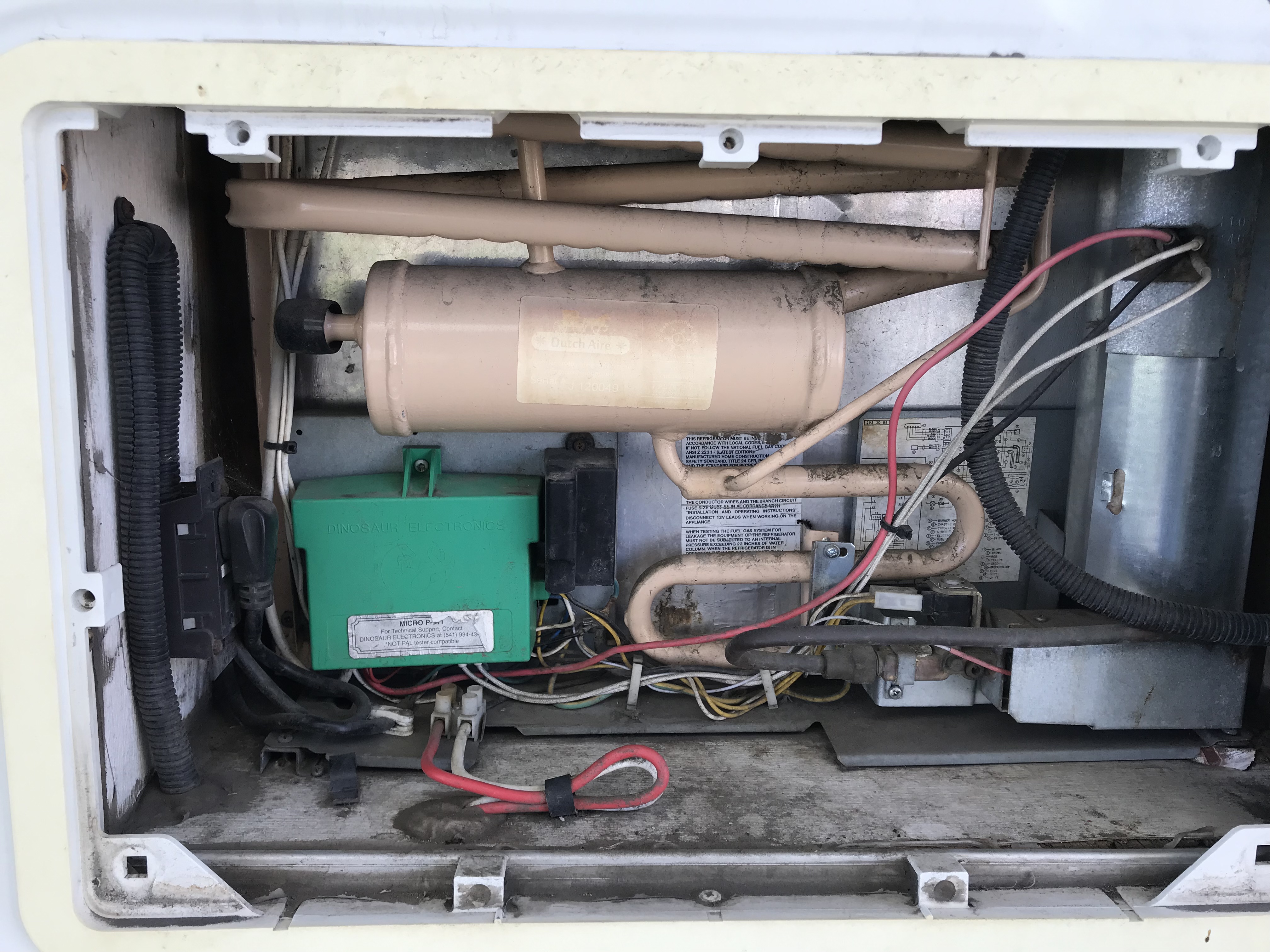

15 Amp parasitic draw when the Refrigerator 20 Amp fuse is in. The parasitic draw only goes away when the fuse is pulled.
What could be causing this based on the tests below?

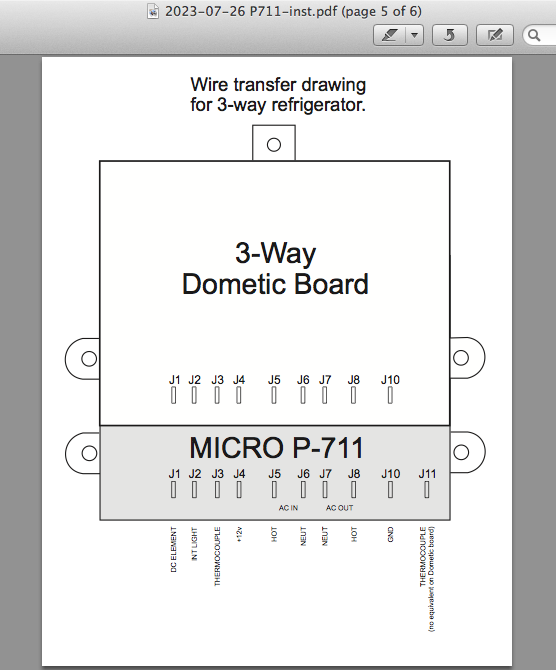

Put the positive terminal on J3 and the negative terminal on J10. It should read about -25 millivolts. If not then it’s probably time to replace the thermocouple.
I did the test and spoke to to Joe again.
-33 millivolts was a good reading. 20 amp charger controller Fuse in. Coach Batteries IN USE.
Joe said the Dinosaur Board will work with -15 millivolts or better. He likes -25 mV but -33 mV is good too.

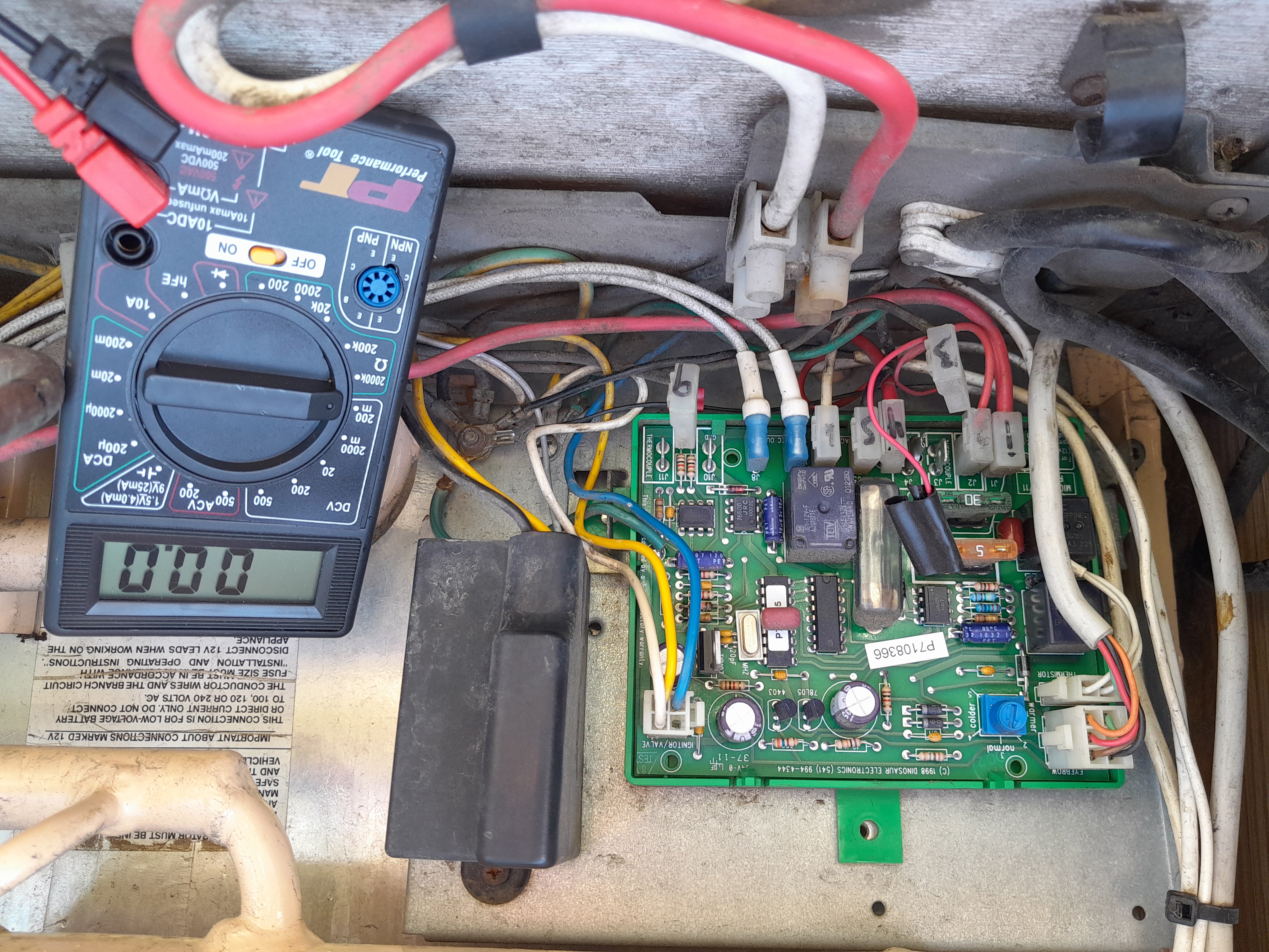

Repeated the test of LARGE AMP DRAW from refrigerator, ISOLATING FOR FRIDGE EYEBROW.
13.2 VOLTS / -00.6 AMPS**** / 99% FULL, Engine OFF, Coach Batteries set to OFF. Charger/Controller Breakers OFF. FRIDGE EYEBROW OFF, 20amp fuse IN.
COACH BATTERIES SET TO ON
13.0 VOLTS / -14.6 AMPS ****
EYEBROW TURNED ON AND SET TO AUTO-GAS but it shuts off after 30 to 60 seconds as expected, due to the problem described by Joe at Dinosaur Electronics. Still a 15.7 AMP DC DRAW even though the EYEBROW is set to Auto-Gas.
20 AMP REFRIGERATOR FUSE IS PULLED and -00.1 AMPS

Bob and Scott,
Thanks for responding. Bob mentions replace the board which seems like an easier first step to make than doing voltage tests and or reconditioning the wiring. I will call Dinosaur Electronics to ask them if it’s defaulting to DC because it’s been blown out.

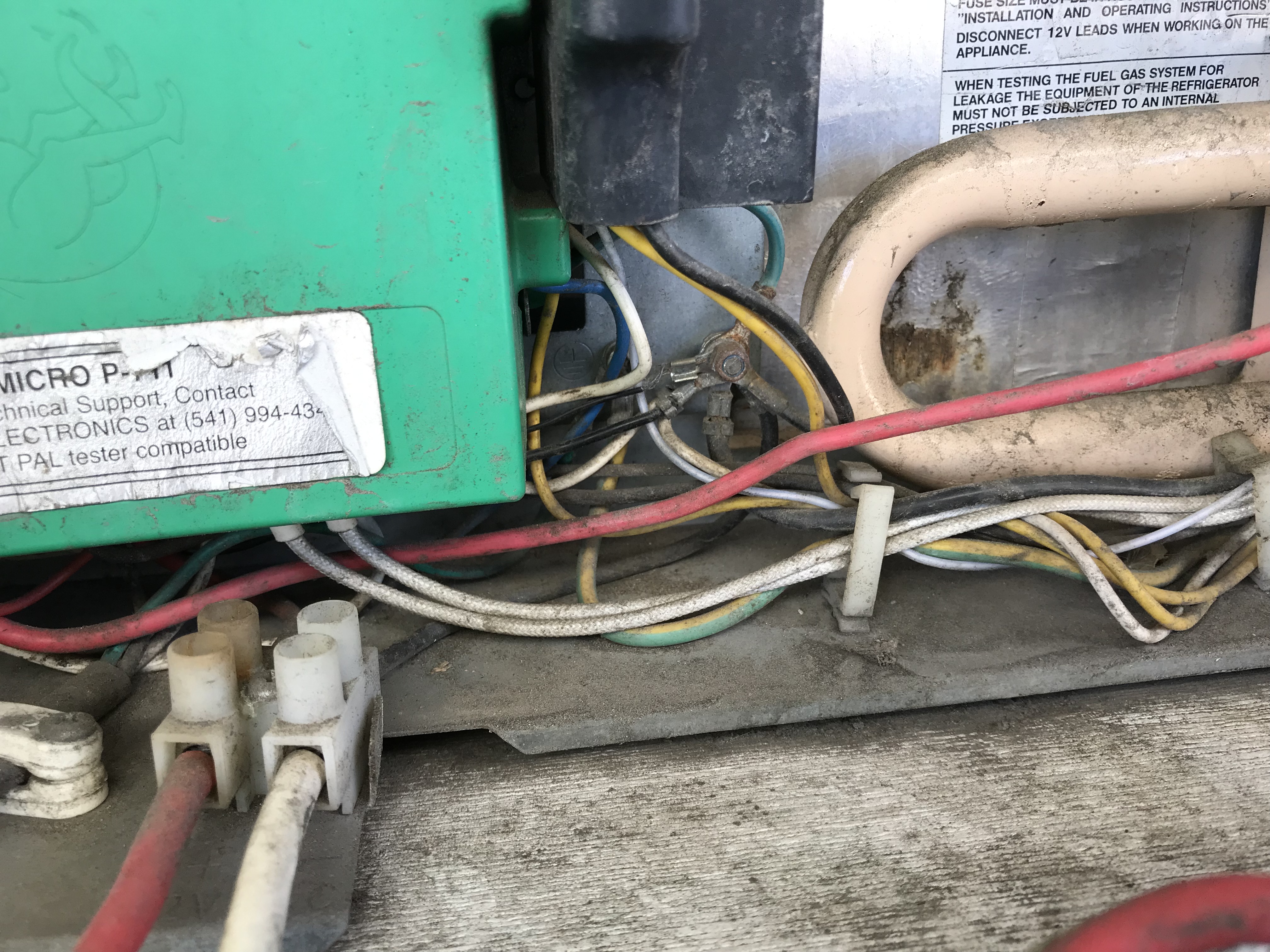

Scott mentions corrosion.Here’s how it looks. I don’t know how to replace wiring, identify black corrosion, or do voltage tests. But I could watch some videos to learn.

Hi Michael,
Looking at your picture, I'd say that ground stud is not so great. There's a wire that is nearly disconnected. And the rest of it is certainly in need of a cleaning. That's a lot of connections for one stud; ideally they'd be on a bus.
Since I don't know what those connections are, I'm not going to say this will solve your problems, but it should be done regardless.

Hi Scott, Glad you mentioned that. I was wondering what to do about it. I’ll research how to clean these connections and create a bus.
Also spoke with Chris at Dinosaur and he said to pull the 30 amp fuse to see if the 15 amp draw goes away. I wonder if replacing the board will fix the problem. That's another question I need to ask him.

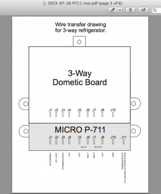

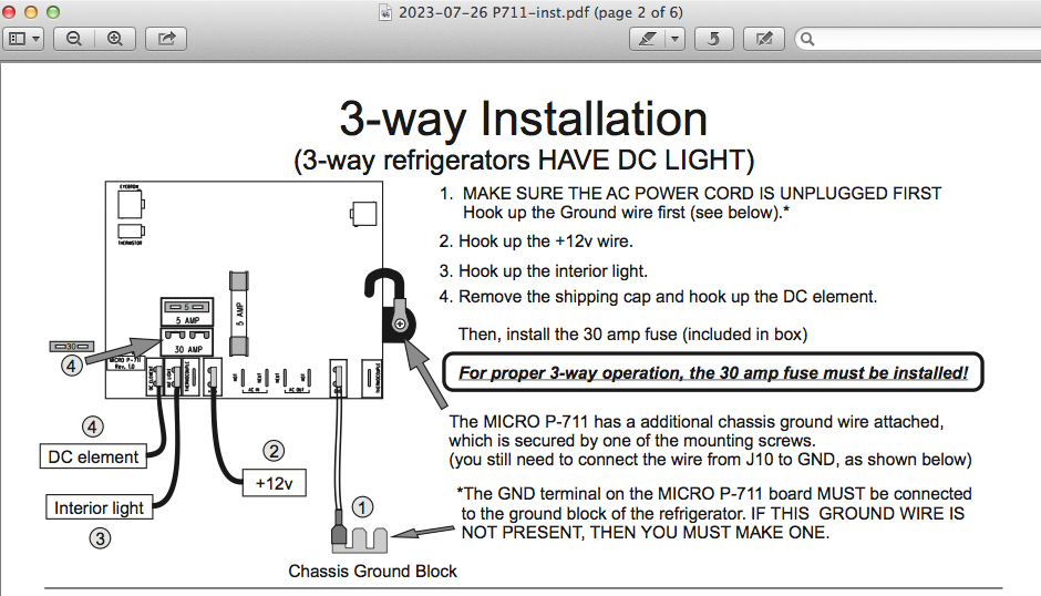

Scott made a very good insight which solved my problem!! Scott assumed that the failed Dinosaur Board P-711 was stuck energizing the DC Heater Element.
So I sought out how to test for this, even though Joe at Dinosaur Electronics said the board’s microprocessor has likely been fried due to plugging into AC while the Coach Batteries are low.
I'm investigating whether the Dinosaur Board is stuck in the ON position of energizing the DC element for the refrigerator. I'm going to try to isolate the circuits by:
1. Disconnecting the DC Element connector on the Dinosaur Board and take a reading using for amps with my Trimetric Battery monitor. I found the P-711 installation manual on their website and identified what all the connections are for. To fix the whole refrigerator problem I simply disconnected the J1 DC Element red wire. The results were that the -15 amp draw went down to the normal -00.4 amp draw. I turned the refrigerator on and it has been working well for 2 hours. So I haven’t bothered doing #2 below.
2. Disconnecting the 30 amp fuse on the Dinosaur Board and take a reading using for amps with my Trimetric Battery monitor.

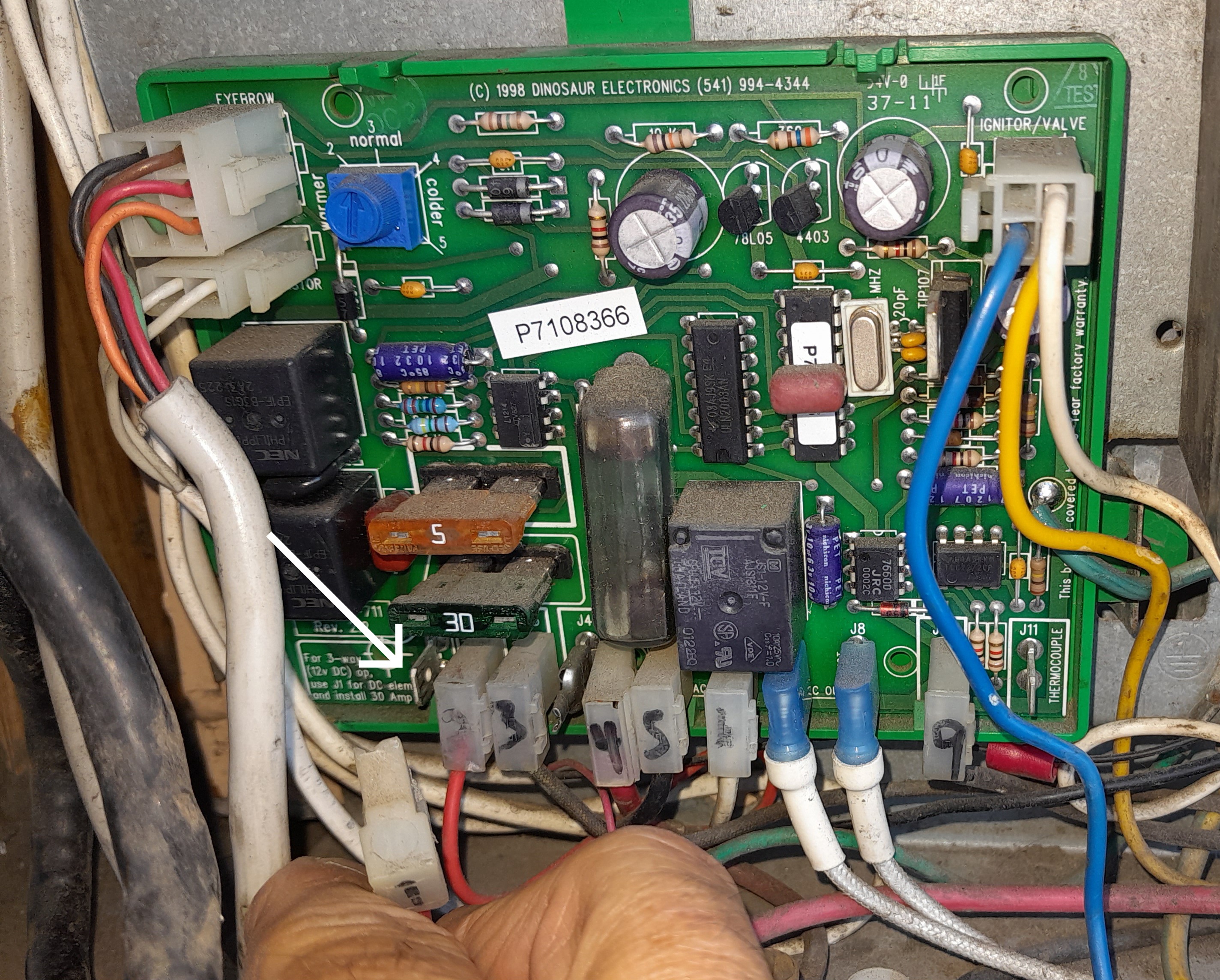

I don't know the board well, so it is just a guess here. It is likely that they use a relay to turn on the power to the DC heating element. With high current draw, sometimes the contacts get welded together, and stays on. You may want to use a ohm meter across the relay to see if it the case for you. If it is the case, you can simply replace the relay.
michael7177
- Posts: 21
- Joined: June 29th, 2020, 12:55 pm
- Contact:
Re: 15 Amp parasitic draw
How do I identify the relay?
I see there is a Panasonic AJS1311F relay on the board, but I think it is for the AC heating element, since the specs says:
10 A 250 V AC (N.O.), 10 A 125 V AC,
6 A 277 V AC, 5 A 30 V DC
6A is too small for the DC heating element.
There are two EP1-B3G1S Kemet relays on the left side of your pics. They maybe the DC relays since the specs I found says:
Coil Voltage: 12 VDC
Relay Contact Form: 1 Form C (SPDT-NO, NC)
Contact Current Rating: 25 A
You should confirm it with the PCB manufacturer (Dinosaur Elec.) and see if they can tell you more than just pure guesses here.
One thing to do before playing with the relays is to unplug the DC heating element and see if the parasitic draw goes away. It should be pretty obvious if it is the one that draw the current, since it get HOT pretty quickly.
You should be able to measure the resistance of the contacts on the relays with the board removed from all the power. Measure the contacts that should be off ("N.O." or Normally Open) when the relay is unpowered, and if it is shorted, then you know the relay probably have welded contacts.
If you have to power up the board, keep in mind that the controller only need 12V DC to run, and you can unplug it from the AC outlet. If you are not familiar with electronic troubleshooting, it maybe better off to get a new controller board instead. I think getting 20+ years out of it is pretty good already.
