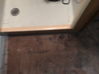

Is there any such thing as "repairing" the subfloor in a Chinook or do I have to gut the whole thing and start over? There's some rotten wood here and there and there is no way I can tear everything out and redo it all.

Some images of the damage would help determine the severity of the problem.

Re: 1998 Concourse - Repairing the subfloor
Posted: June 17th, 2023, 12:27 pm
by LadyBlue
Damage in front of bathroom door.

You can do it here and there if you find the right thickness for the material, but it may not be as strong as original due to the seams and lack of support under the patch. It is really up to you how much you want to fix, but definitely try to get the area in the "high traffic" area fixed (between the sofa and dinette down to the rear door) is most important due to the fact that you can feel it as you walk over the area.
If you do not really want to get too involved, see if you want to lay a new plywood over the existing subfloor (and lost a fraction of an inch in height) and cover up the area. It is still going to be a lot of work since it will be very noticeable if not done well around the cabinet and shelving. Good luck.
