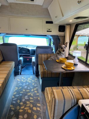

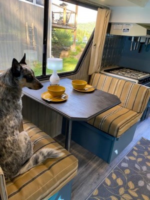

Hi all my wife and I accuired a 1995 Concourse in November from NC proceeded to drive it back to VT and gut and redo the interior. We removed all the carpet for beadboard walls and wood flooring adding insulation to both as we went. Widened the asile between the couch and dinete by 19" so could get by the dogs laying on the floor and added a spanning board under the couch to cover the aisle and give us a King bed insted of the 2 smaller than twins that were original. Removed the micro and TV for more storage. All new LED lighting (except the one over the back door that I somehow forgot...) and a track curtain to seperate the cab and coach areas. Here are a few photos
Next up
12v fridge to replace the leaking 3way
updated solar and batteries
Kyak carrier....if anyone has experience with this please let me know.

I really like what you did with the interior remodel. Creating the wider isle looks really nice. And better flooring and insulation to boot! We did same with the micro—More Storage! Yea.

Durring the remodel we fixed the screens that were just laying behind the seats. I don't see how the hold to the windows. There must be clips of some kind. Do you know what they look like or where I might get some?

Hi all, well we had a good summer traveling with the Chinook, decided to keep it but wnated to make some changes. We removed the AC and generator (didnt use it once last summer). Opened up the original AC roof penetration and installed a skylight. With the generator gone we have some much needed storage space and lost a bit of weight. We also removed the 3 way fridge and went with a smaller Recpro 12vdc 4.3 cuft model. We added 200W of solar and 3 100 ah deep cycle battteries. We now have some parts that are available if anyone is in need of a working AC unit, generator or parts from the fridge. The fridge has an amonia leak but the rest is good and I had just installed a new dinosaur board before the leak happened. Looking forward to hitting the road again this summer with a trip planned to PEI and maybe one to the allagheny mtns. If any one is interested in any of these parts let me know

Your latest improvements sound wonderfully useful—more solar and battery capacity always a plus. And skylight! Nice. We also swapped out the generator for more storage—really makes taking longer trips easier. That compartment is perfect for outdoor stuff like charcoal grill and my wife’s fly fishing boots and waders.
