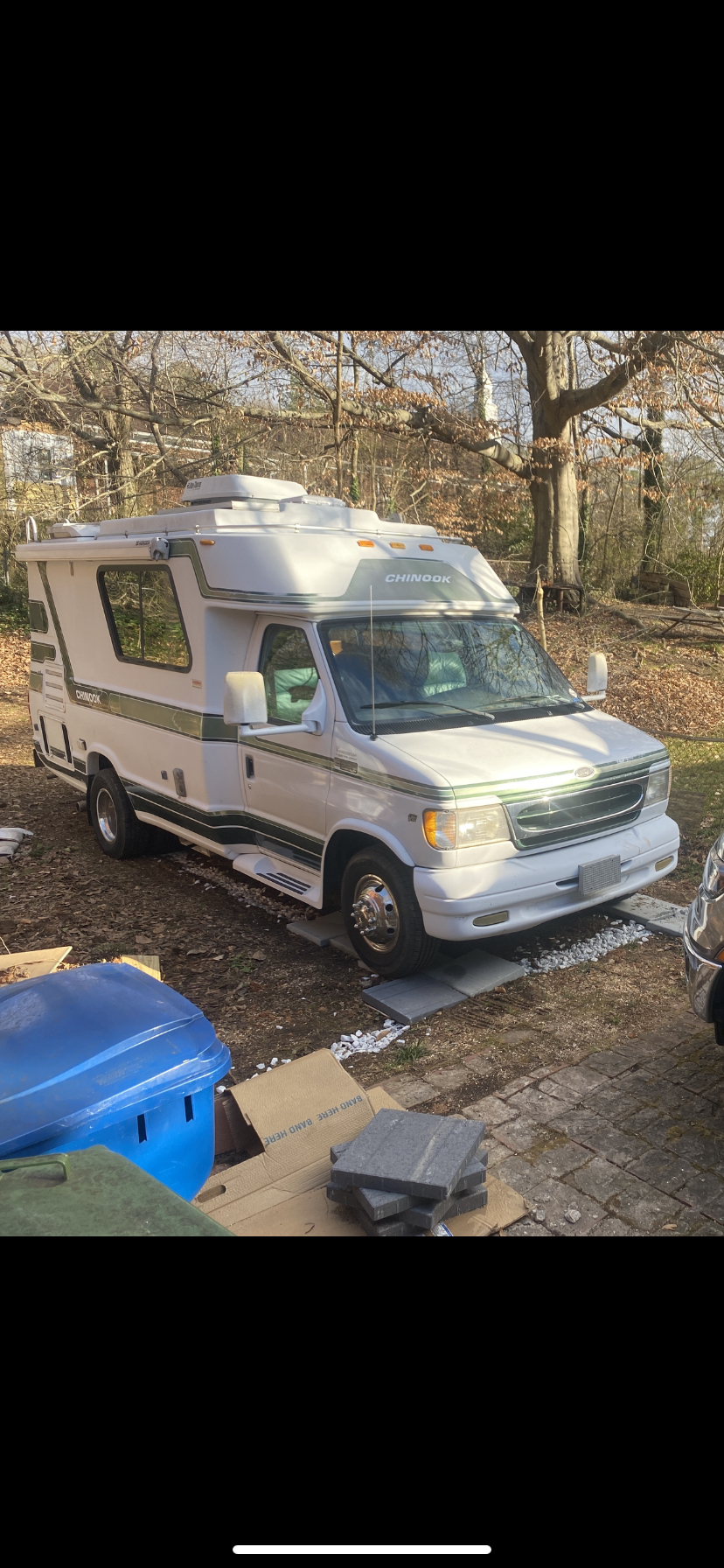

Hello everyone! I have been stalking this forum for a while and finally made an account.
I acquired my 2000 Chinook in Feb this year and I love it! It's my first RV of any sort, ever. Other than having to fix the three way fridge once and the cruise control, everything seems to be working great (the solar panel and/or charger definitely could be updated).
It does seem to vibrate more than I would expect, mainly at speed above 60MPH. It's not REALLY bad, but just enough to be moderately annoying. I did get new tires put on as soon as I got it (thought this would fix it). Still no luck. Had them rebalanced and remounted. No change. Had the tire shop swap them out for a better tire (now TOYO Open Country). Rides a little better, but vibration is still there.
I've seen Blue~Go on here a lot and noticed they had the same problem (from a 2015 thread viewtopic.php?t=163)
If you happen to see this, did you ever figure it out? I'm considering a driveline shop next. I have NOT had it aligned, but I also have little faith this will solve the issue.
Has anyone out there experienced this or resolved it? I can see the passenger seat vibration as I drive along. Doesn't really feel specific to front or rear.
Thanks in advance,
I'm looking forward to joining this community and sharing my future experiences. Hopefully I can help someone else in the future.
