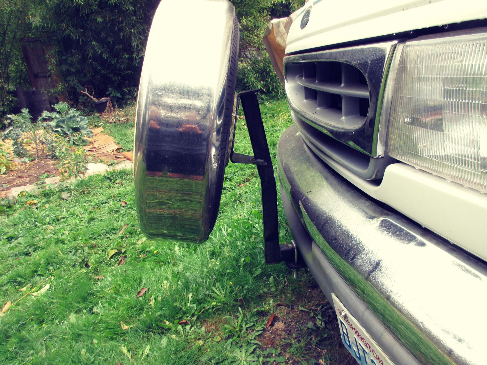

My spare tire mount is on a shelf in the barn because I installed a front trailer hitch and a hitch mounted spare carrier.
I read about this mod here per Mr. Blue. The new weight distribution might be beneficial. I have not experienced any diminished engine cooling.
Roly
Roly

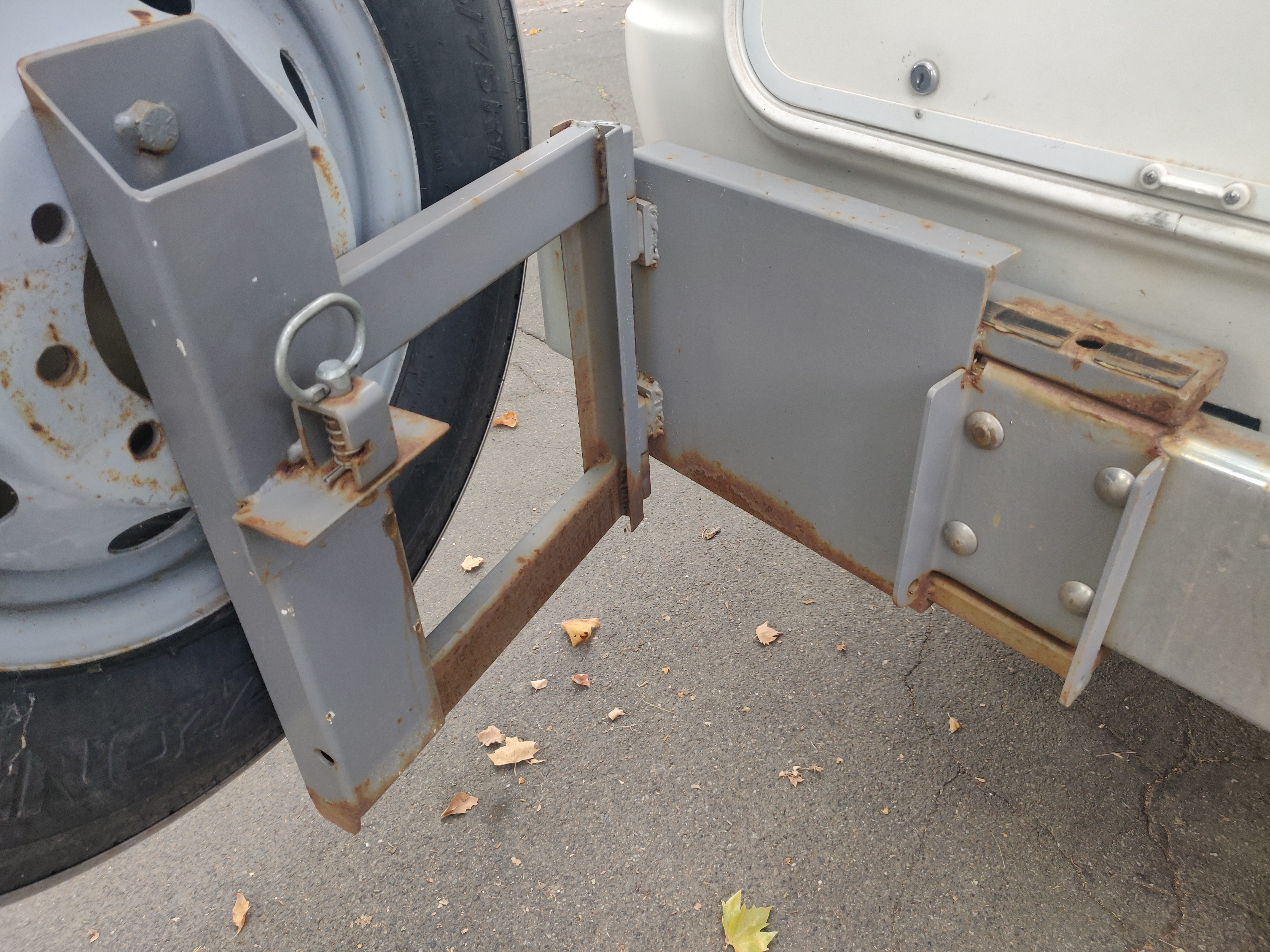

One of the claw sides broke off mine. I took it to a welder and he did it for $30. Feels and looks strong. Had to paint it to prevent rust.
The only problem I see is the pair of rubber straps that can tear.

I bought a welder from Amazon just to make this happen!
Re: Help Needed: Spare Tire Mount Bracket
Nice job! That's a lot smarter than the original. Way to salvage materials, too.
