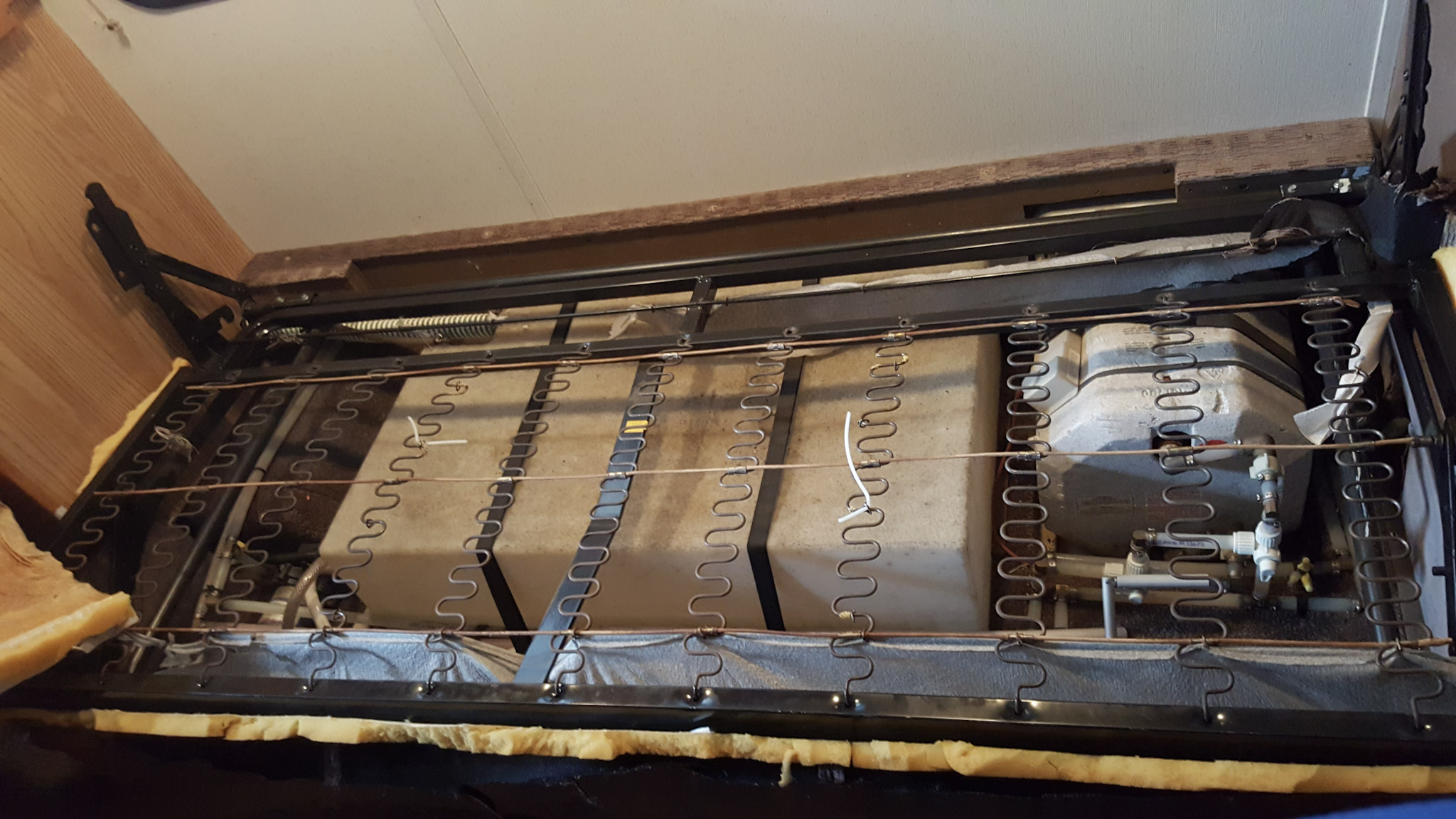

The back cushion is attached to a back frame thingy, which I just poked at with wrenches until I got the whole frame off. You can see in the photo below an arm thingy sticking up at either end. I never did figure out the 'right' way to remove those. I ended up just cutting them away using a reciprocating saw.
The bottom cushion might have been screwed on, at least in part? But the part I remember was cutting away the foam where it had been glued to the frame.

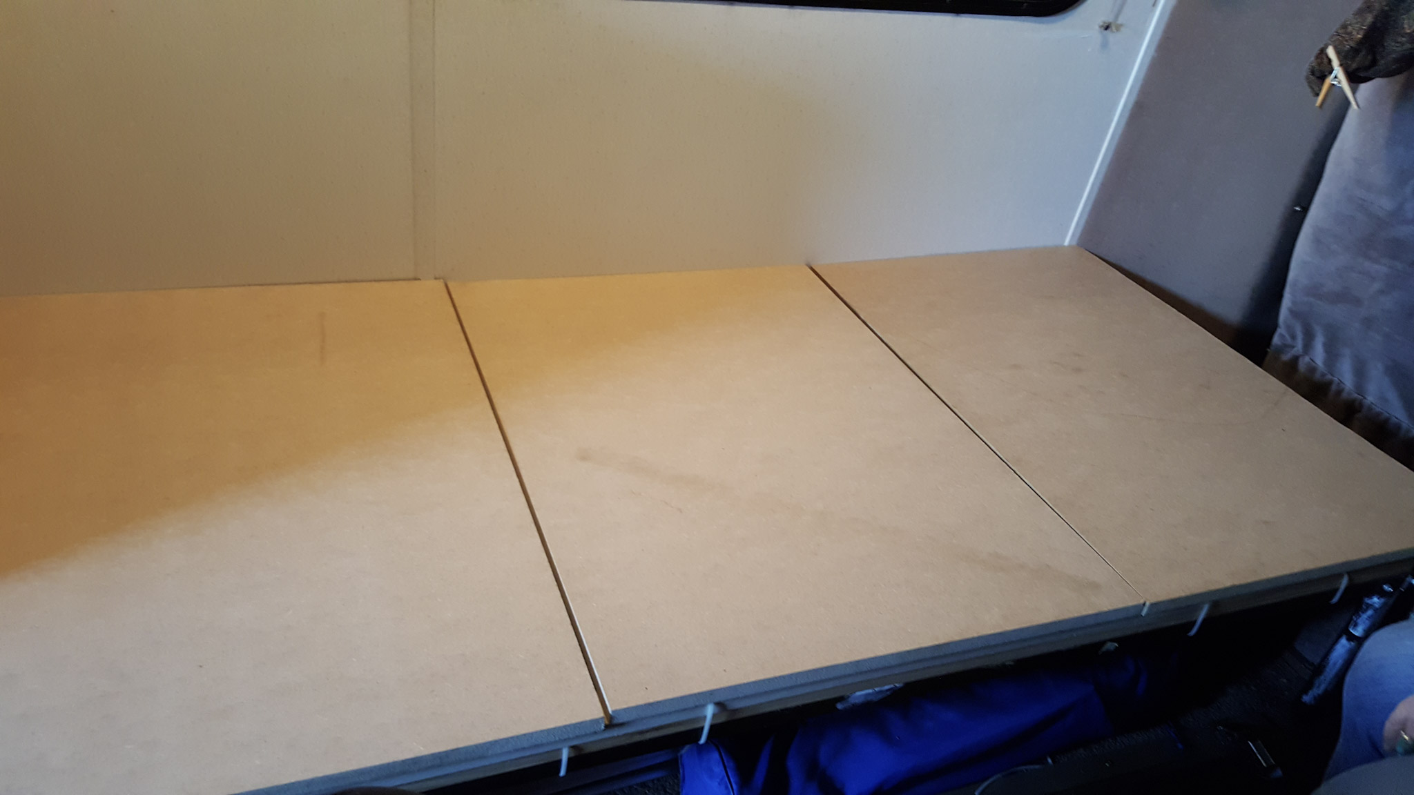

Then I cut some boards to fit over the whole thing, from that wooden rail on the wall to the front edge of the steel frame. I think I might have had to add a shim for leveling somewhere in there, but I can't actually remember and my notes are non-existent.
I did end up needing to top the boards with that non-skid stuff you put under rugs to keep the mattress from inching out into the walkway.

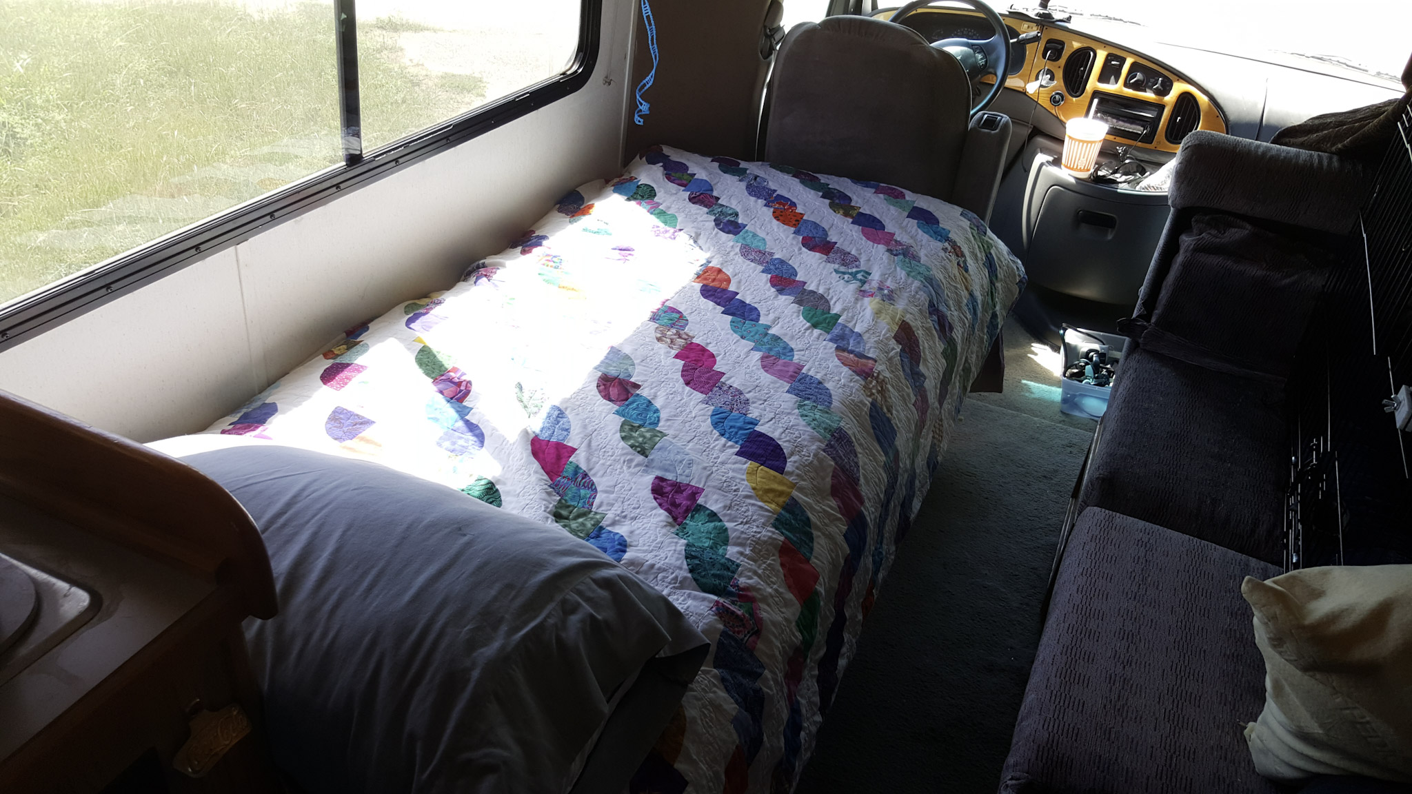

This was the end result (before I took the dinette out!)
