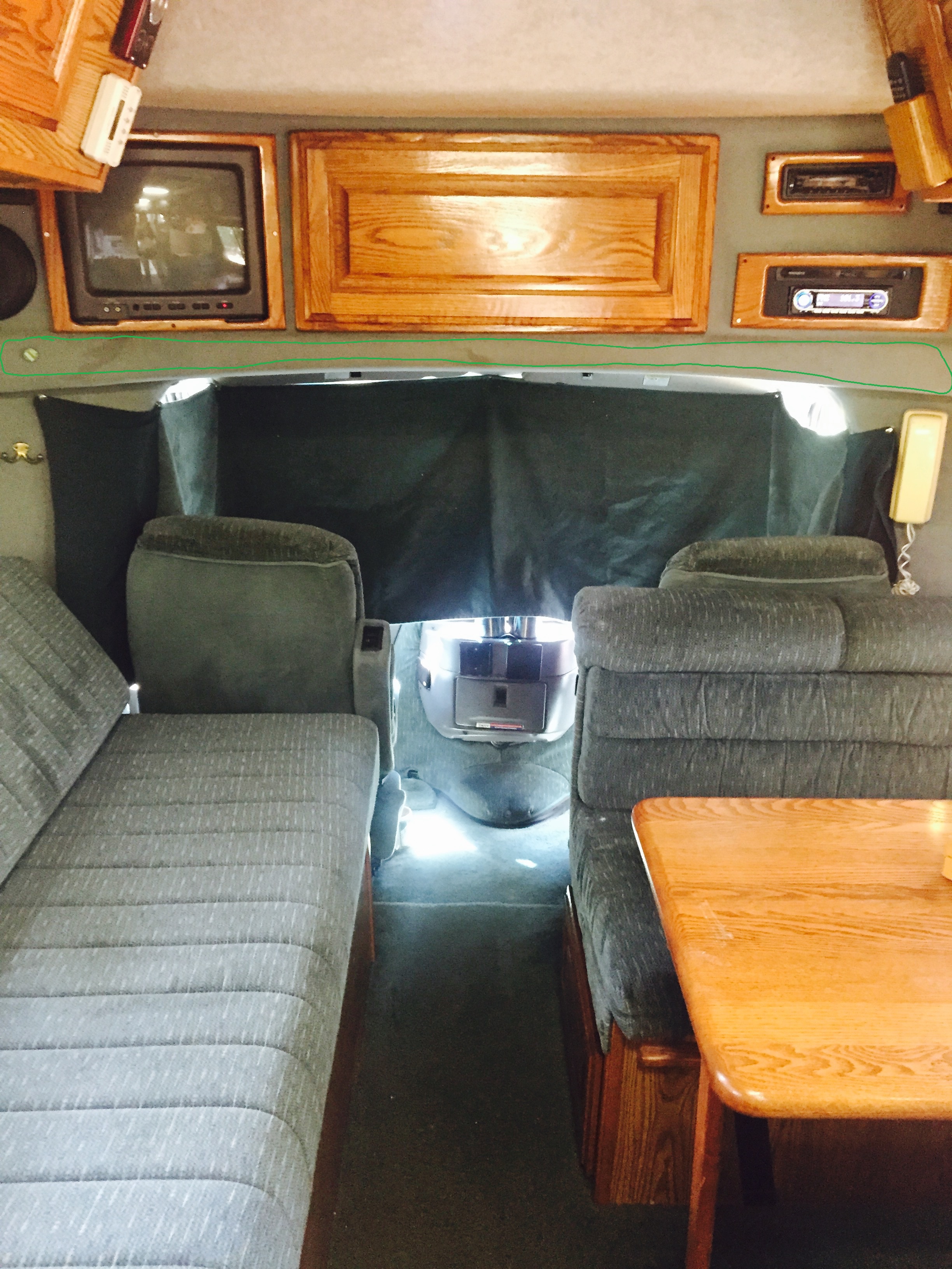

I want to put some sliding, heavier duty curtains across the entry between the front seats and the living area. This means I want to attach a curtain track.
If I could just screw straight in to the upholstered entryway arc, it'd be an easy-peasy mod (aside from finding the right HW and making curtains), but I have NO idea what's behind the upholstery there. I've seen posts here of folks adding curtains there with different mounting systems, but I have no idea how I'd actually affix to the archway. Last thing I want to do is make a leaky hole in the fiberglass that I can't get to without removing the whole cabin from the chassis... (the specific place is circled in green in the pic, kinda hard to see, I should have used a different color)

Duh, I missed that green circle on first look! So if you are screwing into that face, you will be going through just the thinnish fiberglass of the overcab piece (totally separate from the outside Chinook shell), then air, then possibly the thin downturned Ford steel flange at the aft end of the overcab (if screwing horizontally this does not connect to the outdoors in any way; it's just a single layer steel flange). Or if higher up on that bulge you could catch the edge of the 3/4" plywood overcab piece. On my Chinook there were no wires in that area, btw, except for way over on the sides where the pillars are, and then they were way forward (they go into the headliner). You would have to use very long screws to hit them (inches). In your photo that overcab piece, and even the arrangement of the various doors and TV etc. look just like mine (early 1999). I even had the same telephone "It's for you!"

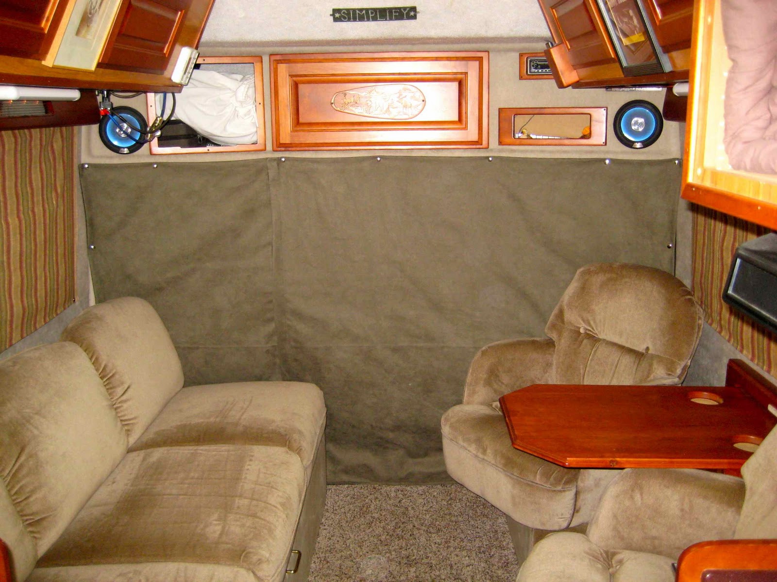

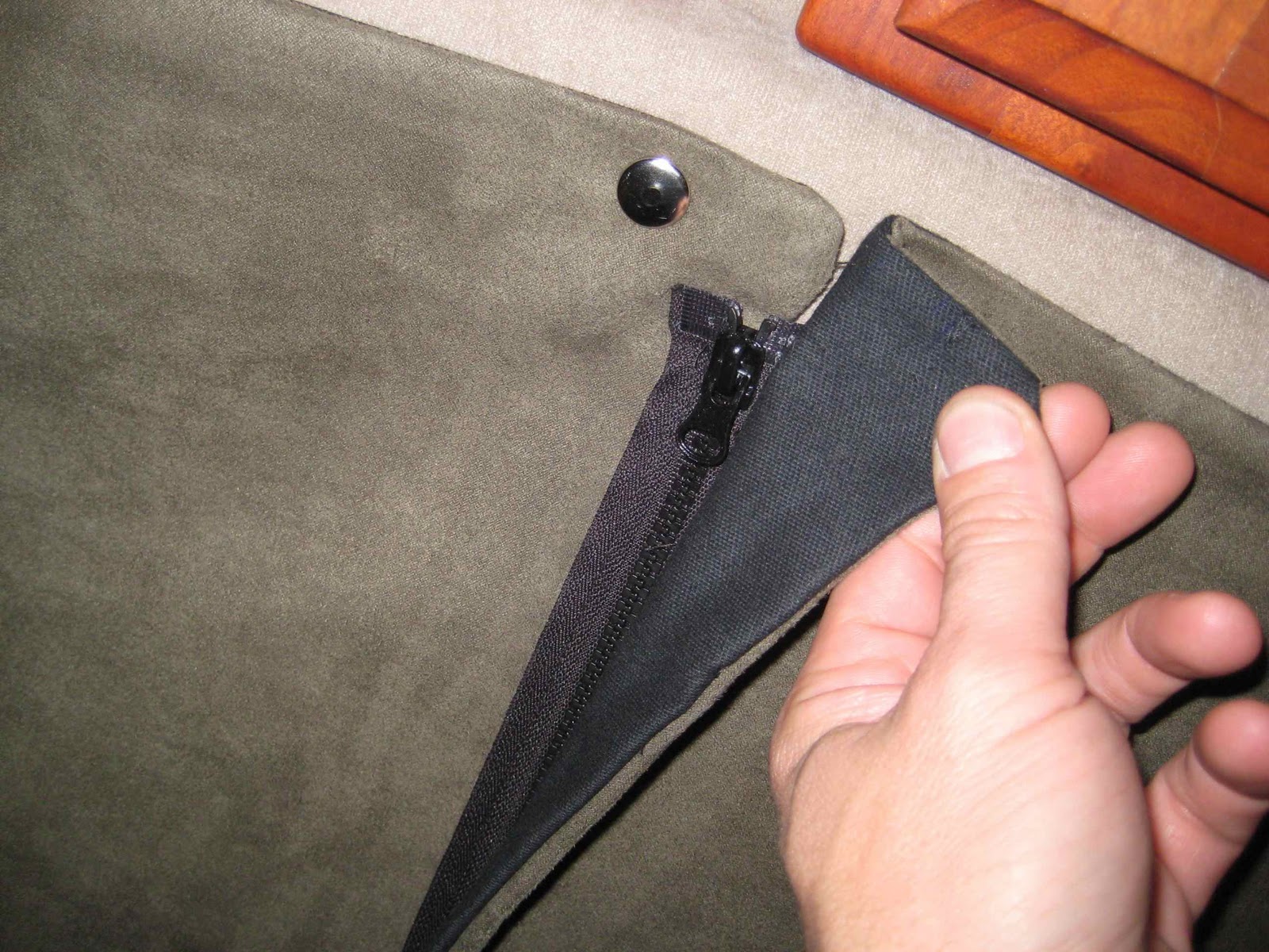

Just came back to add a couple of photos I had saved of a cab curtain Glenn (former Chinook owner) made. I thought this was a really nice job (and fastened in your circled area, looks like with ~1/2" to 3/4" snap studs). In case it's not obvious, there was a more "permanent" piece behind the driver's seat, and then a vertical zipper to the rest of it which is the section that was more typically opened (though all sections could be). I believe he just un-snapped the right side and folded and stowed it during the day (there were no tracks, just panels snapped on).
You would have to un-snap and stow the section(s) you wanted open during the day, but then to the good you wouldn't have curtain bunches to the sides like you would with sliding curtains. (Not that I have anything against sliding curtains - I added them to both side windows instead of the stock blinds, but in that case it's easy to have them slide to the sides of the window and just sit there in front of the flat wall section.)

Also, what mine actually looks like is exactly like Glenn's there, though it has a TV and microwave. The pic I uploaded was unfortunately just one I pulled off the web because it was quicker than taking a pic and getting it on to my computer... So I unfortunately have that uncomfortable 3 section sofa. It doesnt seem bad so far, but I haven't gotten this thing ready for any overnights yet.

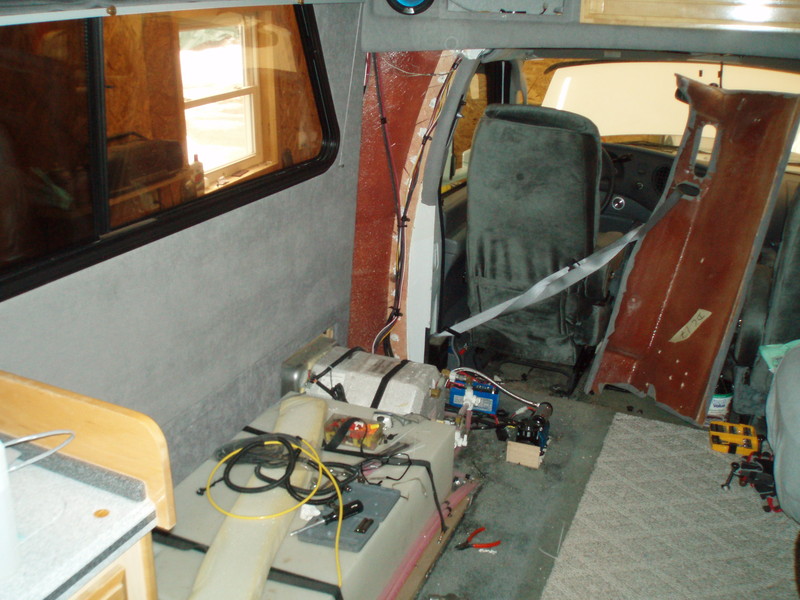

The sides are just the same as the top - the pillar on each side that the snaps are added to are the pillar I was talking about, a molded fiberglass panel. Just drill the hole and screw in the snap.
Actually, those panels can even be removed, as there is a bundle or two of wires behind them, running floor to ceiling. Here is a picture someone posted a while back, with the panel on the driver side removed (you can see the panel on the right of the photo, with the seat belt going through it). Note that the wires might not be in the same position as shown, as the bundles in mine were in the middle and on the right. Just use short screws and you should be okay, the panels are not fitted tightly (they probably have an inch of space between them and the wall). Make sure the drill bit doesn't go too deep when it breaks through the fiberglass as you drill (so as not to puncture any wires in case you have the bad luck to be right where they travel, though I don't think that's too likely).
