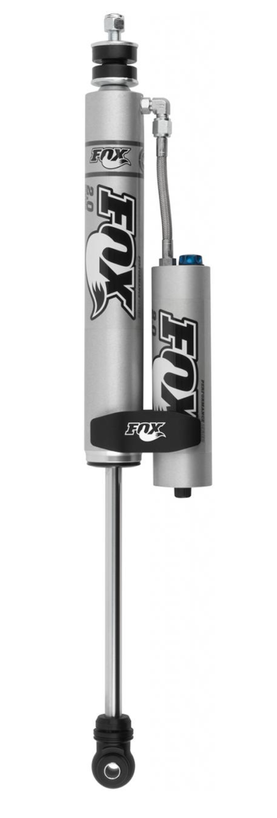

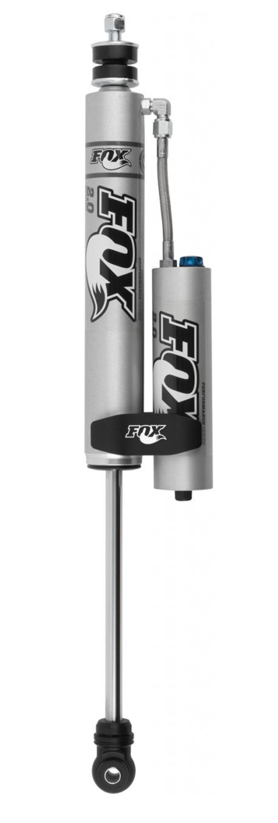

I already picked out the Fox shocks i plan to install on it this time, but they are $429 dollars each for the fronts. Thats primarily because they have that extra little reservoir and are adjustable in terms of compression rate, which should allow me to fine tune the things for this truck. Fox part #: 985-26-121. Not that i want to spend that kind of money on a pair of shocks, but i actually need that added ability to fine tune the compression rate on this truck. It depresses me to think i have to spend $900 bucks on a pair of shocks, then of course i will have to have a match pair for the rear eventually. I just spent way to much money on this trucks suspension not to have it dialed in absolutely perfect, and i hate feeling like im riding a pogo stick when im doing 40 mph and go over one of those low valley's at some of the intersections around here.

The Fox shocks i have picked out are for running the taller spring perch in front so just figure 16 1/2" and 42" inches.
If i leave the current spring perches in front i will have to run a shorter shock. The Fox shock specs are as follows...
Extended - 24.37"
Compressed - 14.75"
Travel - 9.62"
Extended - 24.37"
Compressed - 14.75"
Travel - 9.62"
