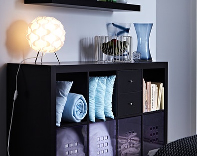

It's nice that the Chinook has so many overhead lights, but I also wanted a lamp. A 12-volt lamp with an LED bulb. I decided to "hack" an IKEA Fillsta table lamp. IKEA sells a variety of bulbs for this lamp, including LED, but they are all 110 volt. Here is the lamp as shown in an IKEA room (not my Concourse :? ). It also comes in orange.
