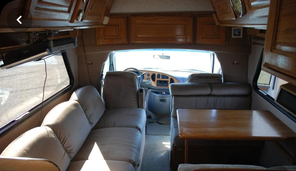

Is there a Specialty Concepts solar controller behind the passenger seat?
viewtopic.php?f=6&t=435

Can you post a picture of the passenger side area just like this one?
(I got that off an active ebay auction)
The thing above the round speaker is the solar controller.
I thiink solar is optional for some years, but in order for the panel to work, you need to have a controller, otherwise, the battery will not last long.

We only have cabinet doors - the white thing on the right side in the photo is a picture.
Re: Solar panel controller
I guess it was not ordered with the XL package, or whatever that the stereo and solar controller are bundled with. At any rate, I have a silly question. Do you have a solar panel on the top? If you do, then you will need to trace the wiring down to the battery. For most Concourse XL, there is a opening that goes to the inside corner of the overhead cabin area where the solar controller is. (Or in our case, where the white picture frame is.) It then goes across the cab area and down the driver side pillar and under the chassis.
