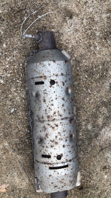

I almost caught the guy (need to run faster) that was trying to steal the Catalytic converter off my 2004 concourse.
I posted these details on FB, but wanted to share here (Story below), and discuss further options to protect these from being stolen off our Chinooks.
It was in my driveway (in back of my house) at 10:22 in the morning. I was in the kitchen cooking, and they were within less than an inch of stealing it.
After I chased one thief, the other drove down the block and picked him up (I was was van length away). I wasn't sure what was going on, and I looked under my Chinook to find the Exhaust behind the Cat completely severed, and the exhaust in front of the cat 99% (I lifted the Catalytic converter twice and it separated completely).
There is currently a large number of Catalytic converters being stolen from large Ford Trucks, Toyota Trucks, and Honda Civics/elements (I don't understand the Honda cars because they would be difficult to get under). I was the second person to go into the muffler shop around 3pm, but I had my Catalytic converter which they were able to weld back in-line with the exhaust ($100 for the weld,$58 for a new O2 Sensor). The other person's exhaust was completely stolen. I was told the high price of rare/precious metals used in Catalytic converters is making them desirable targets (5 minutes of work) for theft and to be sold on on the black market. Our large exhausts make them even more attractive.

Which has a collar in front and behind the catalytic converter, and several cables running fore-and-aft of the CAT, making it difficult to use a reciprocating saw (what the thief had to cut into my exhaust)/sawzall to cut the stainless steel tube.
It was also suggested to me by my muffler shop that they have installed on several fleet vehicles (a plumber that had 3 trucks) where they can weld re-bar over the catalytic converter, and far enough back on the exhaust. This just adds more items, or surface area to cut through, but I think this would be quieter than the next option that they could install. The could weld several length of chain fore-aft of the catalytic converter. The theory behind this is a loose chain (or cable) will move if attempts to use a reciprocating saw to cut.
One good thing seems to be that I had previously recognized a sound originating from under my Chinook (a rattle while running) that is no longer there now that they again welded the Catalytic converter back to the Exhaust. I had believed it was probably the heat shield (or something).
