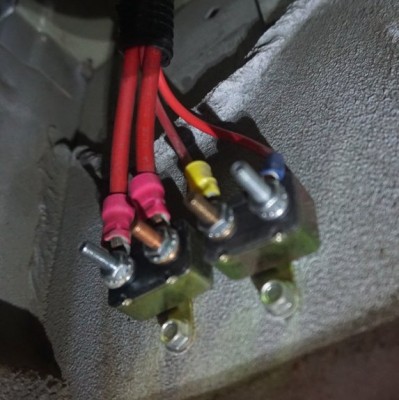

I should tell you that the rodent chewed the Sense wire inside the white box under the chassis. See photo below. I had anticipated that the problem might be one of the auto-reset breakers, so I bought replacements. But when I removed the box, viola, there was my problem. So, I gave the RV tech the new breakers and asked him to replace the old ones. I did mention that he should connect the wires to the correct breakers because there was a 50 Amp and a 15 Amp breaker. He said that doesn't matter! I should have said something then - I am not an electrician, I am an IT guy, but I do know that the larger the wire the more amps the wire can carry. Ok, he reconnected the broken wire and did connect the new breakers - see the next photo. Looks good, except, see the following photo - the Sense wire is connected to the 50Amp breaker and the larger battery wire to the 15Amp breaker! I had to go in and reverse the connection - see the last photo. I didn't rearrange the breakers, I just crossed the wires making sure the correct wire went to the brass fitting. I hope that's ok?

I will be careful with this tech in the future. Why not make both 50 A if it doesn't matter? :roll: The 50A is needed due to the load of the DC appliance. The wiring allows for 50 A, so that is what Chinook used. The sense wire has much lower current demand, and the 15A (and the smaller wire) does not allow the use of 50A breaker.

For sure I won’t be going back to that RV Repair shop. I was dumb founded and speechless when he said that! I now know why most of the Chinook owners on this Forum, including yourself, do their own repair/replace/work!
