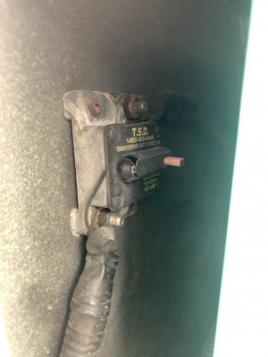

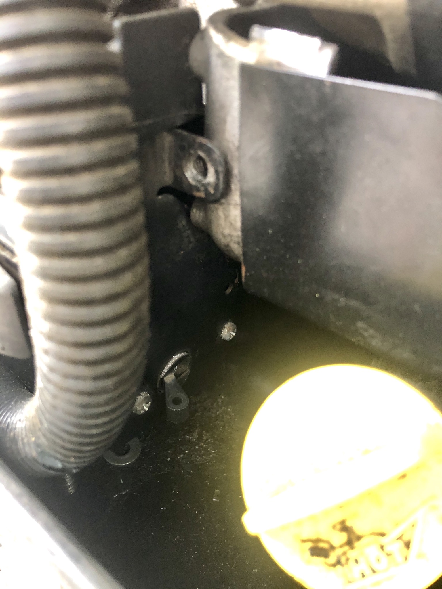

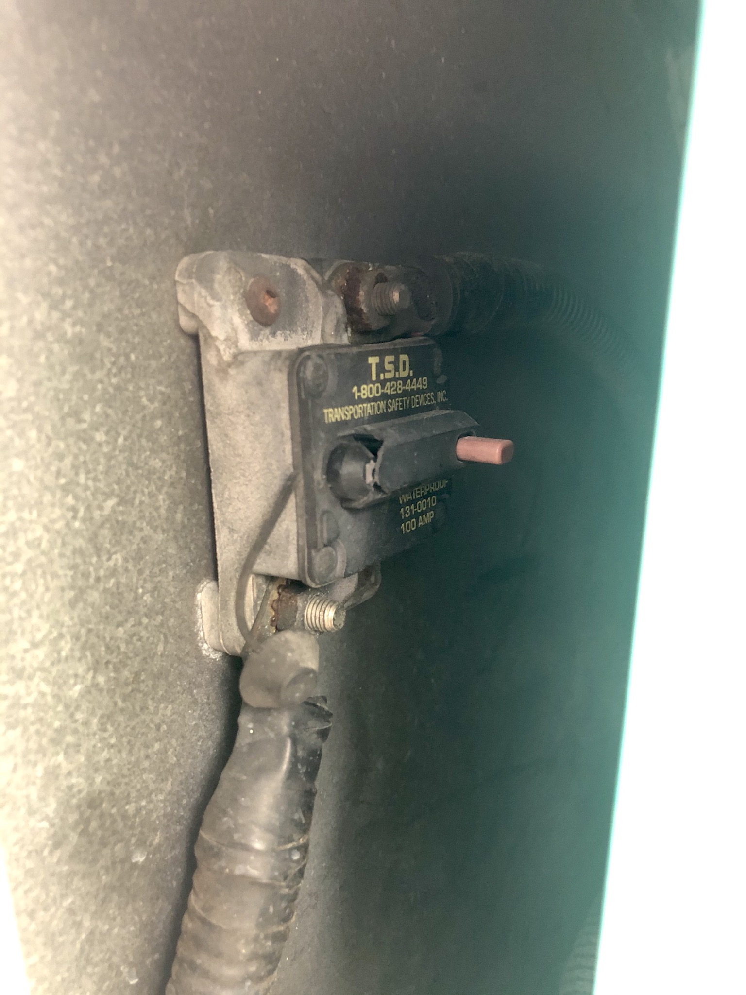

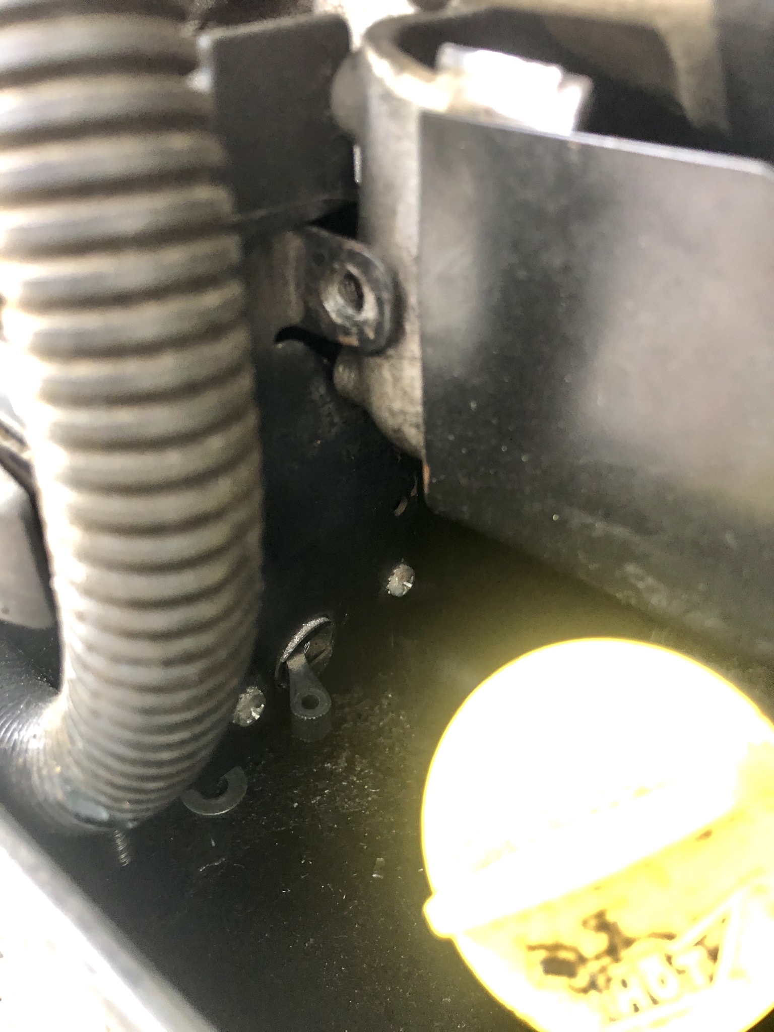

Have you checked breaker switch on side of generator, it is easy to bump to off position? Just checked my onan 4.0 breaker is located between start switch and oil fill cap, is hard to see it without a light. Sets a little lower than cap and switch. Ouch,just reread your post, see you have checked switch. Have you checked with meter to see if you have 110 coming from generator?

I check both of this, first pic is outside the generator but inside the generator compartment. Second pic is the on/off breaker switch inside the generatorJlfchinook wrote: August 22nd, 2020, 4:33 am Have you checked breaker switch on side of generator, it is easy to bump to off position? Just checked my onan 4.0 breaker is located between start switch and oil fill cap, is hard to see it without a light. Sets a little lower than cap and switch. Ouch,just reread your post, see you have checked switch. Have you checked with meter to see if you have 110 coming from generator?
