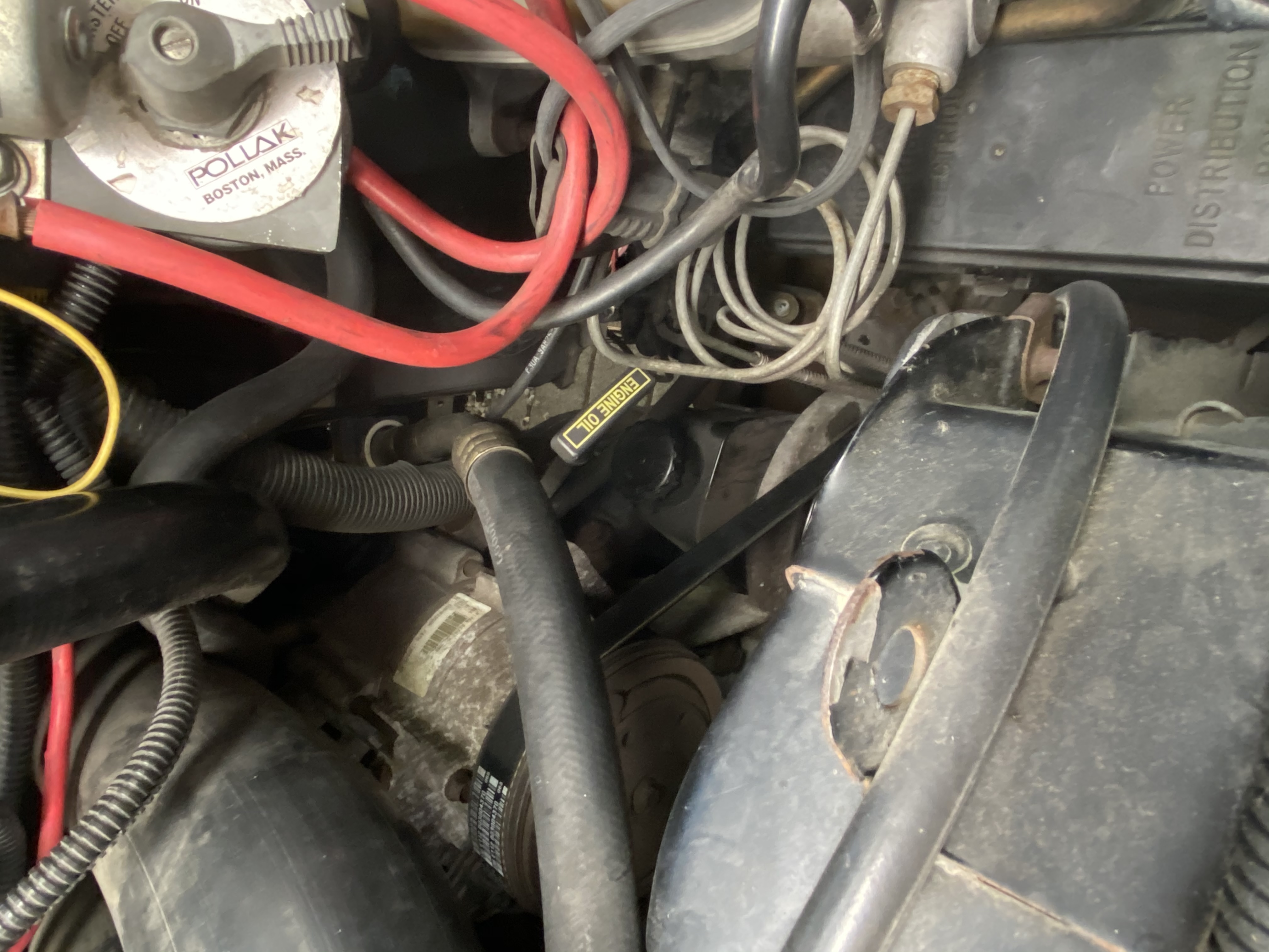

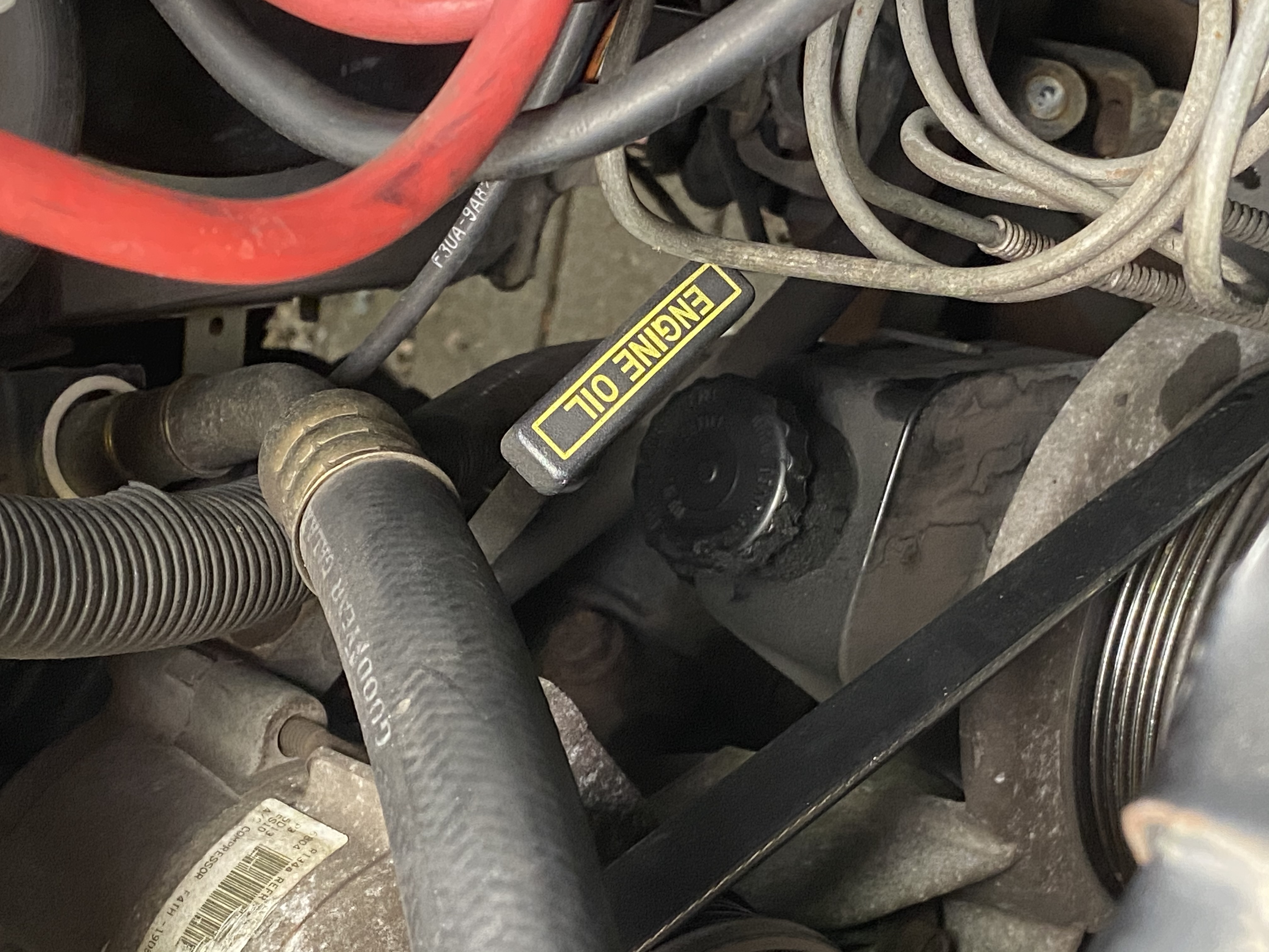

I just wanna double check that this is my power steering reservoir. This is a 1995 concourse with a 7.5 L engine

Yes, unscrew cap, it has a dip stick attached to it.

Great! Thank you. I got a little nervous adding fluid without being 100% sure.

Check it with it running. It won't hold much so read the dip stick carefully.
Re: Is this my power steering reservoir?

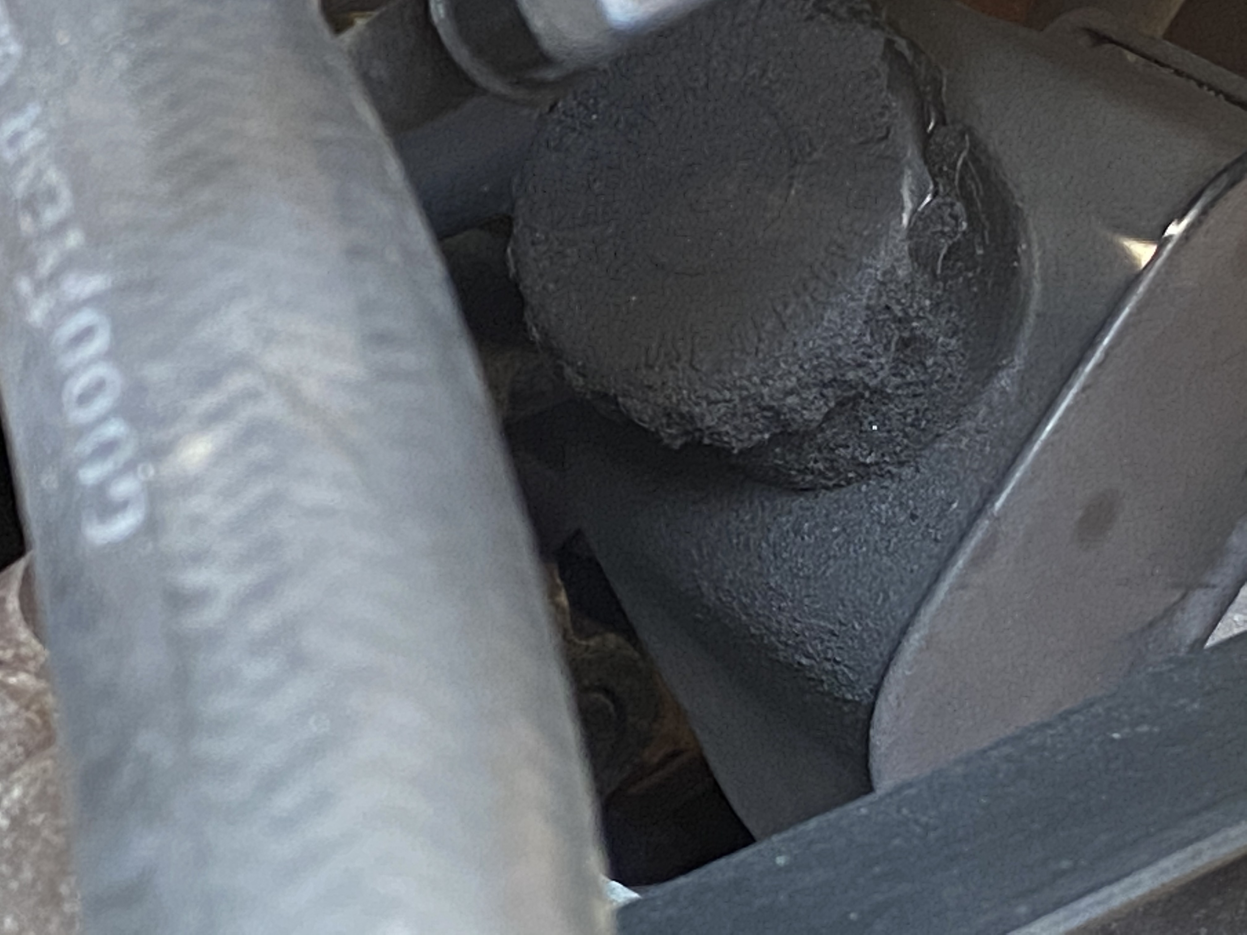

I bet if you clean the cap, it will have info on it to confirm the type of fluid inside.
