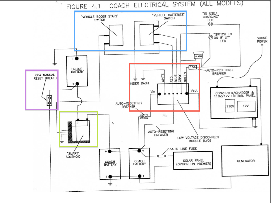

How does the converter connects to the LVD? If I understand it correctly, the converter connects to the DC panel via the CONV posts, and the DC panel connects to the LVD via the BATT posts. Then the LVD connect to the batteries. So when we have shore power, the charger/converter charges the batteries via the path: Charger -> DC Panel -> LVD -> 50A fuse -> batteries. Let me know if I miss anything.
The reason I want to confirm is because some LVD does not allow reverse voltage from the V-out to V-in, so I assume the Surepower LVD we all have have no issue with that?

I may be misunderstanding your question (especially since I am famished and should go make dinner), but at least in my era, it went like this:
Brown box ---> single 8AWG positive wire to LVD ---> single 8 AWG positive wire to house battery bank.
So as you will notice, there is not a separate wire for loads and charging. Hence why you have to have the "store" button in "not store" position in order to charge. In other words, as built, you can't have the rig in storage, turn everything off, and still charge (except by solar).
From the house battery bank ---> single 4AWG positive to Surepower ----> single 4AWG positive to Ford start battery.
The LVD is a bit of a "roundhouse" of small wires, but there are just the one in and out in terms of large cables.
1998 drawing; the LVD is in the red square:

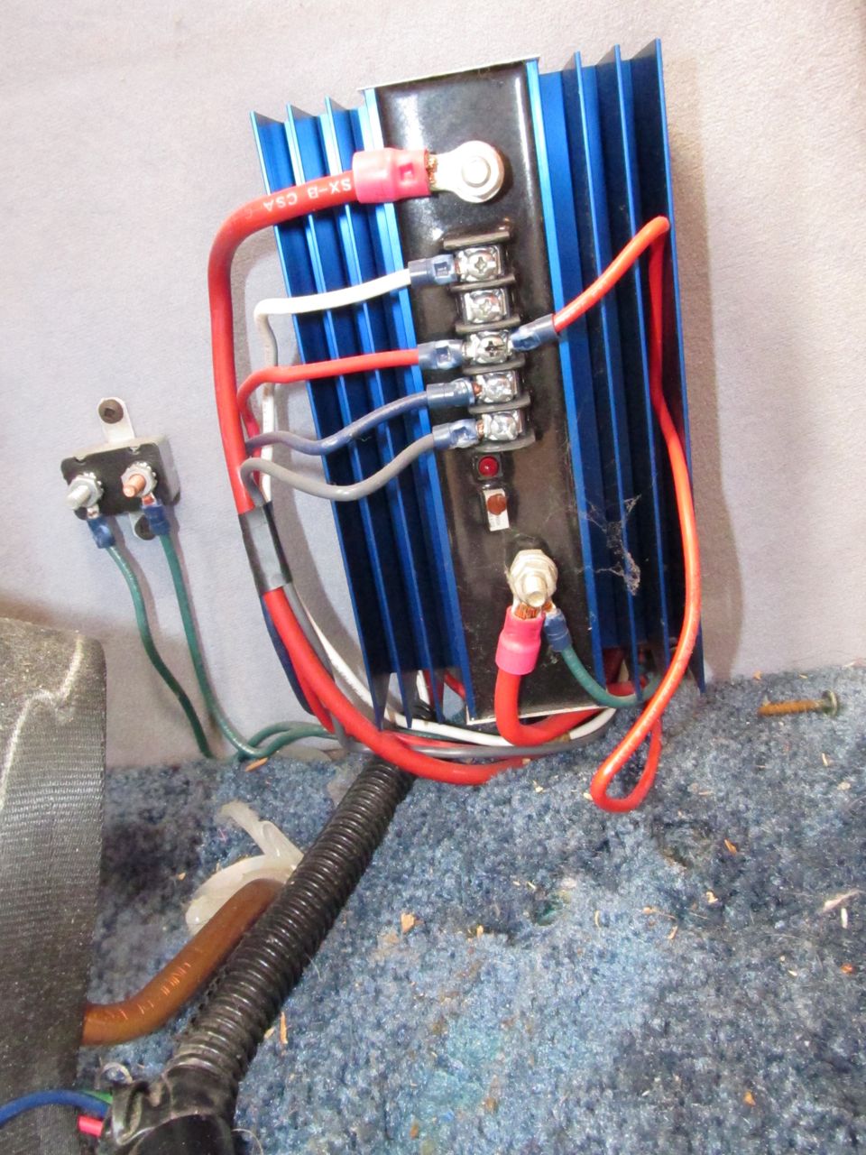

1999 LVD (now gone in my case):

Thank you, Blue. You got my question correctly. You confirmed that the connectivity that I mentioned is correct. I guess I will need to wire it differently if I went to the Smart BatteryProtect 65A LVD, which will be damaged if you try to charge the battery thru it.
