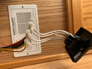

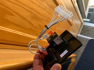

So, not exactly plug and play. Looks like there will need to be some splicing done here. Any suggestions to where I can find what goes to what? I guess the wires to the start switch are the same, but what of the meter?
