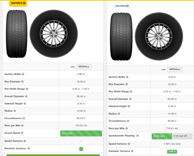

I think I need to modify what I said in my above post. I say "think," because I only had a few minutes to research this morning. So apparently the Defender LTX is not discontinued. Rather our specific stock size is discontinued (yep, we're obsolete :lol:). So the Agilis Cross Climate is not exactly the evolution of the series, but rather an alternative for those wanting our particular stock size.
I compared a "close" size, but not sure if the extra .39" width would be a problem on the rear. Also, speedo and odo would not be the same as revolutions per mile is not the same.
I will put some more time into researching the Agilis (which a few people had already mentioned above) before I get new tires, because I would prefer the stock size.
Clicking should enlarge:
