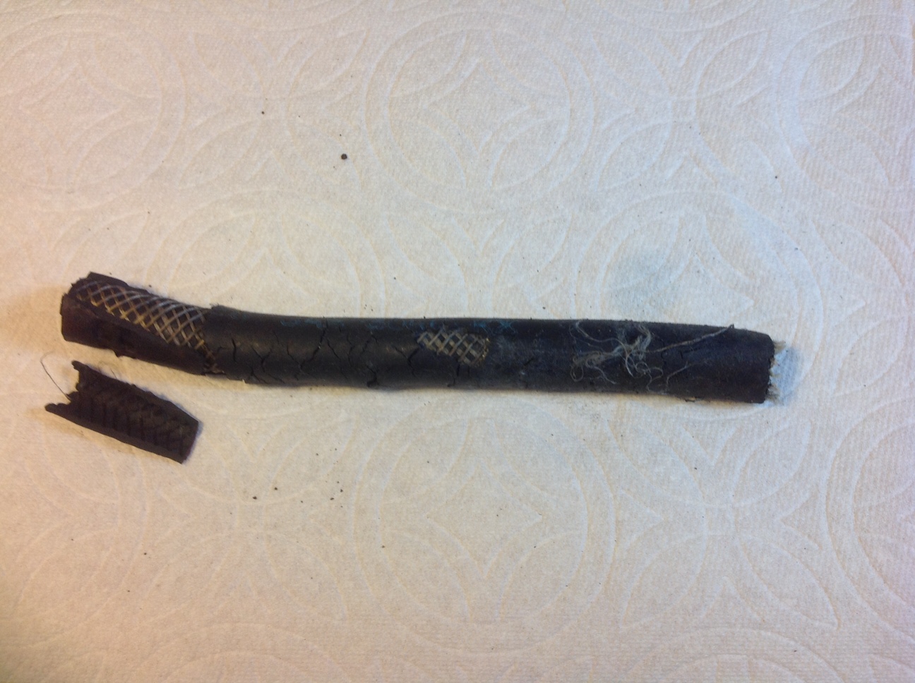

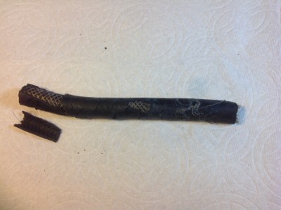

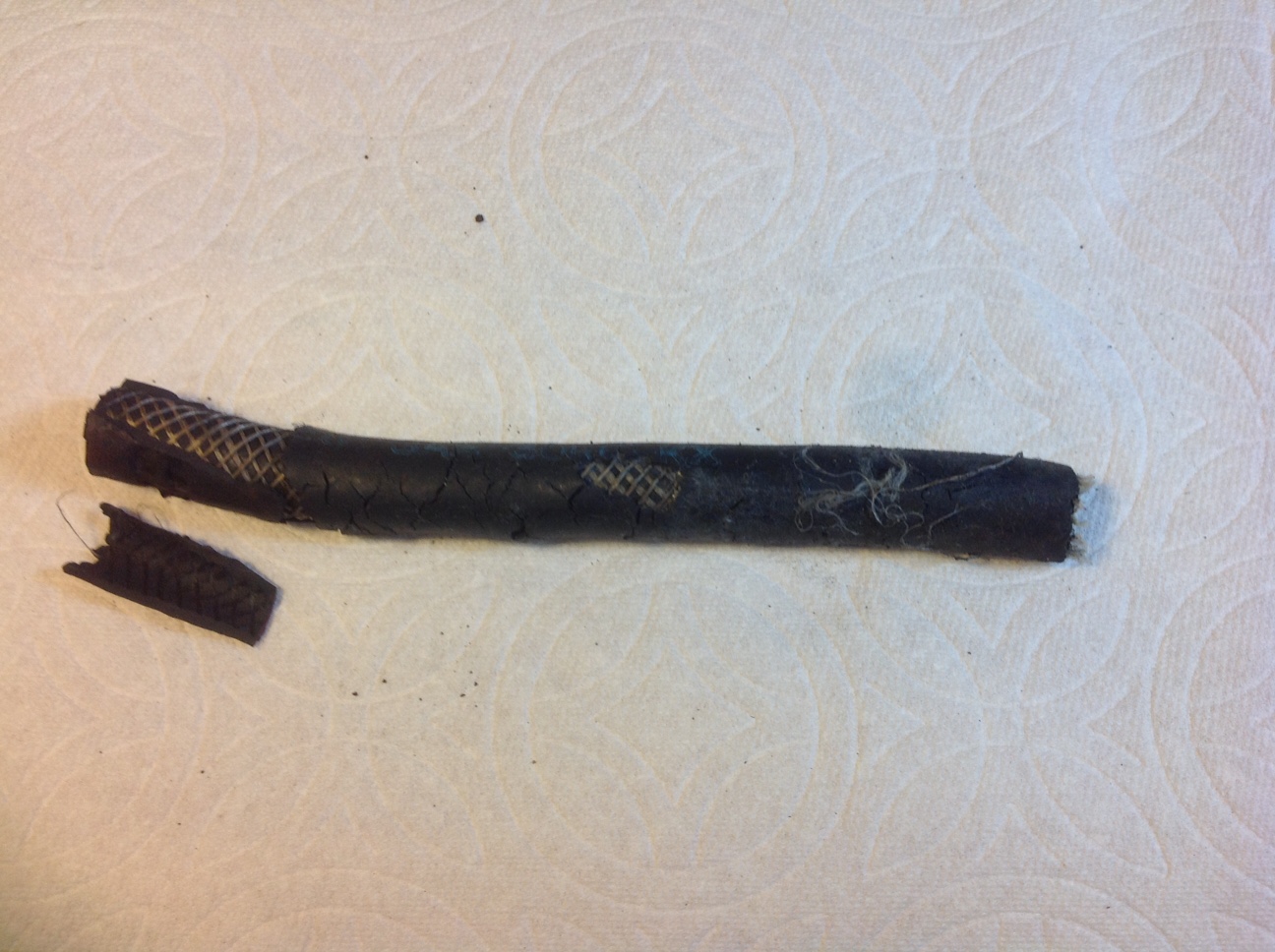

I'm looking at my leftover Onan fuel line right now and adding a shutoff would take a few seconds....
