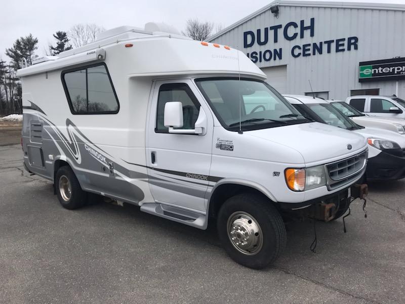

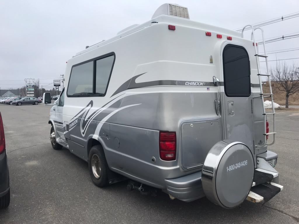

Re: (3) Overhead house lights-2003 Concourse XL
Thanks, now that I am more familiar with this site I can post photos.
I purchased the 2003 Concourse XL, 112,000 miles for $14,000 from an estate.
all major components function properly, I haven't had an opportunity yet to get back to the light issue yet but I did want to post a couple of photos for posterity.............I will post "after"photos once the body shop has reinstalled the front bumper and touched up the clearcoat/ paint.
Regards, Kevin
Regards, Kevin
