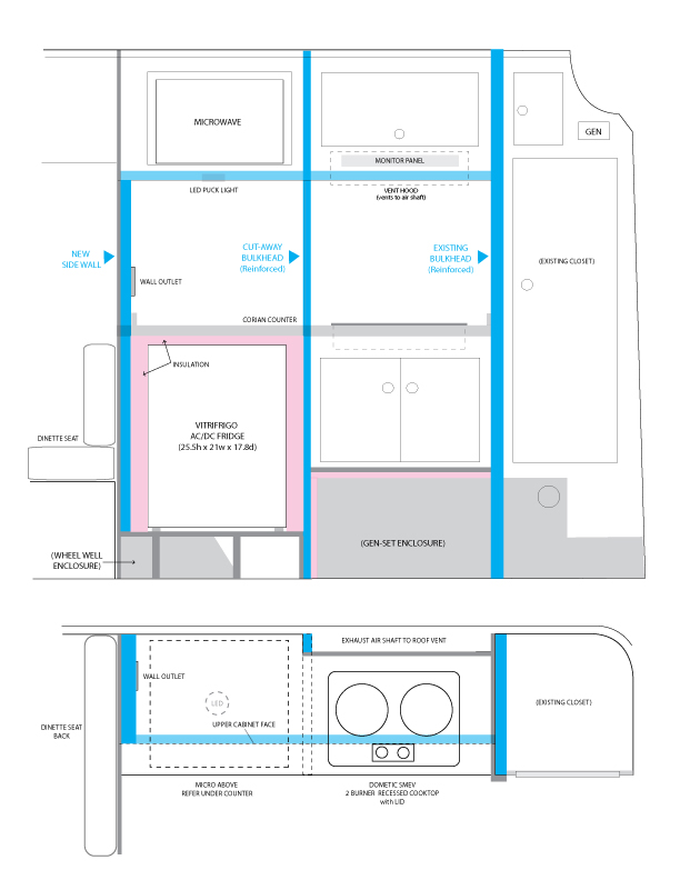

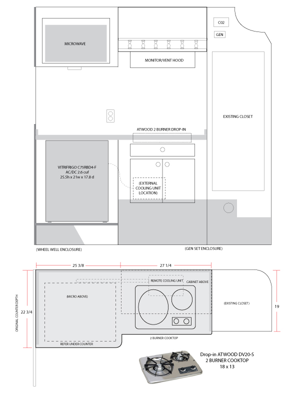

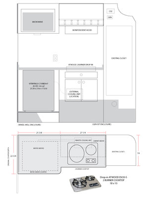

I'm also in the process of changing out the old Dometic, as well as redoing the starboard side of the galley. The project started out as replacing water damage repair from the PO (his carpentry skills left a lot to be desired). Also our travel style did not warrant the huge fridge, or the 3 burner cooktop. We wanted more floor and counter space across from the bathroom and to eliminate the "tunnel effect" of the rear exit area. Updating 14+ year old appliances also made the list. That said, my research came up with a fridge selection that I narrowed down to the Vitrifrigo C75RBD4-F. This AC/DC only unit offers a 2.6 cuf box with freezer compartment. It's unique feature is the external cooling unit which can be remotely located up to 4 feet away from the fridge box. Here's why this helps in my design layout. The fridge can now be located in the space under the microwave previously occupied by the cooktop, allowing for more counter top area. My new microwave is a Frigidaire 1000 w, only 13.5 in. deep, making the modified upper cabinet protrude out less than 19 in. The Atwood 2 burner cooktop fits nicely at the rear area of the long Corian counter. A new series B Jensen monitor/vent hood will be ducted to the roof vent as well. Back to the fridge, the remote cooling unit will be located on the shelf directly below the new cooktop cabinet, behind the existing exterior access/vent door. This will give the cooling unit more than adequate ventilation with exit airflow unrestricted thru the rooftop vent. The existing LPG hookup for the Atwood will be the one used by the old Dometic. The old cooktop LP line may be plugged or re-routed for an exterior BBQ hookup. The unrestricted view to the rear entry, and the additional width gained from the remodel should address all our concerns. No photos, but maybe this layout will help explain.
