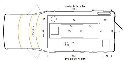

adventureselsewhere wrote: October 14th, 2019, 4:21 pm 2. I eventually would like to do away with propane, since I do need to drive through tunnels. But I also want to be able to be off-grid as much as possible. I like the idea of solar. So, what should I be looking for in order to have the solar be able to power the whole rig?
I don't see the connection between tunnels and propane.
I'm unconvinced there's enough roof space to go all solar. Do the maths, your mileage may vary.

So, okay, I see by your very helpful graphic that there's probably not enough room on top to be solar self-sufficient, but any other ideas? Maybe extra deep cycle batteries I can recharge when I can plug in at home?
