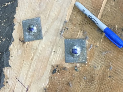

When we purchased our Destiny, the original carpet had been replaced with carpet tiles. It never felt clean. We had installed cork in 2 other RVs with positive results. Because of the floor bolts, we went with 1/2” thick planks so that the underside of the planks could be carved out over the bolts. Mark the bolts with paint or a Sharpie and place the plank overtop. Then you’ll know where to carve.
Cork is insulating, warm, and soft underfoot, much like carpet. However it can be easily cleaned. We love the result!
