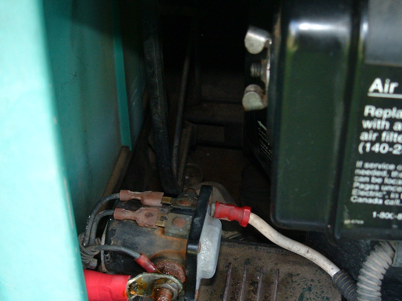

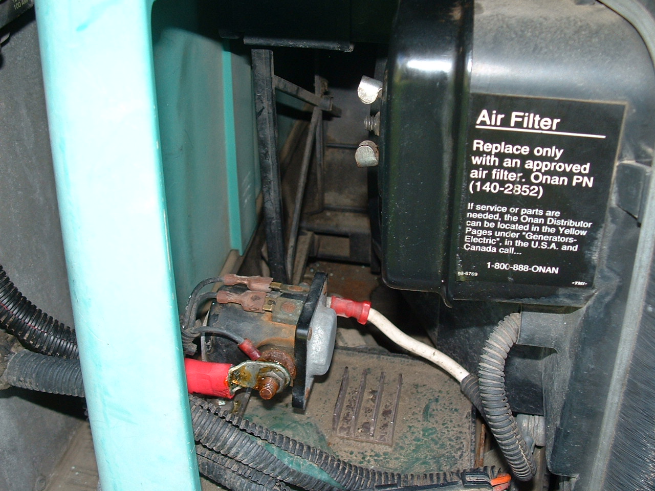

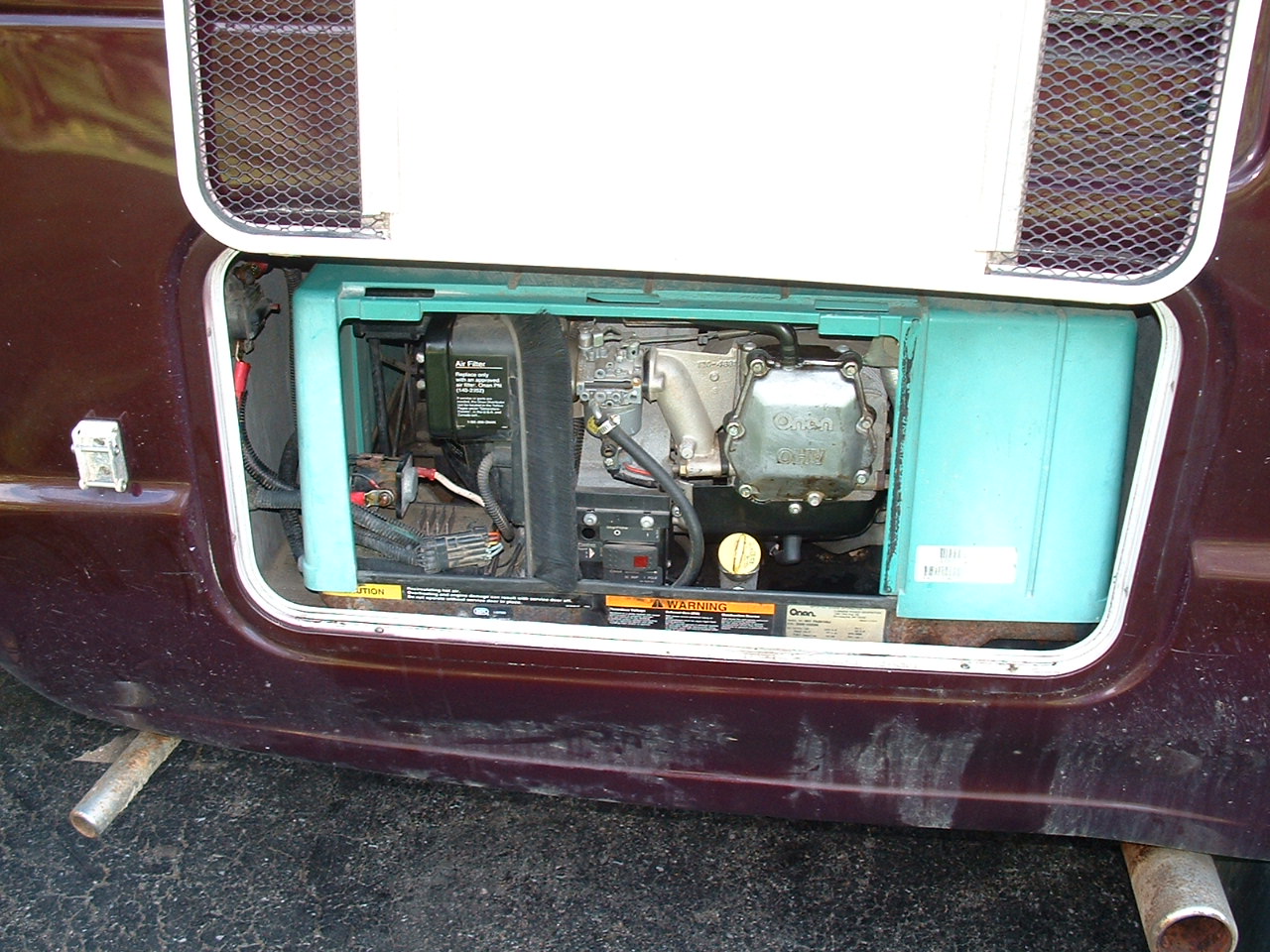

chin_k I've attached pics of my generator. One is standing back so you can see the genny and its' compartment. Number two shows the area around the air filter. The fuel filter is at the far rear bottom corner of this area- not even visible in this pic. Pic number 3 is a little closer and if you look real close you can vaguely see one end of the fuel filter peeking out behind the fuel pump. So the fuel line comes in thru the bottom rear left corner of the generator casing where it then attaches to the fuel filter. I can get one hand in to just touch the filter and that's it. I see no way to get at that bad boy w/o yanking the genny out! But I sure wish somebody would prove me wrong.

OK, I think I can see two possible issues.
If you watch this video, you can see the fellow was able to get access to the fuel pump and fuel filter in his rig without pulling the genset out.
The first step is to remove the solenoid, which sit on top of the control board.
Now, he skip one important step in the video. There are two torx screws in the lower left corner of the genset, and you need to remove it to get the control board out. This is the second step. I can see that it is going to be difficult to get it removed, since there is not much space between the screws and the back of the rig's wall. You maybe able to get a 1/4 inch torx bit and use a 1/4 ratcheting wrench to get in there, but I am not sure.... If I have to do it in the future, I may have to use a pair of locking pliers to take them out, and replace them with those with a Allen socket so that I can remove them in the future at an angle.
Another possible complication is to disconnect the fuel filter from the fuel line. I don't think it is easy to access the connection in the back of the genset enclosure, so I hope there is enough slack in the fuel line to pull it into the case, and disconnect it there.
