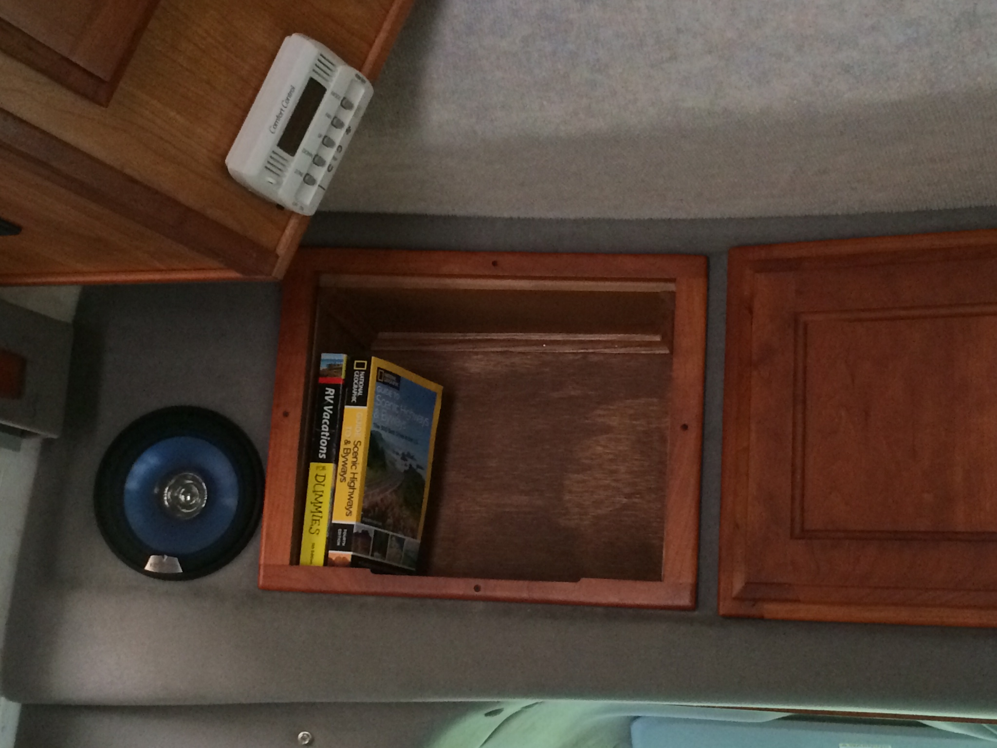

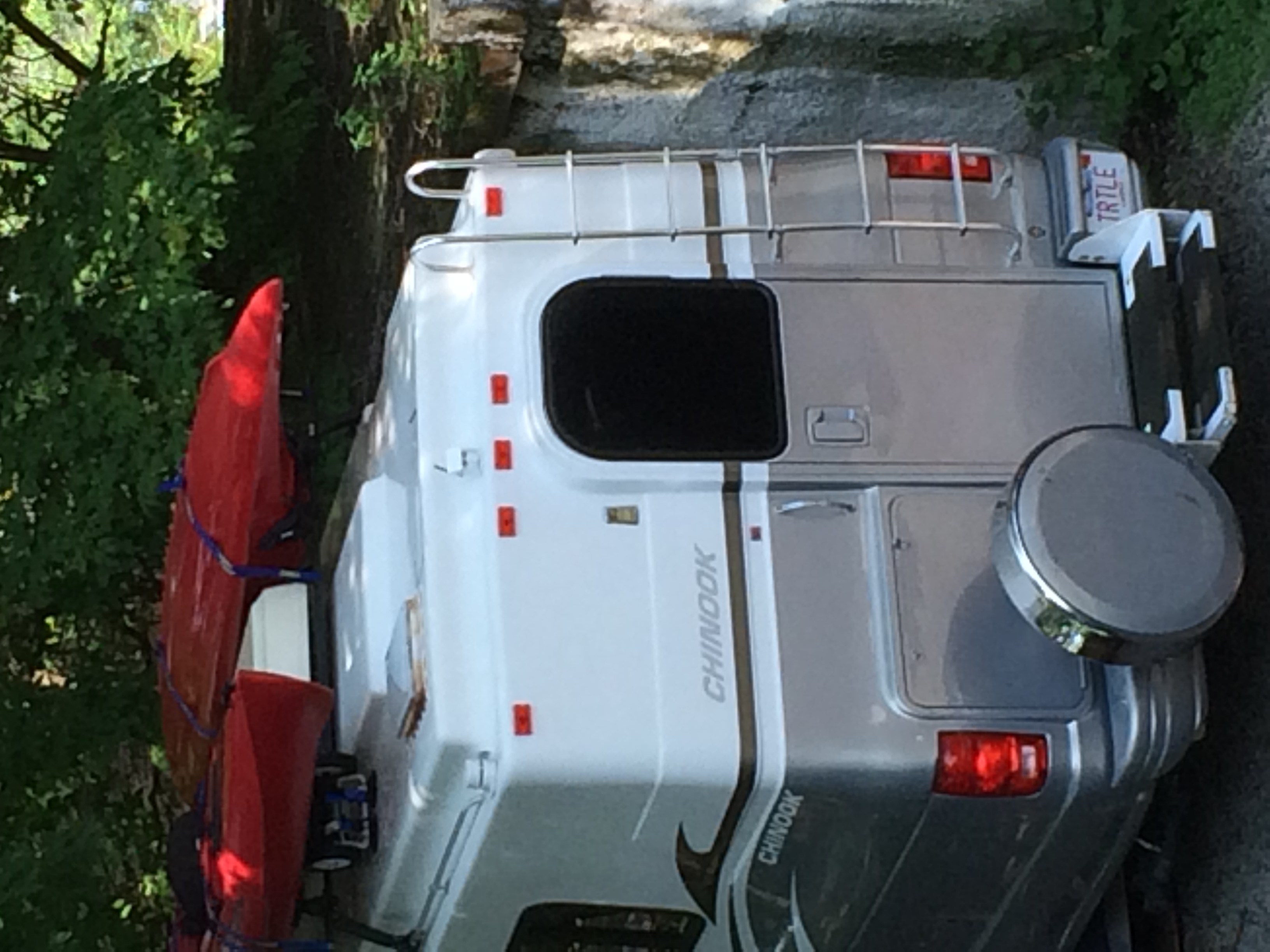

As Blue-Go mentioned, I have done a number of things over the years to increase storage--both inside and out. I love the see of our Chinooks, indeed spent the time looking for one so that we would have something comfortable enough to live in for weeks/months at a time, but also get into those out-of-the-way campsites. And our "Turtle" has proven perfect for all of that...BUT, with a small footprint comes the challenge of adequate storage. So here is what I have done to address the storage issue:
Inside:
--removed the TV and created a "cubby"...we use it as our library for books (yes, we still like reading actual books!)

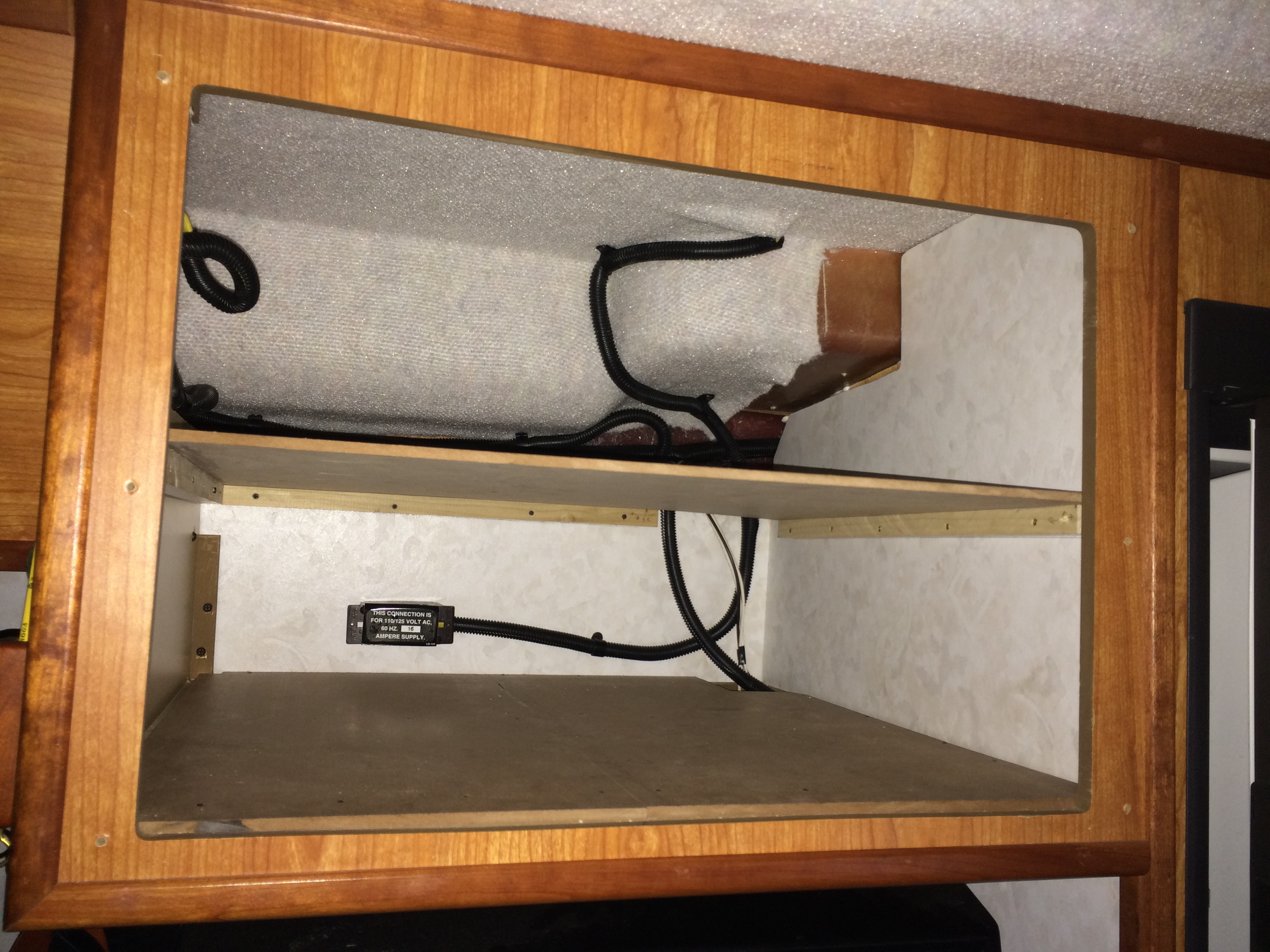

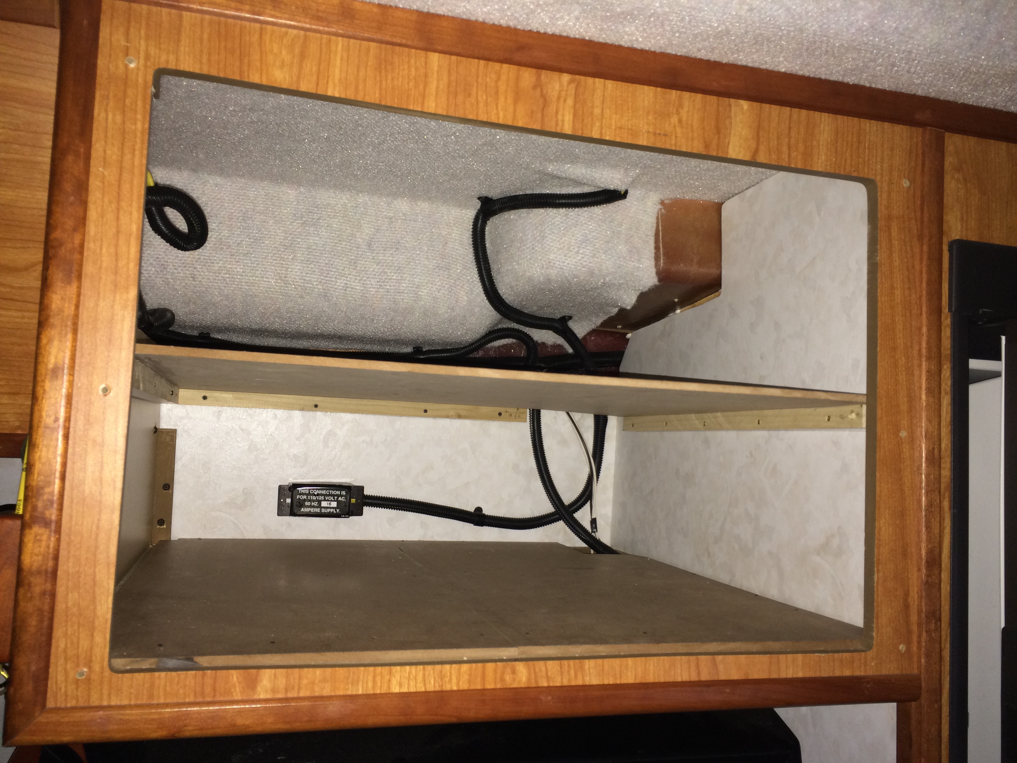

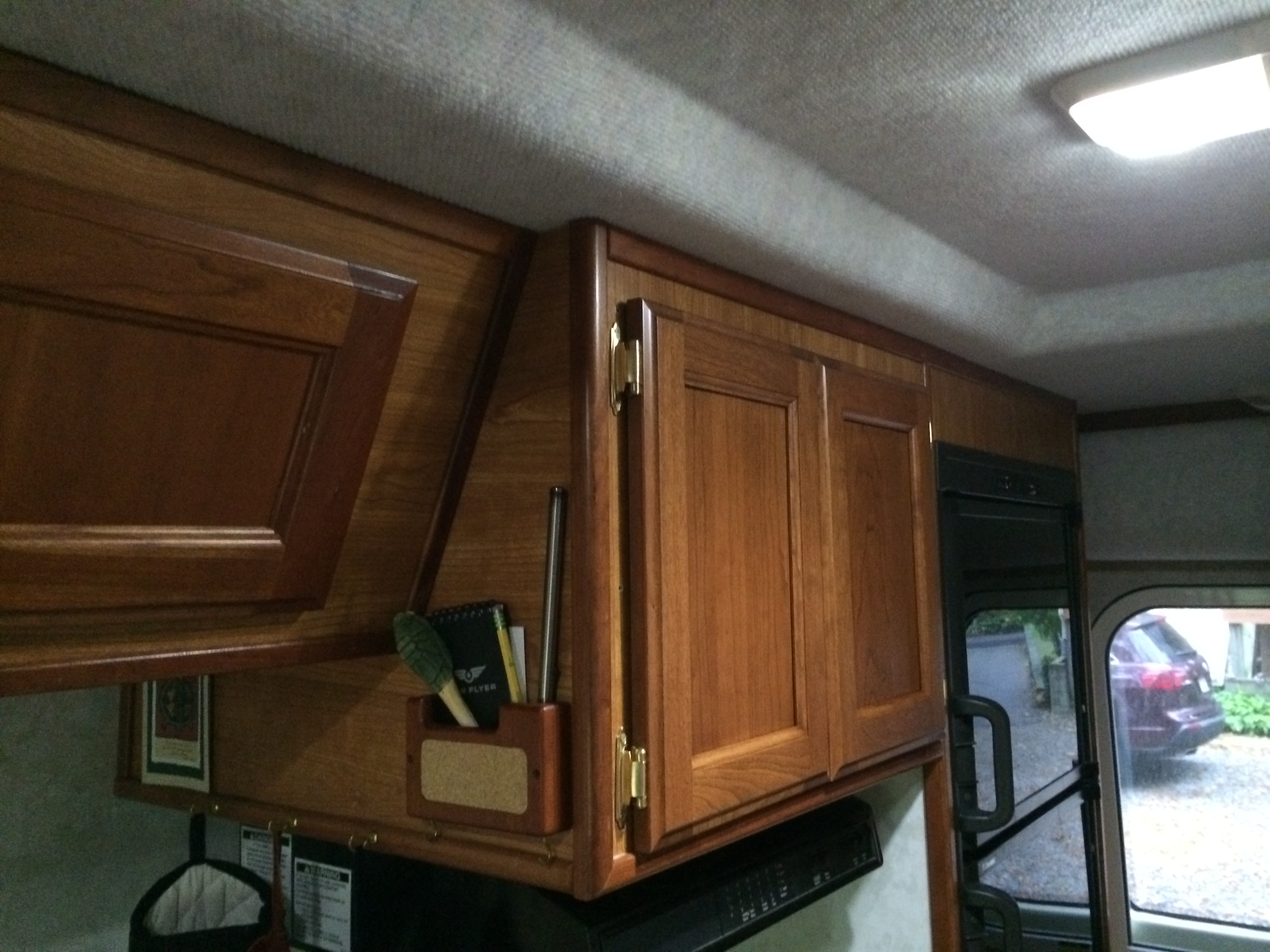

--pulled the microwave (don't really use one at home, and found no need for it on the road). Built two shelves in the space that we use as our pantry (dry food), and then had custom doors made for it to match our other cherry storage hatches.

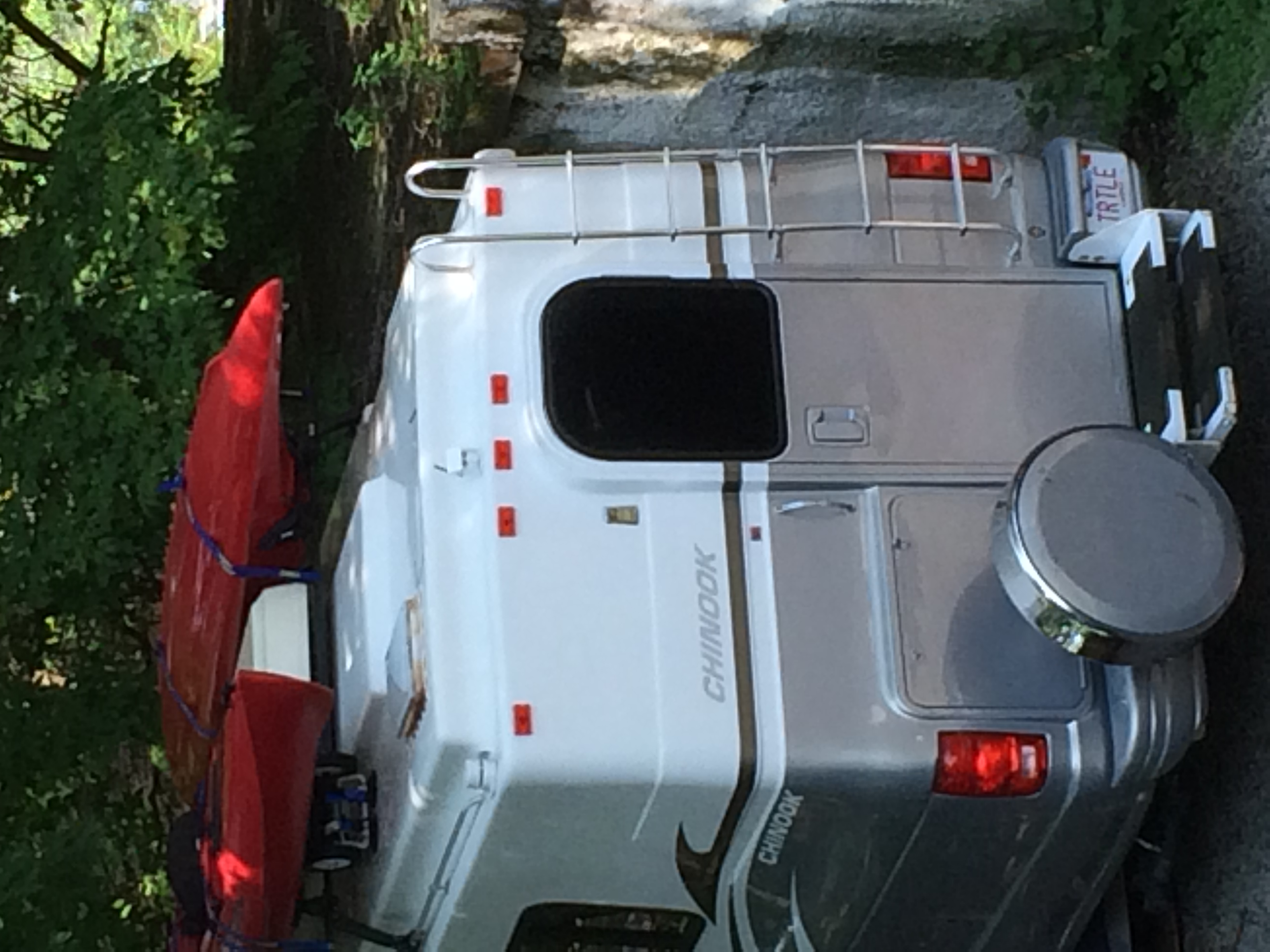

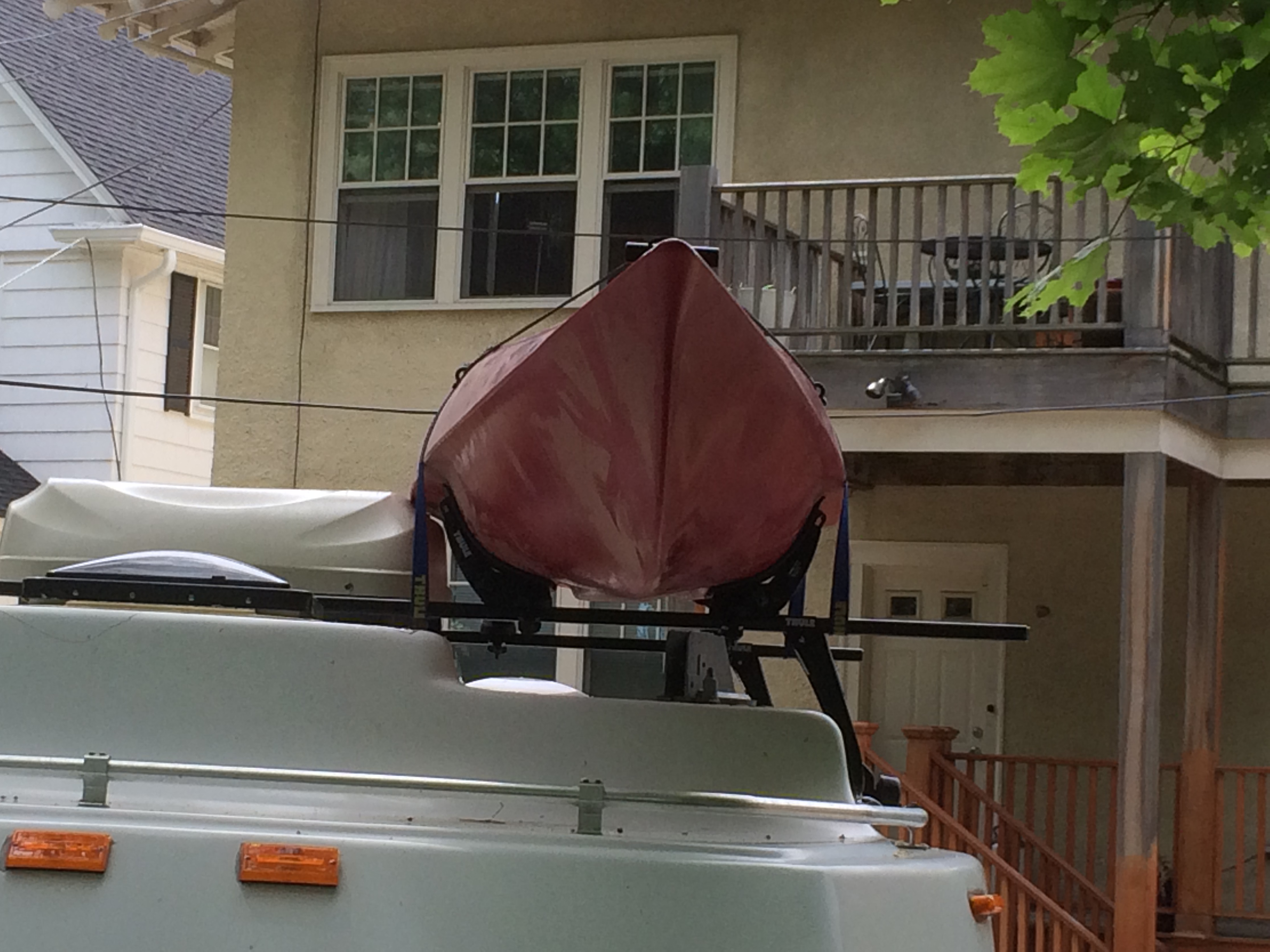

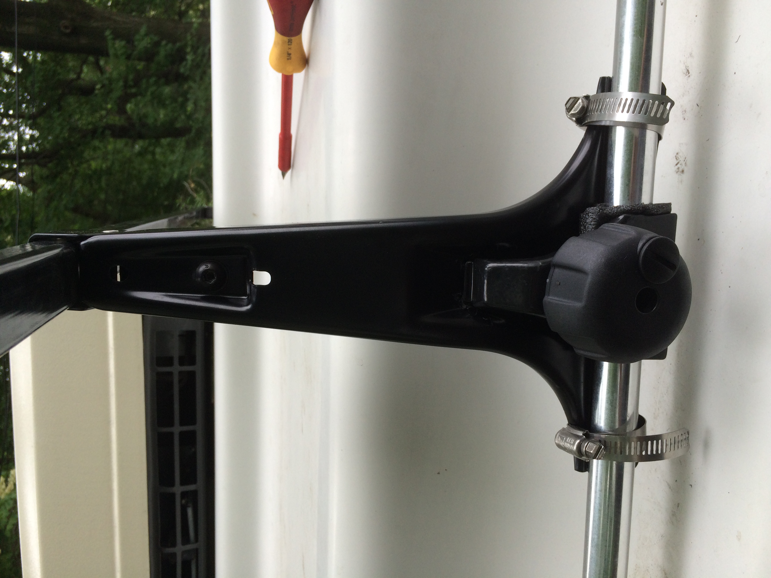

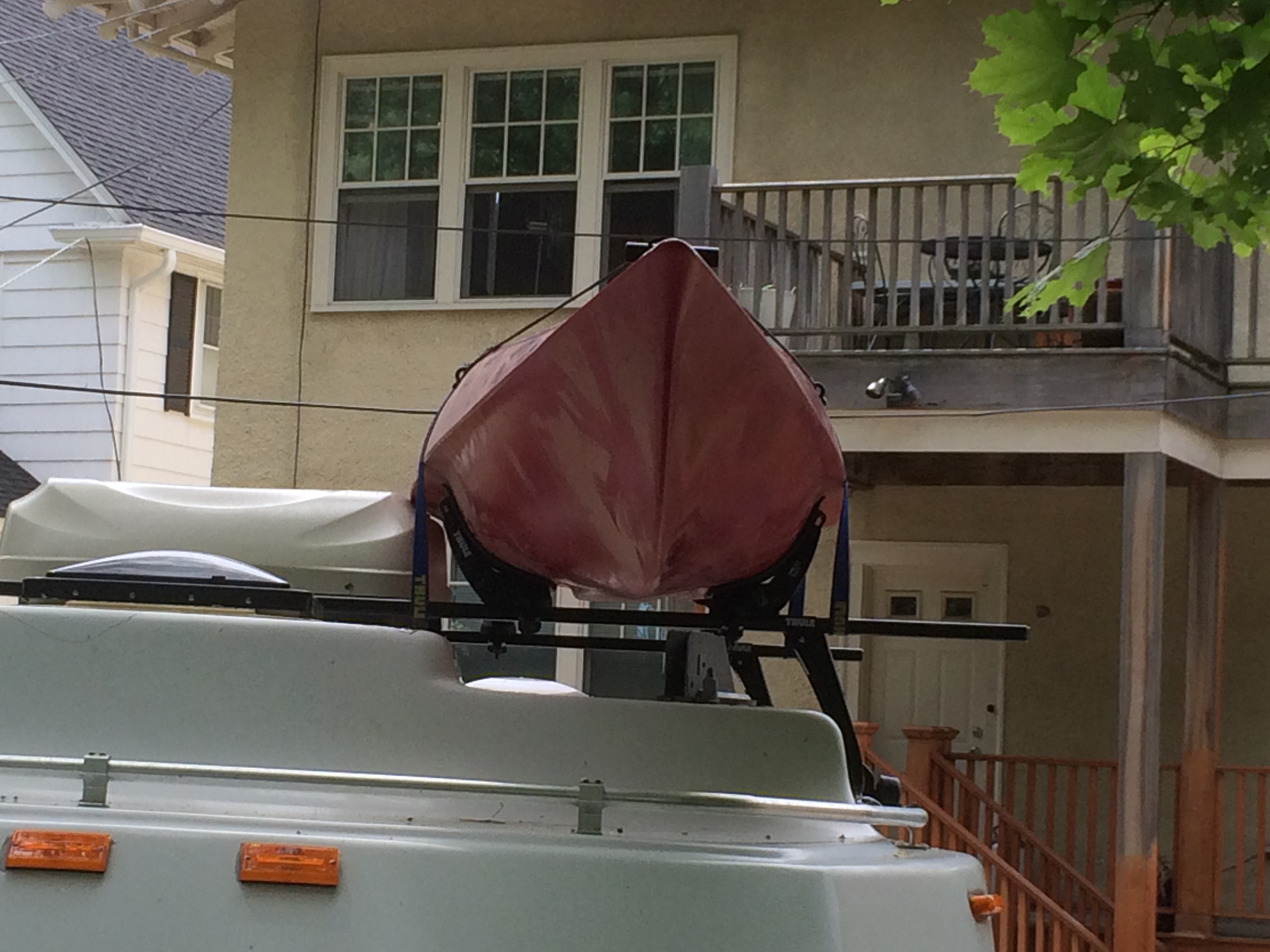

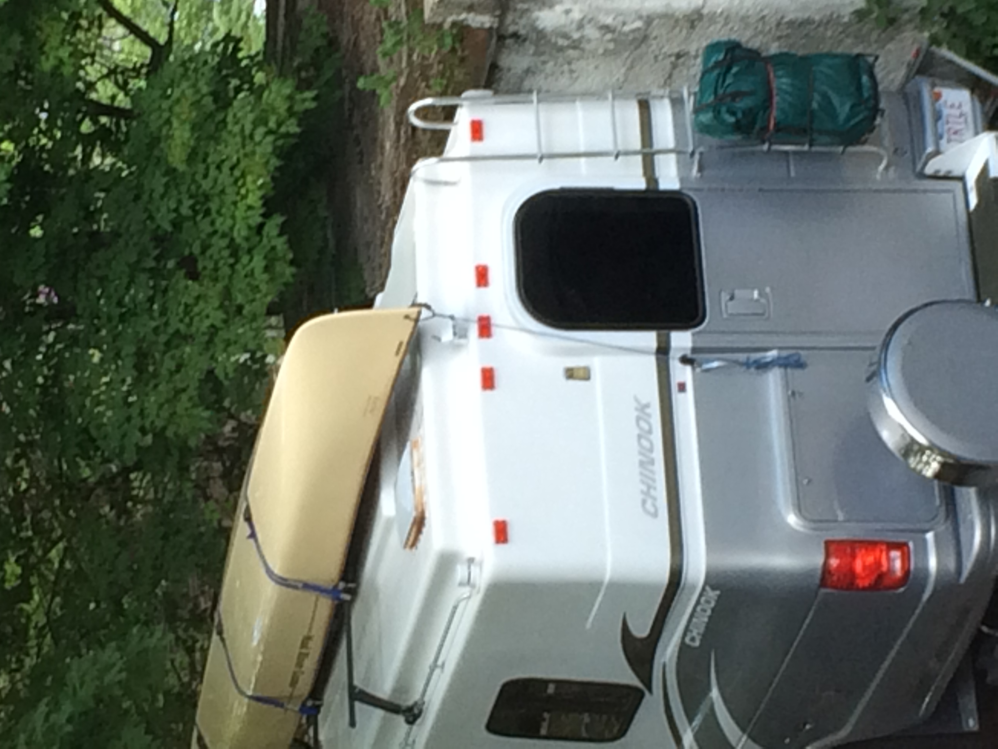

--Mounted Thule cross bars on the roof. Used "high feet" attached to the outside rail (4 years of hauling canoes and kayaks across the country without issue). We can carry two kayaks mounted in "cradle holder" or a canoe in the middle (thwart removed to fit over the AC unit).

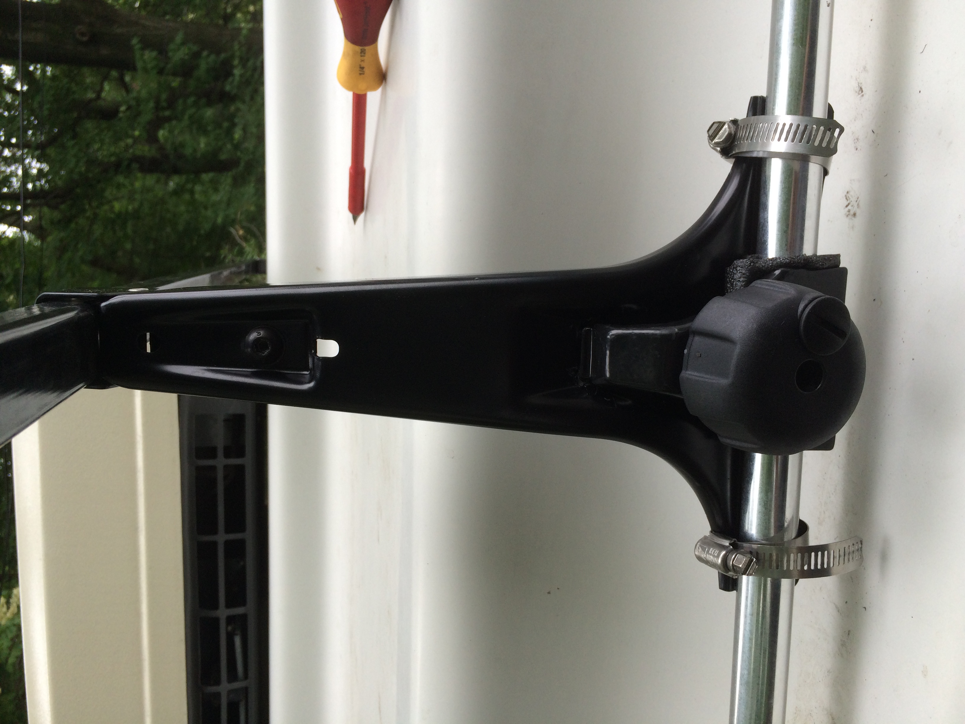

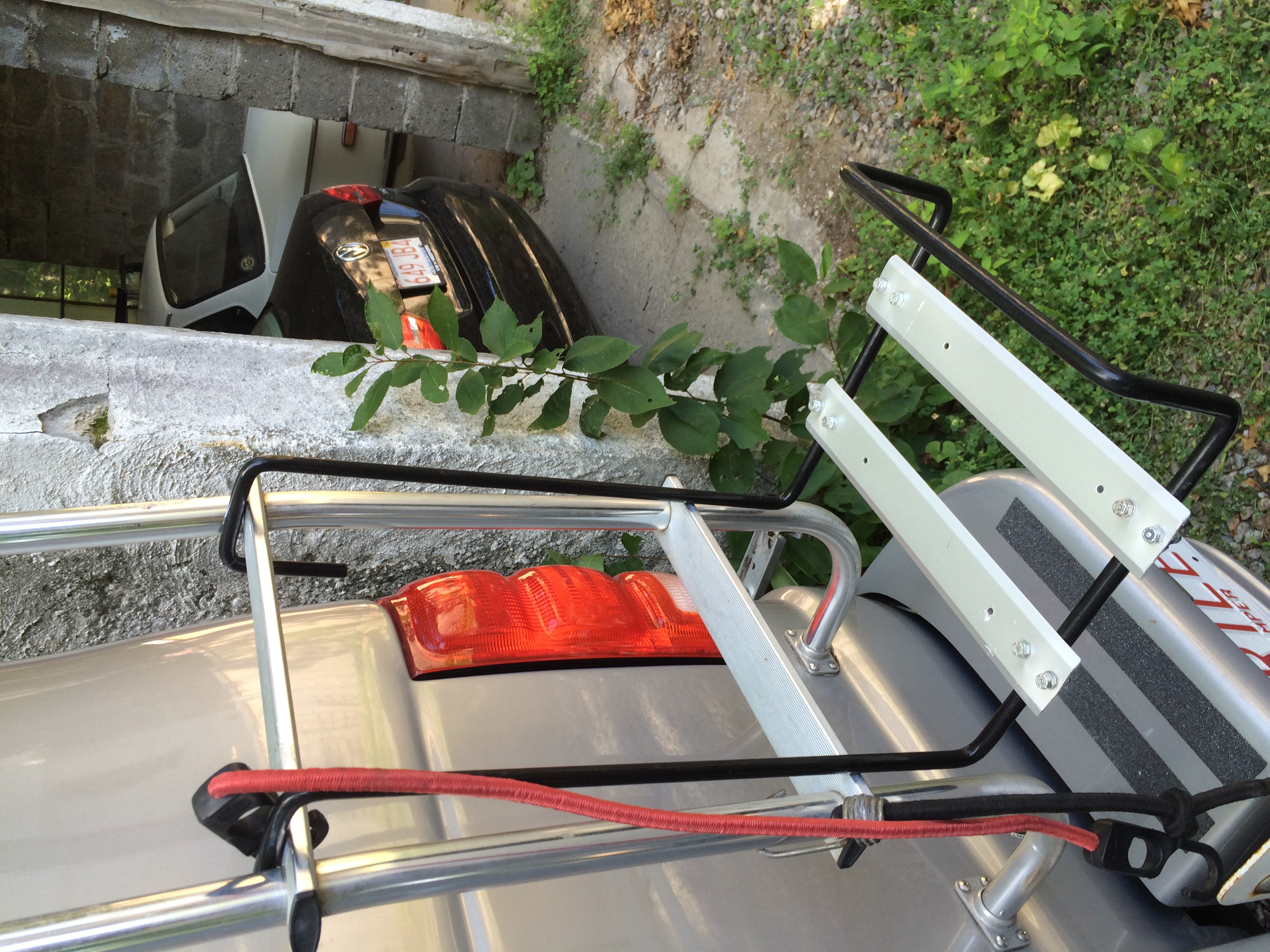

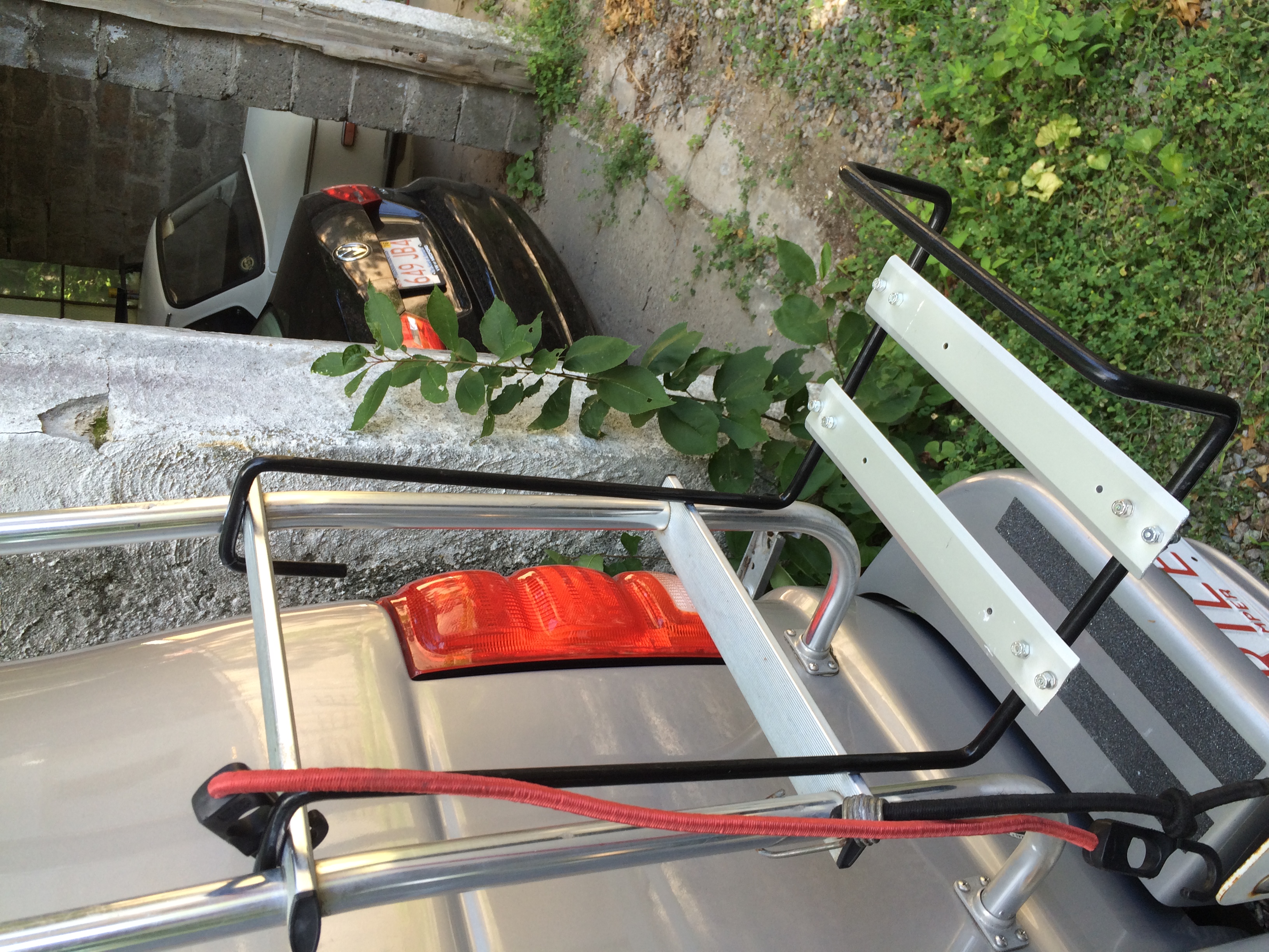

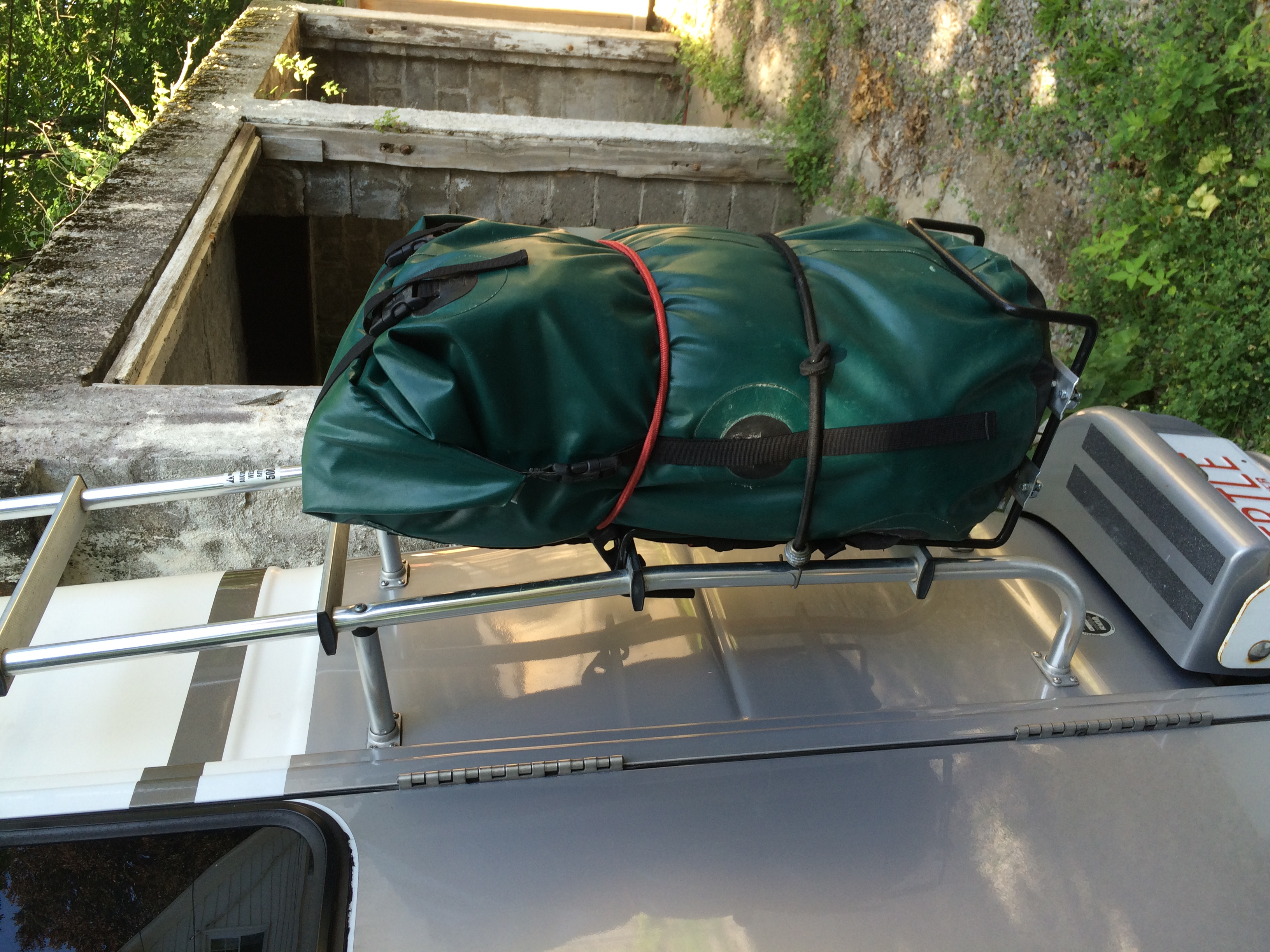

--Made my own ladder holder out of a stock hanging rack to which I fastened two aluminum cross pieces at bottom. This will actually hold two full-sized dry bags (3+ liter) stacked on top of each other...nothing too heavy (bug tent, spare camping tent, extra sleeping bags and pads for guests, tarps, ropes, life jackets, etc.)

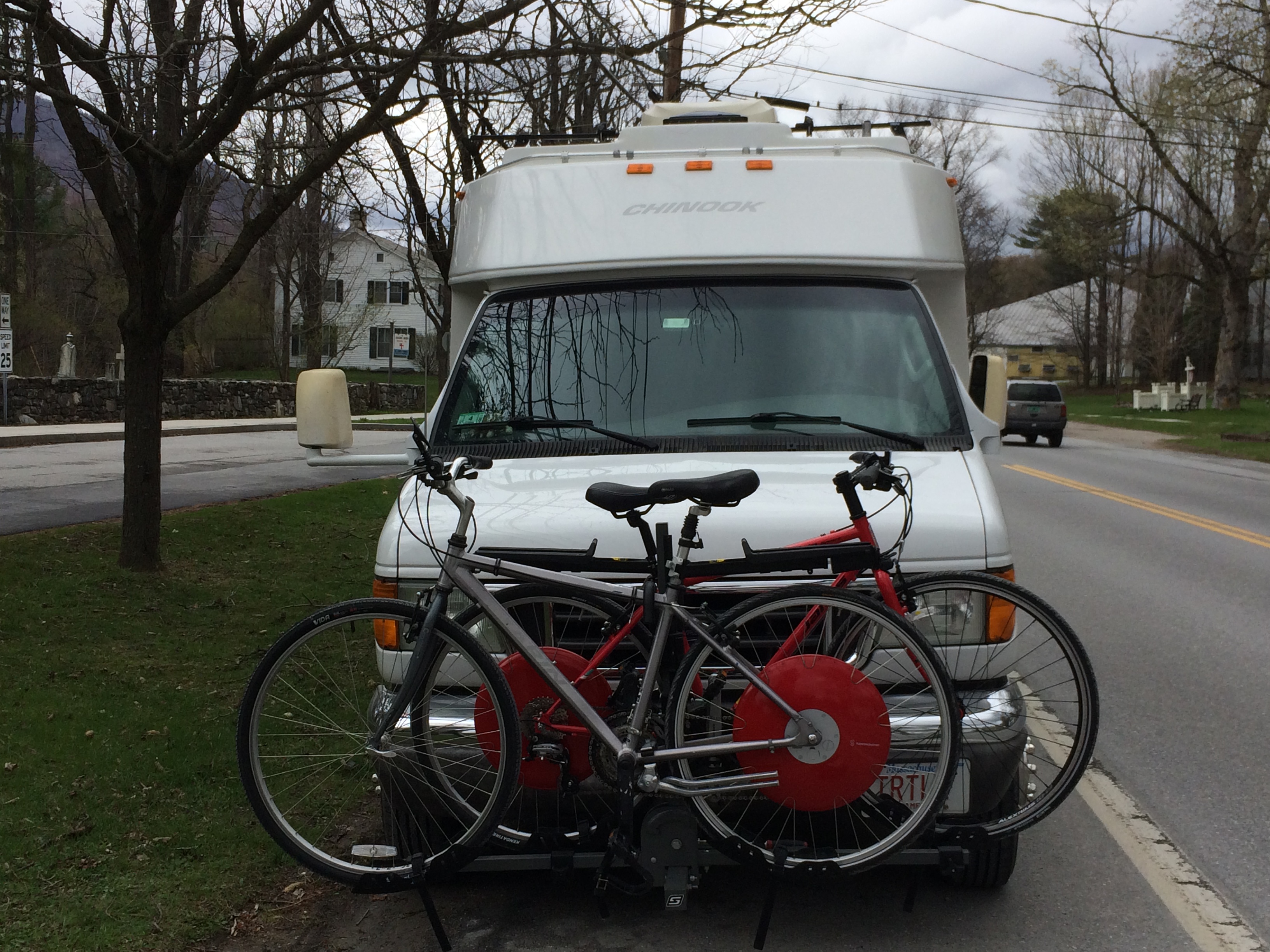

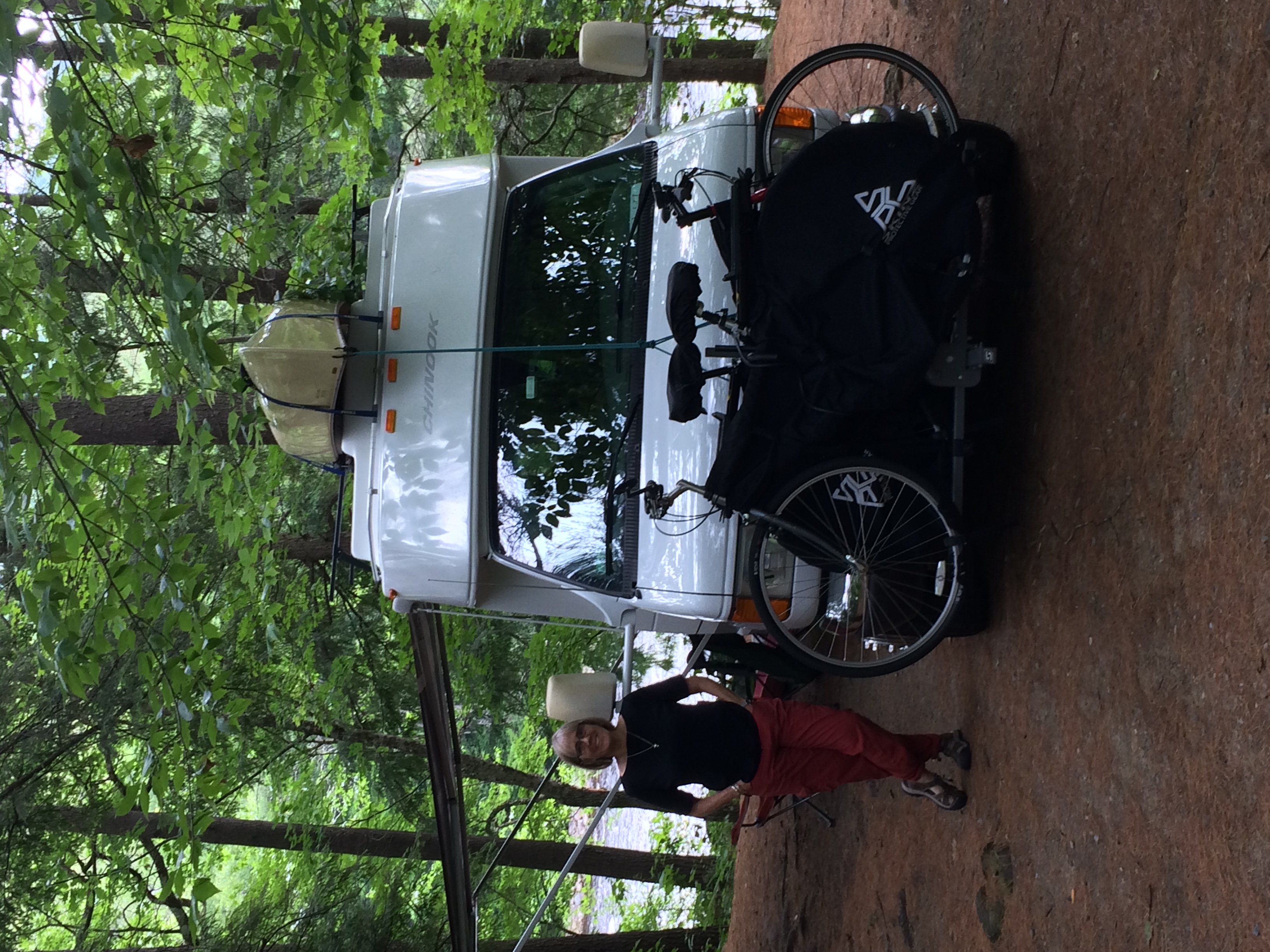

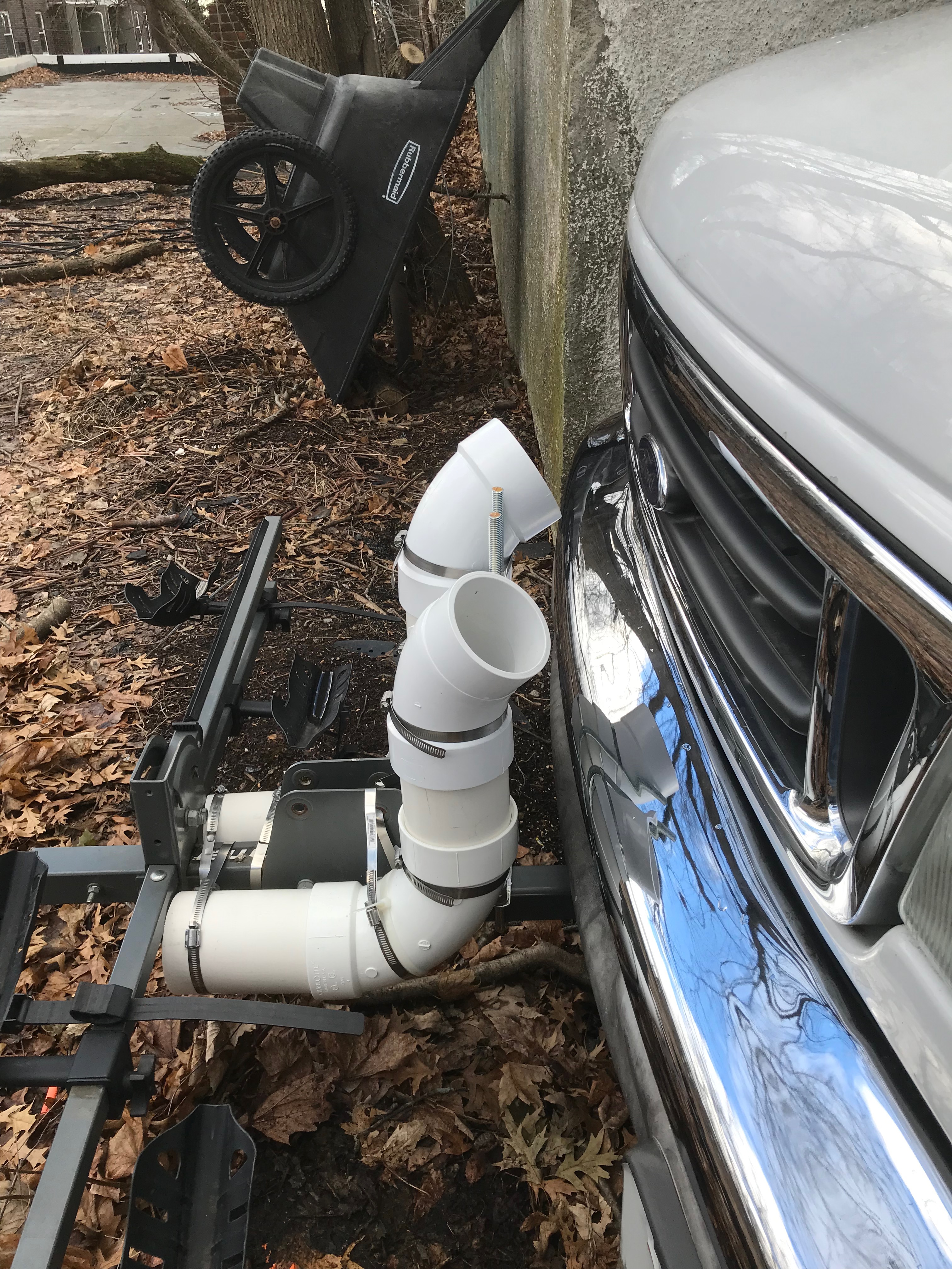

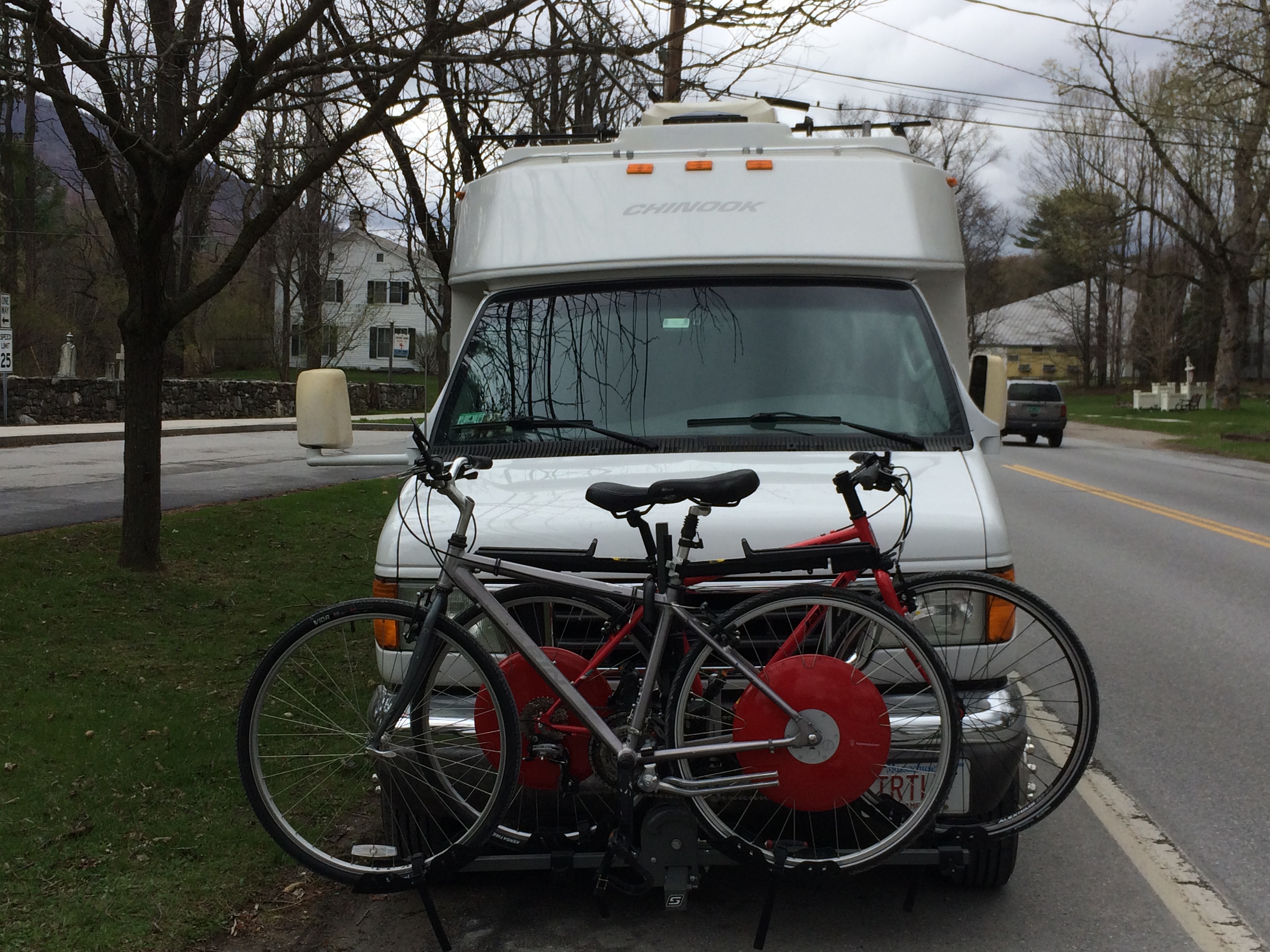

--Mounted a front hitch with bike rack for our two "Copenhagen Wheel" electric assist bikes...I use "Skinz" covers to protect them--NOTE...out of concern for maintaining air flow, I have fashioned my own "supercharger" out of PVC to pull air from underneath the rack to run behind the bikes to discharge directly toward the grill. This is a work in progress (have a scan gauge to monitor water temp and trans temp that I am using to base-line and see whether or not it actually works. Stay tuned for that report!

I have pics of all this that I will attempt to attach...may take a couple of posts.
Happy to answer any questions.

Here are some more pics of the storage from previous post

And more storage pics...
