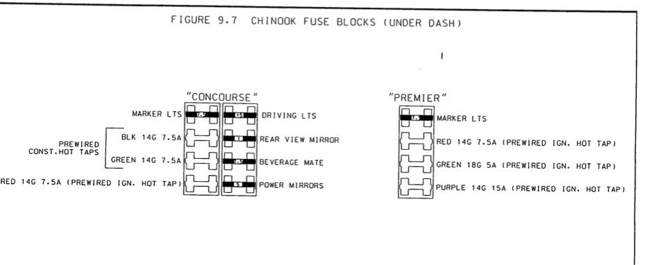

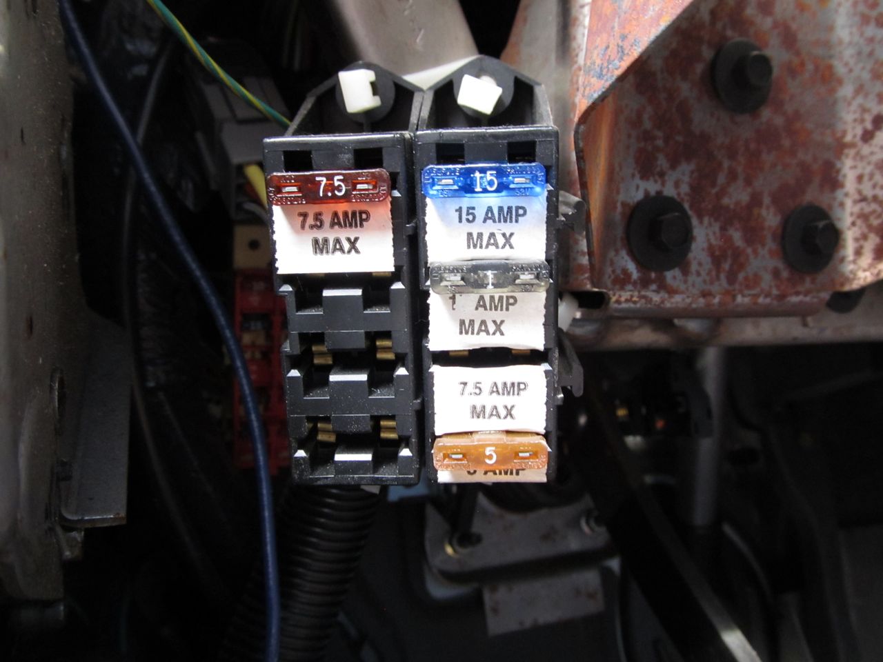

On my Chinook (early 1999) the power mirrors are fused at the Chinook added fuse block. It is right in front of the Ford interior fuse block which is sort of in the driver's left shin area under the dash.
Here is a photo of mine. Additionally here is a sketch from the 1998 Concourse manual.
If you have replaced the fuse with the correct size and it is continually blowing, then I would expect a broken or shorted wire somewhere. Maybe in the folding part where it must flex?
As you can see from the manual's diagram, it is located in the lower right position, and should be a 5 amp fuse. You can't read the label in the photo of my fuse block but it's the gold colored 5 amp fuse in the lower right position. This is the Chinook added fuse block, btw, not the Ford one.
