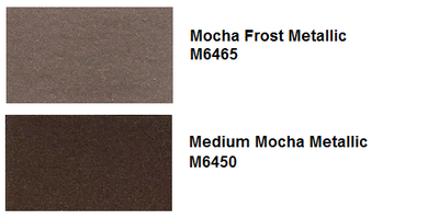

With the exception of the Premier, none of the graphics on our style Chinooks are decals.
It's all automotive paint covered with clear coat.
The paint codes are on two paper stickers in the driver's door jamb, if they're still there after all these years.
If you're brown color, then the original Ford codes are:
Brown stripes Ford color codes
You can find touch up paint on Amazon using those, or give them to a paint shop.

I bought those paints from Amazon. Didn't seem to match. Went to local automotive store. They have a machine that they put right on the vehicle for a more exact match. Cost around $30 a can for a 1 step ( included clear coat in the paint). Came out really good. I'd send pictures but chinook is now under cover with snow on it.
