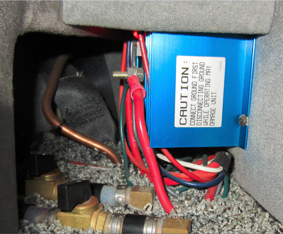

So to add to what Blue~Go noted because both devices are made by Sure Power and the model numbers have some similarity so its confusing ........
The Sure Power 1315 is under the van hood (far right side facing the truck) and is referred to as a "Battery Separator".
The Sure Power 135001 is on the coach floor between the drivers seatback and the couch and is referred to as the "Low Voltage Disconnect". (PIC attached)
