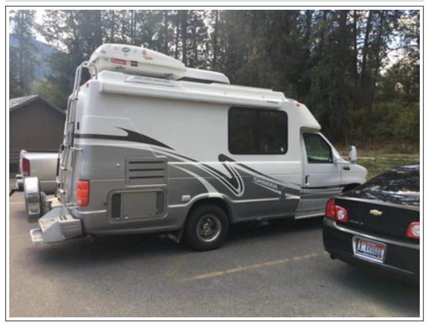

A number of Chinooks came stock with the short/squat Yakima type boxes on the roof. Of course anything you add up top will have an effect, but that's obvious. Mount it well and load it appropriately (no storing your lead bars up there) and things will probably be fine.
While I have no problem mounting solar panels with only VHB tape (with appropriately large foot surface area), I don't think I'd feel comfortable mounting a roof box that way alone. I'd want fasteners into the roof. And that calls for some sort of either core reinforcement (what they did originally for the roof box equipped models), or backing plates (on the inside of the rig) or both. So you'd be looking at getting into the roof core. The standard roof core is just basically foam or honeycombed plastic, so it can't hold fasteners. You could perhaps hollow out an area, fill it with thickened epoxy, then drill and tap (this construction is similar to cored boats, so I'm thinking along those lines). You could add VHB tape to the feet as a second line of fastening (also with some butyl or something to bed the fastener holes).
For a box on the tippy top layer, I suppose you could consider vertically mounted brackets on the "side edges" of the top tier. Those would be sort of more in shear than tension (kinda, depending on forces). That vertical edge is probably not cored, so you could through bolt easily. A box that doesn't only sit on the top tier wouldn't be able to only use those vertical flanges.
This is all just musing as I decided to eschew roof-top storage. My reasons: Windage, hassle loading and unloading, and I wanted more space for solar panels (with least shading). I would probably go to Swing Away rear box, a frame mounted box in lieu of the spare tire (off to the side of the door - my spare is up front now), or a small trailer before loading up the roof (but that's just me; not saying that applies to others).
