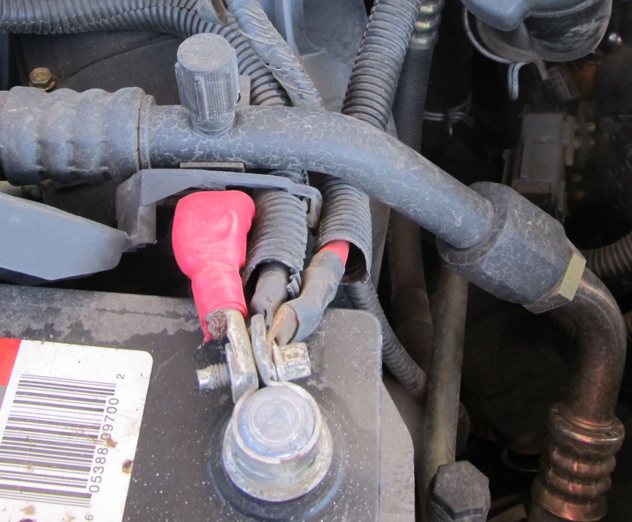

Here is a photo of the original start battery connections on my Chinook. The lug on the right side (as we look at the photo) is the one that goes over to the separator (yes, the lug is pulling through the nut -- that has been completely changed now; larger wire, marine terminals with lugs, and it's fused -- I also moved the gen start to the house bank).
BTW, the center lug's wire went to a circuit breaker near the aft edge of the hood and thence to the gen start; the left lug was the Ford one (with a "double" wire).
