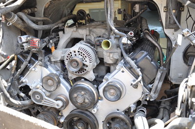

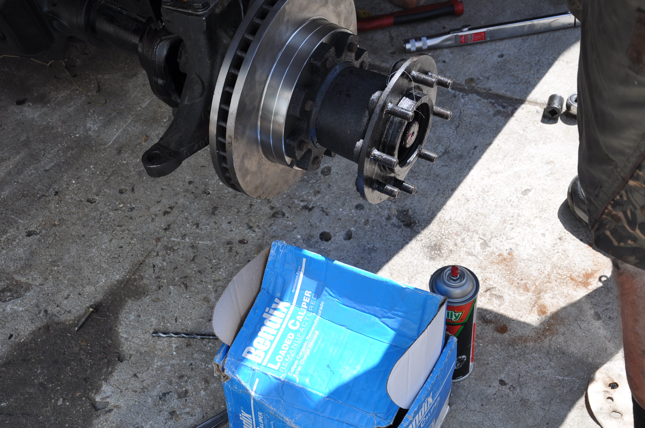

Hi I am attempting to show pictures of a 1998 Chinook premier that I am installing a factory rebuilt v10 and a 4x4 conversion. The prior owner took the Chinook for an oil change and the company forgot to fill it with oil. The result a hole in the engine block. I purchased a factory rebuilt engine from Ford. 3 year unlimited mileage warranty. I decided while I was at it to convert it to 4 wheel drive using a 2002 Ford E350 Quigley van as a donor vehicle. The Quigley van utilized a kingpin dana 60 with serviceable bearings. I had to find dually front hubs and have them machined for the abs tone rings. I replaced both outer axles with 35 spline chromoly axles as well as one of the inner axles; The housing received new 4.11 gears and new posi (limit slip) along with all new seals, bearings, and rebuilt kingpins; All soft fuel lines and vacuum lines were replaced as they were deteriorated. new rotors and calipers; The crossmember was trimmed as per Quigley specs and a master welder installed the reinforcement brackets; Removing the old engine and reinstalling the new one were fairly easy but time consuming; I am a ford mechanic of 40 years and have a restoration shop in the San Diego area with every tool imagineable; All fasteners were replaced with 10.9 (grade 8) fasteners and torqued to Ford factory specifications. The Chinook itself was from Nevada with 77,000 original miles; It is extremely clean and rustfree; The last photo shows the new engine installed and bolting on all the accessories.
I will continue to add pictures as the project moves along. Mark in San Diego
