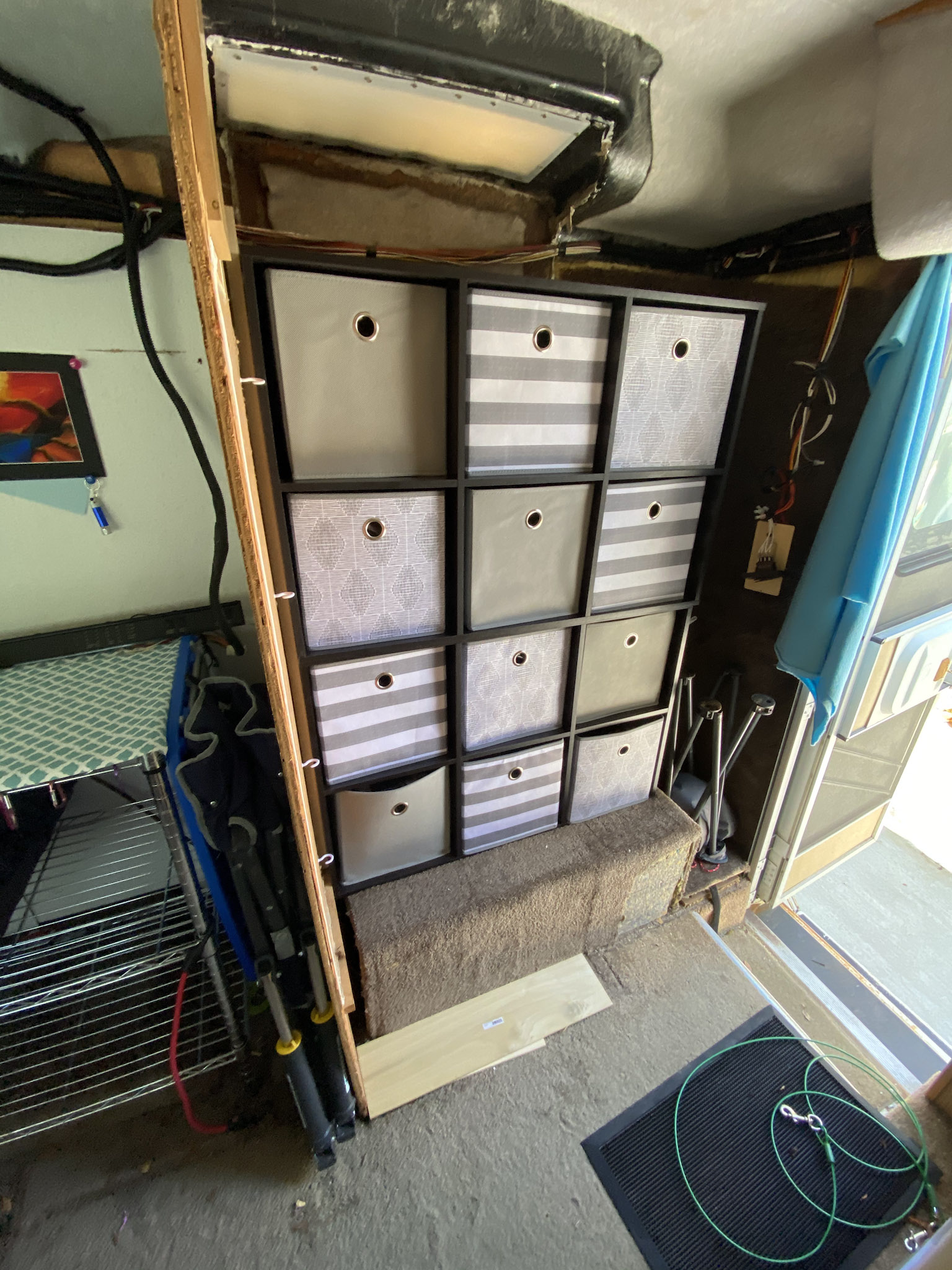

For the section behind the plywood divider, where the fridge and closet were, I decided to try out a wall of shallow cubbies. Behold, prototype from big-box flatpack:
It's screwed to that plywood divider on the side, and also into the few bits of wood along the back wall, under the carpet and around the back of the fridge. I also filled the bottom row with heavy stuff - bottled water and tools. I added large-ish cup hooks to either side and ran a bit of rope across each row to prevent the bins sliding out. It is not a long-term solution, but it worked reasonably well for a few hours' driving and let me try this idea without stuff crashing around when I go around corners.
This is a very successful prototype, IMO.
- It provides a ton of useful storage, organized but easily accessed. I still had empty bins in the top row at the end of a week-long trip!
- It gives me elbow room (and butt and shoulder room) when coming in the back door, putting coats on/off, leashing up the dog, drying off after a shower, etc.
- The top of the cubbies and the exposed ledge of the generator compartment provide a little drop space for setting things down temporarily.
