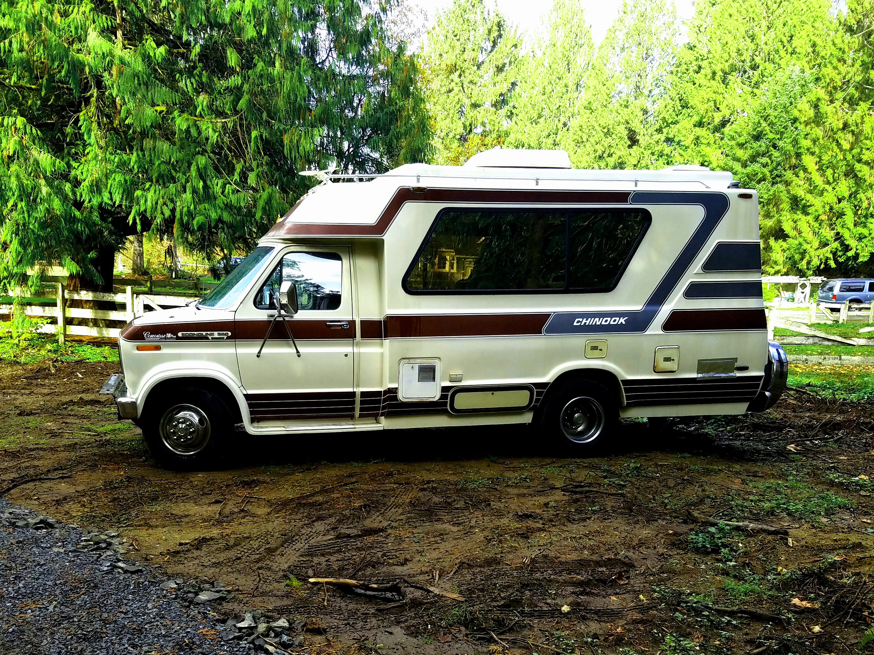

Just to fully disclose, my current unit is a 1987 with a 6.9 IDI international diesel. The chassis has 90k miles on it. I've spent 3 grand getting all the mechanical done, which included a transmission, vacuum pump, fuel gauge, window motor, radiator flush, thermostat, valve cover gaskets, oil change, 2 new batteries and heater blower. We looked everything over and gave it what it needed. It had recent injectors and glow plugs, and return lines and filters. The running gear is now fantastic.
I'm in it 10k. Interior needs completely redone. I actually wanted a unit I could completely redo the interior and still be "in it" right.
I haven't posted any of that remodel because we're building a house and shop this year and I won't be able to get to it till 2021. I'm making this one my keeper.
