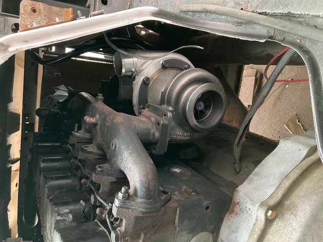

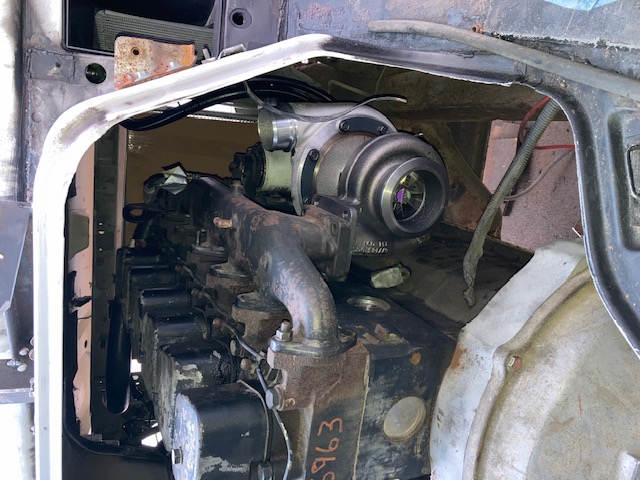

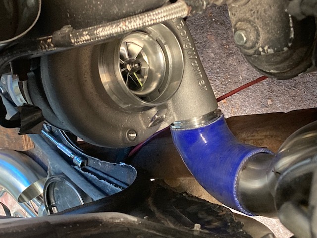

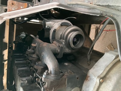

upper rad hose is finished and i have the pieces to finish the bottom tomorrow, set the manifold and turbo in place to see how it is going to fit, i have a steed speed manifold with a t4i flange on it and will change it to a t4 flange to fit my sxe turbo

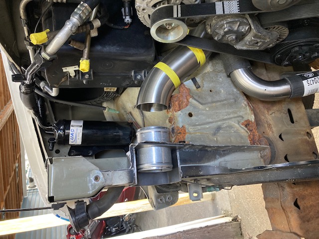

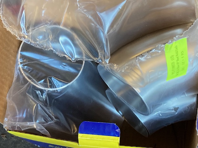

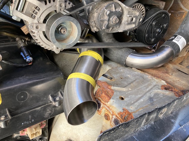

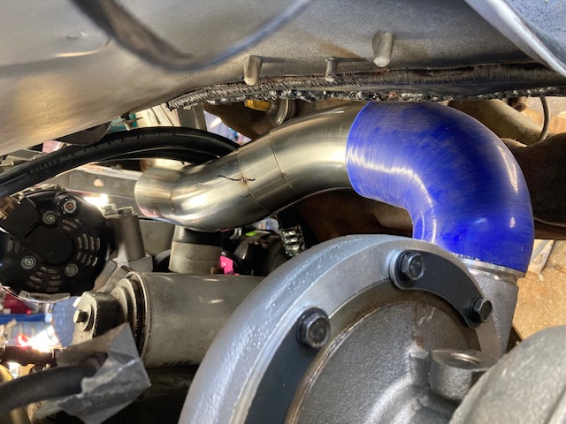

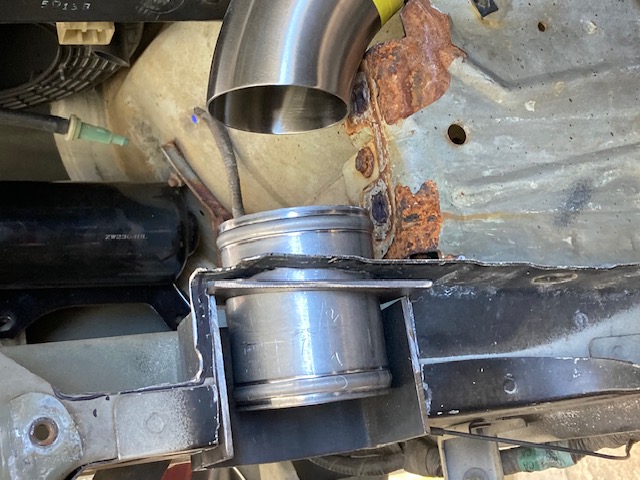

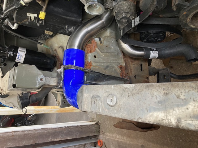

i have got my intercooler boots so i will start building tubes today, i have the flange welded onto the manifold and the downpipe clearing the doghouse now pictures to follow

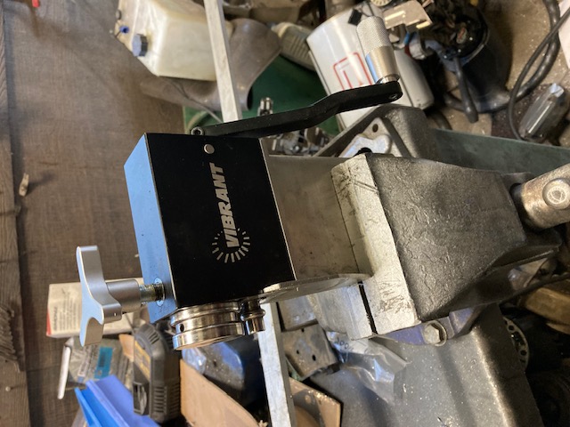

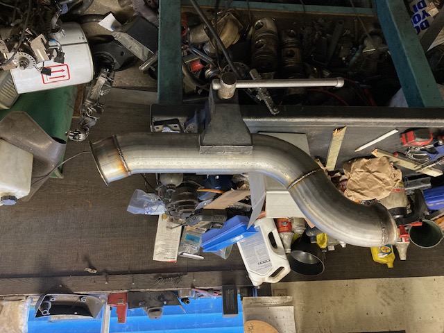

building a intercooler pipe to snake through to the front is fun, lots od stainless 45 degree fitting and tig welding

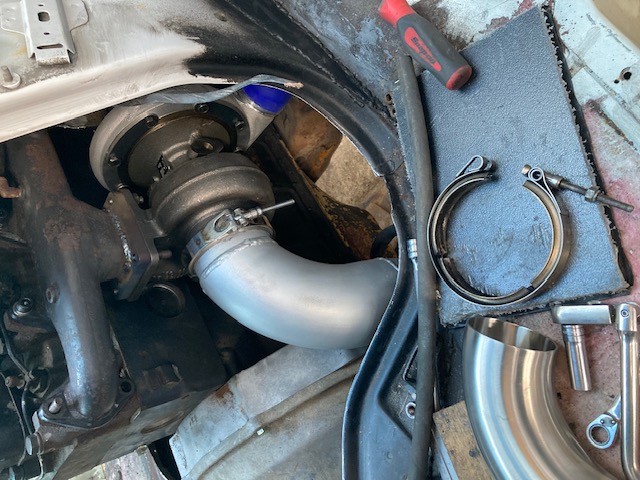

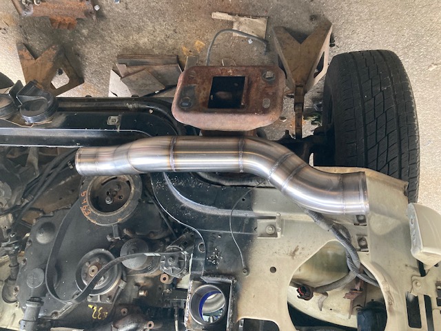

picture of the downpipe before vht header paint, the other flange is for the pacbrake exhaust brake

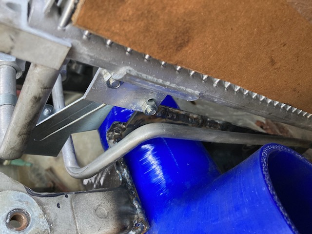

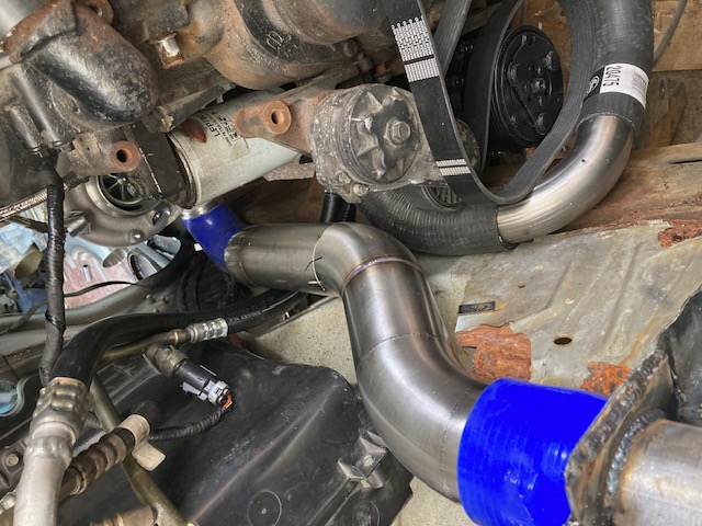

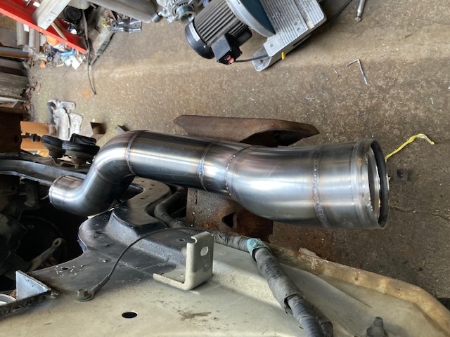

hope it get the intercooler mounted and the tubes finished today
got the one side done today
