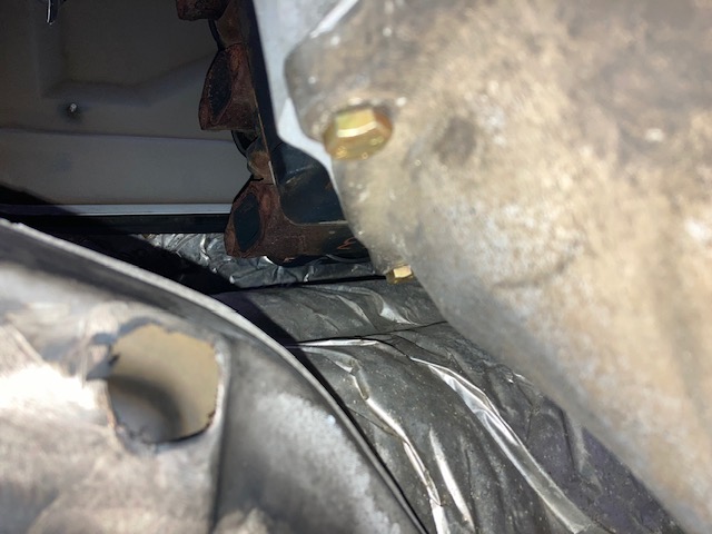

Any concern with the clearance between the turbo and heater box? I'm guessing it'll be a pretty mellow build on the motor since it's an RV 8-)

no i put a blanket on the turbine housing

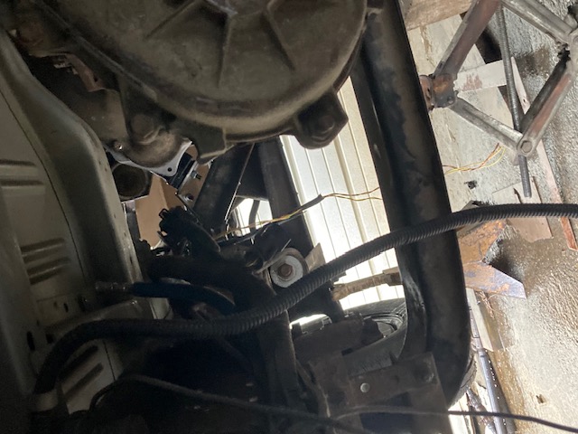

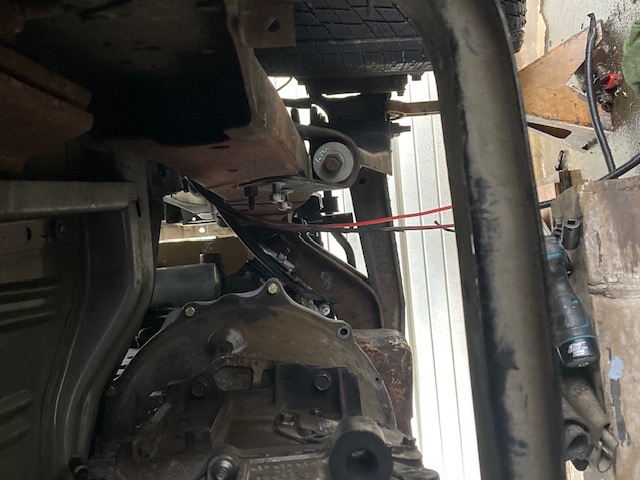

got the engine mounts tacked up and the engine resting in them, the tranny bolted to the back and shifter hole cut out, maybe tomorrow the tranny mount will get built
noluck
Posts: 246
Location: Abbotsford BC
Post by noluck »
transmission crossmember stayed in the same location, and just had to add a second set of holes, had to drop 3" and one of the tranny mounnt bolts hit a original spot so only needed to add one slot.
took measurements for the driveshaft and one is being built, should be done this week, pinion and tranny angles are 0.90 of a degree, real happy with that

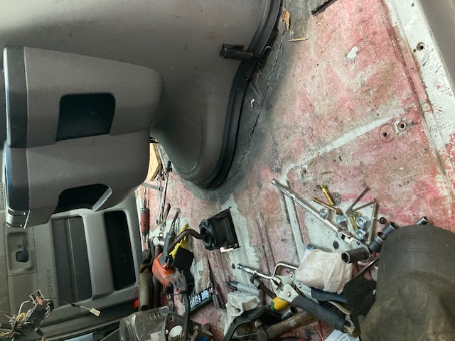

You're zoomin' right along! Great spot for that shifter; It looks just right.

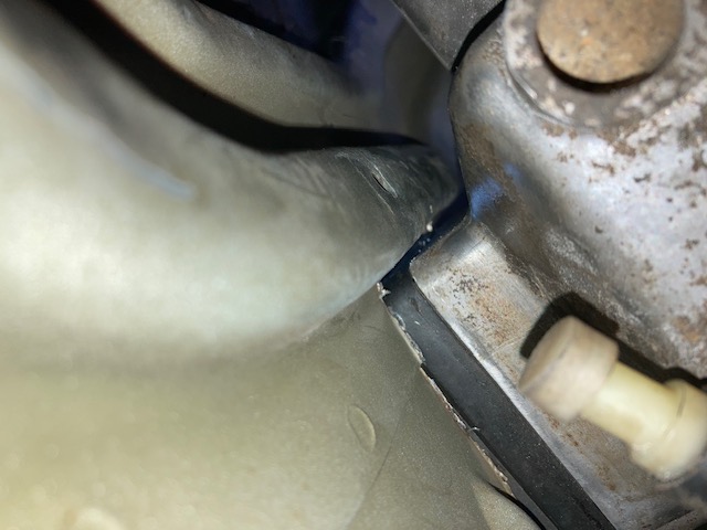

i have 1/4" clearance between the tranny and floor :D and t case clears easy as well

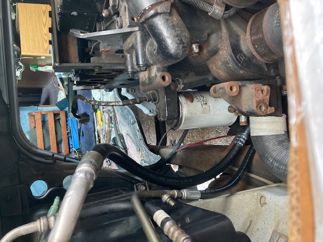

hopefully my exhaust manifold will be here this week so i can mount the turbo and build intercooler piping and exhaust, i have ordered all my silicone couplers they will be here next week. i will be getting to building my a/c lines pretty quick as well. and get the line and fitting to hook up the power steering. this is the really fun part for me! i just love how my real estate i have in the van, this is one of the easier builds i have done ( engine wise)

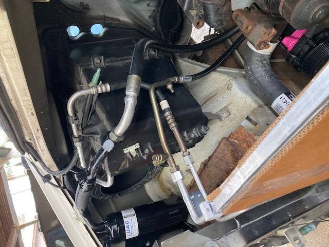

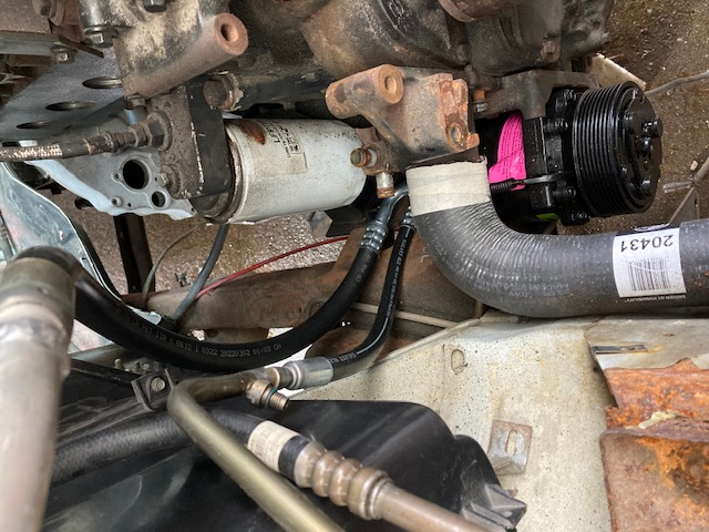

ac lines finished,
