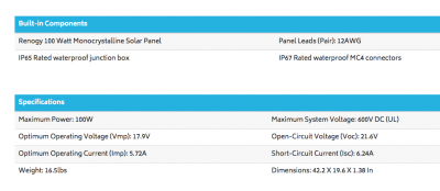

I will be very curious to see what the specs are on the compacts you get, specifically the Vmp. I see they list it as 17.x on their site now, but they carry the same model number as the 16 volt panels. I like the 16-volters for series, but would not want them for parallel. If you do get ones that are 17.x, I might like to buy a couple for another project where I might use them in parallel. So, I'm curious! (And if you get 17.x volts, did you get them from Amazon, Renogy, or? Buying from the same place might increase the chances of getting the same ones.)
Maybe you wouldn't mind posting a photo of that spec label that's on the back of the panels?
I'd prefer 18" wide panels, but it's sure nice to get ones that are 1.5" narrower (19.6" vs. around 21") and they are so darned cheap now. Can't complain too much.

Couldn't agree more Blue! Photo of the labels as soon as they arrive, fingers crossed they are 17.x. I'd love them to be 18" wide as well but I suspect this will be as close as we come for a while. Got all my stuff through Amazon Canada which surprisingly, was cheaper than the U.S. prices when I calculated our dollar exchange on almost all the items. I'll take it!

HQST has the identical "Compact Design" 100w panel (same specs/sticker/product photo) as Renogy... for $99 on Amazon. A third party seller?

Less than perfect news! You are indeed correct Blue, the sticker that you and Hoosier have both posted is correct and they are 16.x and not 17.x as they said on the phone! GEEZ!! In any event, I've chosen not to care and will roll with these. They are going to be perfect or as close to it anyways as I can get, especially for the price of my system. I love the fact that they are narrower. Stay tuned for the complete 948 photo install! :lol:

I would but it was a 30 minute wait last time! :shock: In all fairness, I went back and looked at the Amazon listing and the info there was correct, I'm just not sure why it was different. In any event, they are going to great and 1,000 times better than what was there. I'm excited!

Now I'm confused! Attached screen shot of Renogy's website description of their Compact Design panel # RNG-100D-SS.
