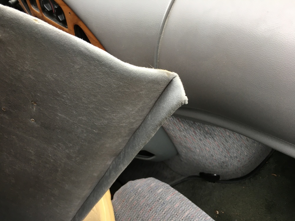

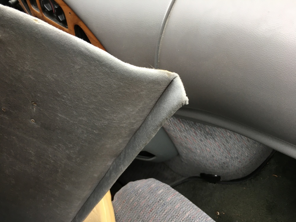

From what I recall of the pillar, that left edge is curved. I had to pull the right edge away from its side until the pillar was almost at a right angle to the coach wall and then pop it a bit with my palm. Impossible with the couch in the way, had to remove it. Was able to do it while the couch metal frame was in place, but the next time, after I'd completely removed the couch and frame, it was much easier because I could bend it just that little bit further before popping it out with my palm.

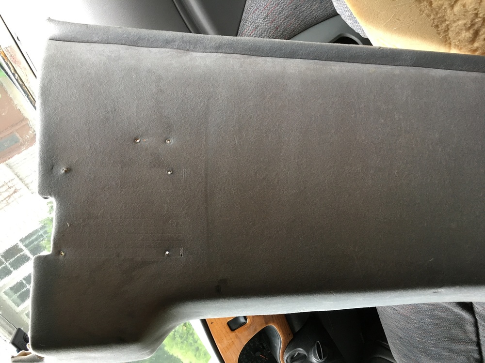

Got a couple images, much better than my description! THe panel is sitting upside down on the front seat and the images are only showing the top portion, which is really the bottom of the pillar. You can see the screw holes on the panel where the LVD was attached.

Thank you, Bob, for the info. It explains why I can't remove the pillar piece. I am going to try to work with it without remove it completely, and see if I can get it done. Otherwise, I will remove the sofa, and do what you suggested.
