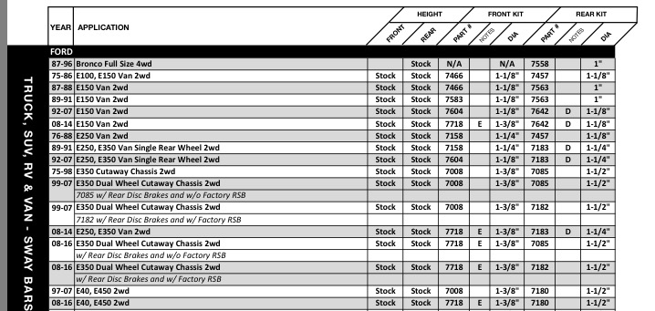

Scott wrote:Did you get the Hellwig 7604? I'm shopping for front and rear sway bars. Looking for suggestions.
I went with the 7008 for my '95 front bar.
hellwig bar catalog
hellwig bar catalog
Although it was the same size left-right as the stock one, it seemed about an inch too wide (half inch each side) for the new U-bolt suspension mounts because of some frame parts in the way. Maybe it was only because mine is actually a fairly early E350, made in 1992. Anyway, it worked out and was pretty easy to do.
Adding a rear bar is what concerns me, because at first glance, I think my rear muffler might have to be moved. Not sure yet.
