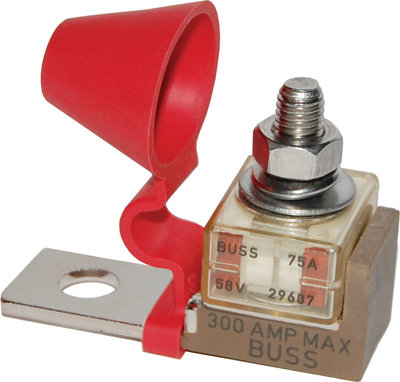

I'm not clear whether or not you're wanting to be able to use the jump start function, but let's say you do (I would want it since you'll be so close to having it). Then it's a matter of how important it is to you to have the safety of overcurrent protection. It's very important to me, and I'd recommend it highly. Batteries can give up a lot of power very suddenly if there is ever a short (and in a moving vehicle...it's not totally out of the question).
Having the short distances (with both of your batteries under the hood) is great. If you size the wires to enable fusing (overcurrent protection) then you will have no problem at all with voltage drop (big bonus). If you know the draw of your starter, that would be great. Otherwise, we could go with the draw of the V-10 starter as a good ballpark. I find that the bare (bare!) minimum for fusing for self-jump-start is 200 amps, and 225 is better. What that means is you could juuuuust skimp by with 2AWG wire (by over-rating the fuse, which is sort of allowed although not my favorite thing), or you could use 1AWG (or larger) and comfortably fuse it.
I ran 1/0 AWG (one size larger than 1) but that's because with the house battery aft, it's at least a 16' run between batteries so voltage drop comes into play (also I don't tend to have 1 AWG on hand).
So upshot is, I would encourage you to go with a "full circle" cable run that you can fuse for the starter's draw. This would be the positive cable from Ford to 7622, the positive cable from 7622 to house, the negative cable from house to frame, and the negative cable from frame/chassis to Ford battery. One fuse would go on the positive terminal (or within 7") of each battery. I like the Blue Sea MRBF if you have the height (I do but I have the V-10 so layout is a bit different). These have enough AIC rating for a typical single battery, you don't need extra jumpers, don't need to figure out where/how to mount the fuse, and there is no unprotected wire.

Argh! So of course I was 85% of the way through a detailed reply to kdarling's question about "why it needs larger wires" when I realized I had forgotten to plug in and my laptop battery died. So aggravating.
I will re-write this later. The short answer is that unless you have larger wire you cannot provide OCP (that is, Overcurrnet Protection, e.g. fuse or breaker). Without OCP you have a big problem waiting to happen if there is ever a short (and what could possibly go wrong in a moving vehicle with lots of metal and a chassis ground?). Just as one example, a Lifeline Group 27 battery (using this example because they publish the stats) can discharge 3,374 amps in a short circuit situation. If the circuit is not protected something bad is very likely to happen. Smaller wire can only be protected by smaller fuses and those will blow every time you self-jump start (or every time you alternator charge the house bank if the wire is small enough). This is likely why Chinook did not provide OCP to this circuit (that's the "solution" to using wires too small to protect, and is often used in RV's. Most people get lucky and nothing happens.
But while it's one thing to have an existing circuit be this way, I have a hard time purposely installing a new one without bringing it up to safe standards. So I improve as I change things. Figured reddingnative might want to as well, especially considering the large amperages involved.
In my previous reply I used examples with numbers/wire gauges/ampacity ratings, etc. I'll come back and do that again when I cool off from the "lost" post :D
