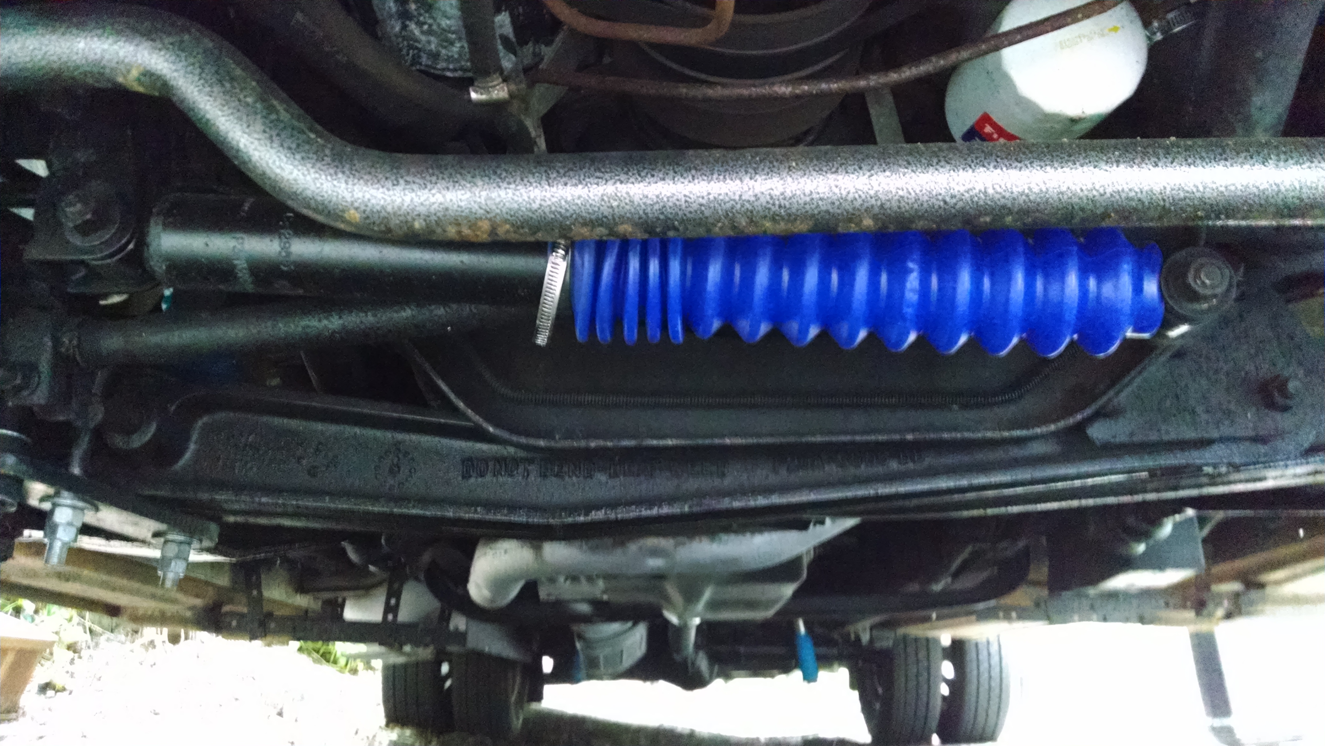

After getting the Bilsteins, I decided that the replacement OEM Ford steering damper shock deserved its own blue boot :)
So I bought this inexpensive one off eBay as it seemed long enough for the ~10" of steering movement left to right.
And it fits just right. I put it on with the wheels turned hard right (compressed) so I'd know how far onto the shock body the boot had to go. And here it is before I trim the extra bent worm gear metal tape, with the front wheels hard left (almost fully extended):
In the background you can vaguely make out a new rear shock, and the freshly wire brushed and painted propane tank, exhaust system and driveshaft. In the foreground is the new Hellwig antisway bar and its I-beam U bolts.

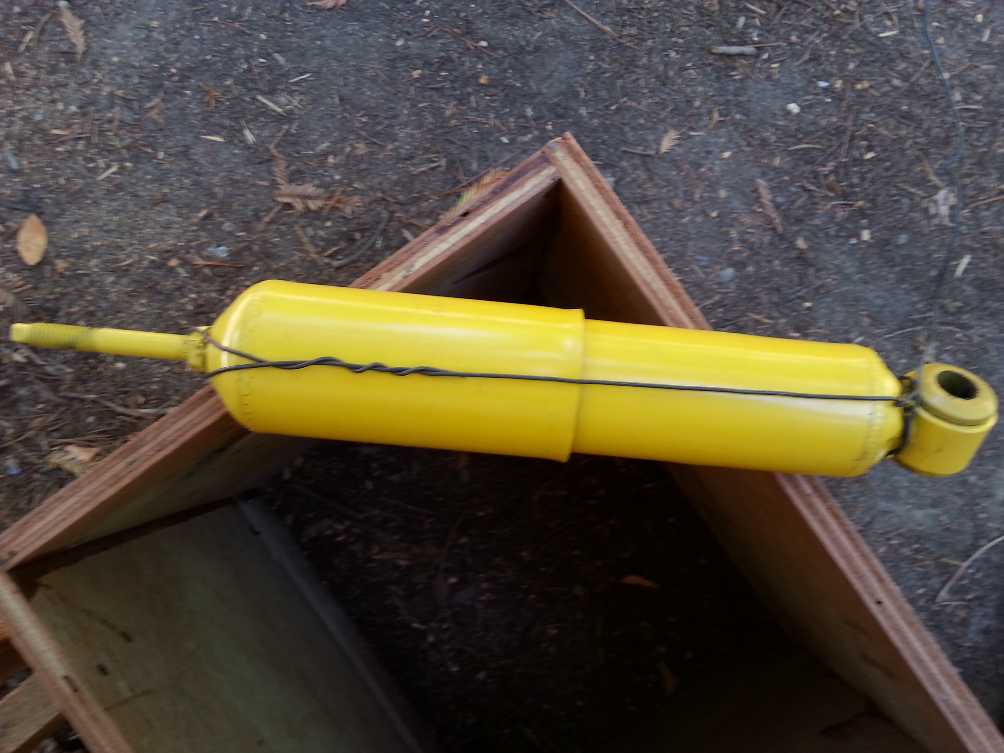

Kevin already provided some great information regarding shocks installation. I just wanted to add a bit from my experience yesterday installing Monroe 34760 and 34761 Gas-Magnums. The night before, I applied penetrating oil to the fasteners. I used rebar tie wire to hold the shocks compressed.
Installed the bottom end first, clipped the wire, guided the top through the hole. The OE top bushings are one piece and a pain to get out. Push down on one half with a prybar and slit the stretched rubber with a utility knife; they'll let go fairly easily. Another thing I did was jack the front just to the point that a wrench would go between the spring windings so I could get a greater rotation angle.

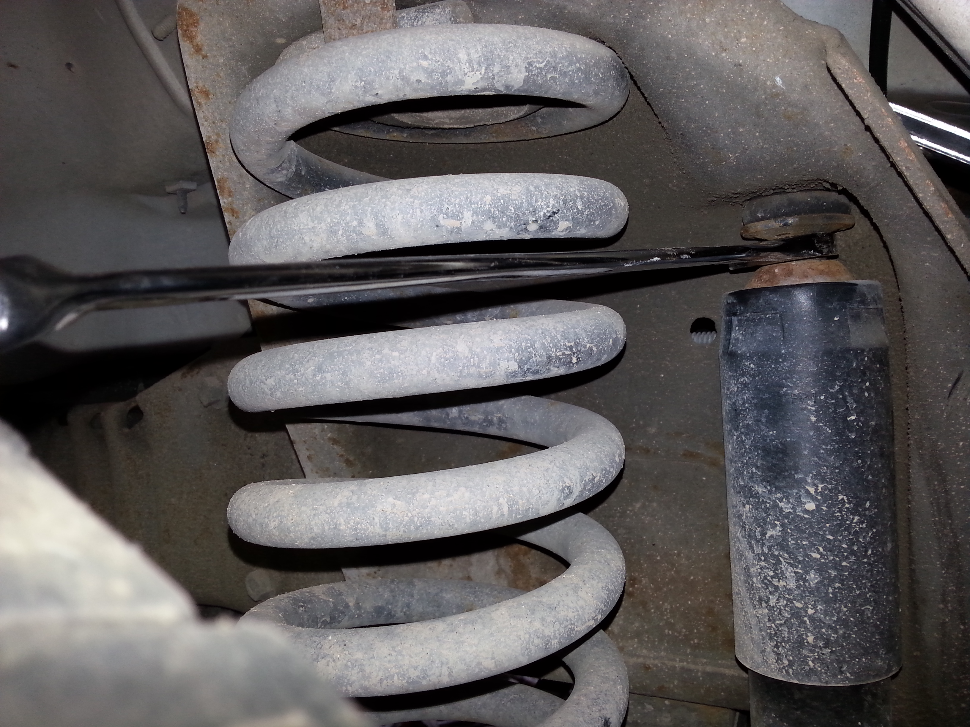

An angled ratcheting box wrench proved very useful to hold the top nuts.

Correct, I came from the back; you can just see the top wrench in the photo. I do not have small hands, but I could get up/in there OK. I think the ABS pigtail was in the way a bit, but not a barrier.

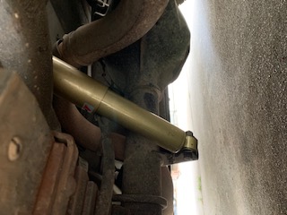

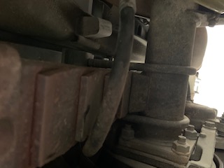

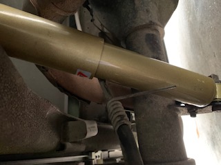

I do have a question for the group. That right rear- as I was installing the new shock, the e-brake line was in the way to where it's up against the shock. Since I didn't take a before pic, I'm not sure if it was like that before, but I would assume so. There just doesn't seem to be any other position for it, and routing on the other side of the shock was even worse. There's also a "spring" like thing on the line with a straightened end that sticks out. It just free floats on the line. Please take a look at the pictures and let me know what I'm missing. As you see, the line touches the leaf spring AND the shock. Did I do something wrong? Is there any way someone could take a look under theirs as a comparison? Headed out for a trip this afternoon and don't want to mess something up. It just doesn't make logical sense for an e-brake line to touch ANYTHING.

For the brake line... my rear end setup is slightly different since I have drum brakes, so I can't speak from direct experience. But generically, under no circumstances should a brake line be touching anything that isn't intended to keep it positioned. It's hard for me to tell from your photo cuz it's pretty dark but that spring thing is usually a retainer to keep lines away from items that might cause abrasion. It's not something to panic about, but I would definitely want to correct it.

You bet! Credit where credit is due. Upon further assessment, it's the e-brake line. Got back under and found the mounting location. It had pulled out at some point. The mounting location was right next to the lower shock bolt. Issue resolved!
