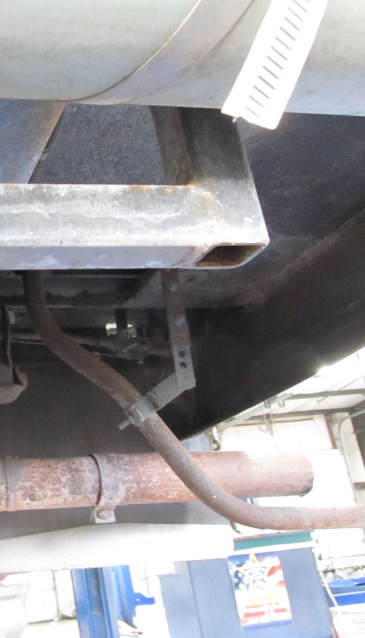

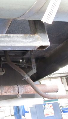

pdemarest wrote: April 16th, 2018, 10:23 am They also bent the final run of the exhaust pipe that extends slightly beyond the RV body so that it is now level to the ground...
I'm curious: How did yours sit before? I would describe my stock pipe as basically "level to the ground," so that caught my eye. Or do you mean that basically level wasn't good enough and it needed to be just a few degrees more perfect?
Here is my original pipe. It ends just at the right side of the photo. The larger pipe behind it is the stock Ford exhaust pipe.
pdemarest
Posts: 384
Location: Santa Cruz, CA
Re: Generator Noise
Post by pdemarest »
