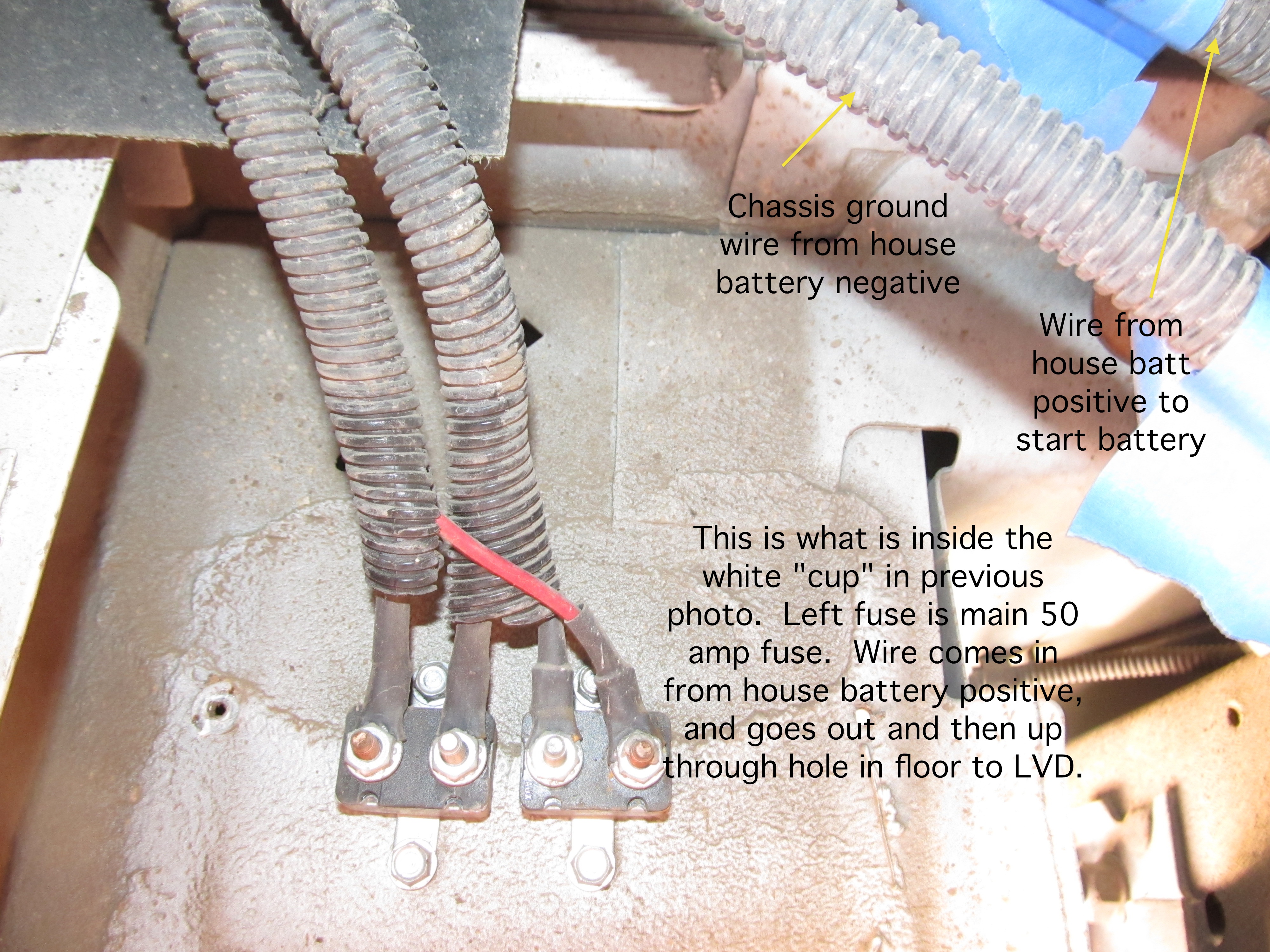

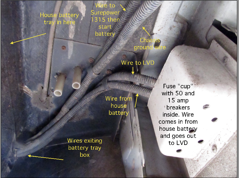

Okay, here are some photos from underneath my rig as it was originally. I'm going to guess yours are similar, except you should also have the generator start positive wire coming in (it likely runs up driver's side frame rail from the rear, as mine does). This should have an 80 amp breaker on it - maybe it's in the "cup" too? Mine went up to the start battery so the breaker was up there under the Ford hood.
If you just slip under the rig forward of the battery box, this is what you should see (or similar):
