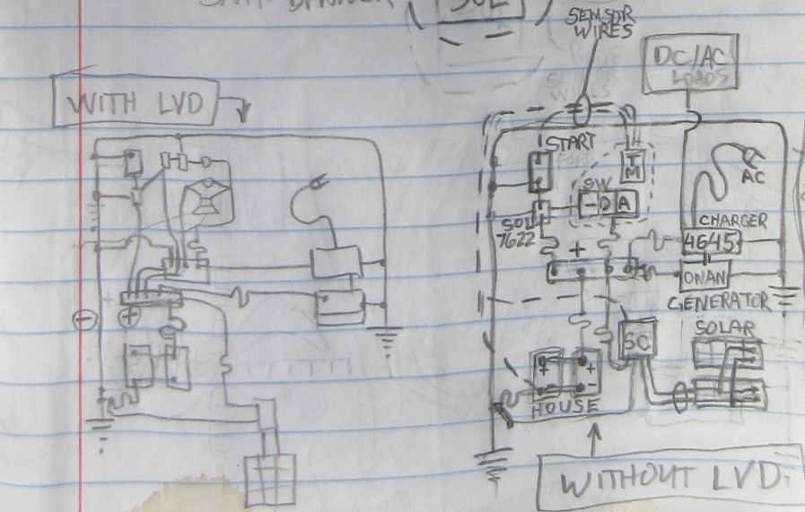

Hi Chin,
The ability to tilt the things was just a byproduct of the final design. I have not ever bothered to tilt in use, too much work; but could some day if sitting for a while in a East/West orientation, tilting the panels to the South. It would require a couple of struts to hold 'them up.
If I added a couple more panels, which the controller can handle, I'd make them portable with a length of PV cable and some sort of connector/receptacle. Those panels could be deployed to catch max sunlight. Where to stash them underway, however, I don't know.
I ripped out the LVD and the battery isolation unit on the left front fender.
Roly

Your new setup with the BS 7622 and MPPT is very similar to one of my plans. However, I have not order all the components and get to itRoly wrote: July 24th, 2020, 2:39 pm I ripped out the LVD and the battery isolation unit on the left front fender.
