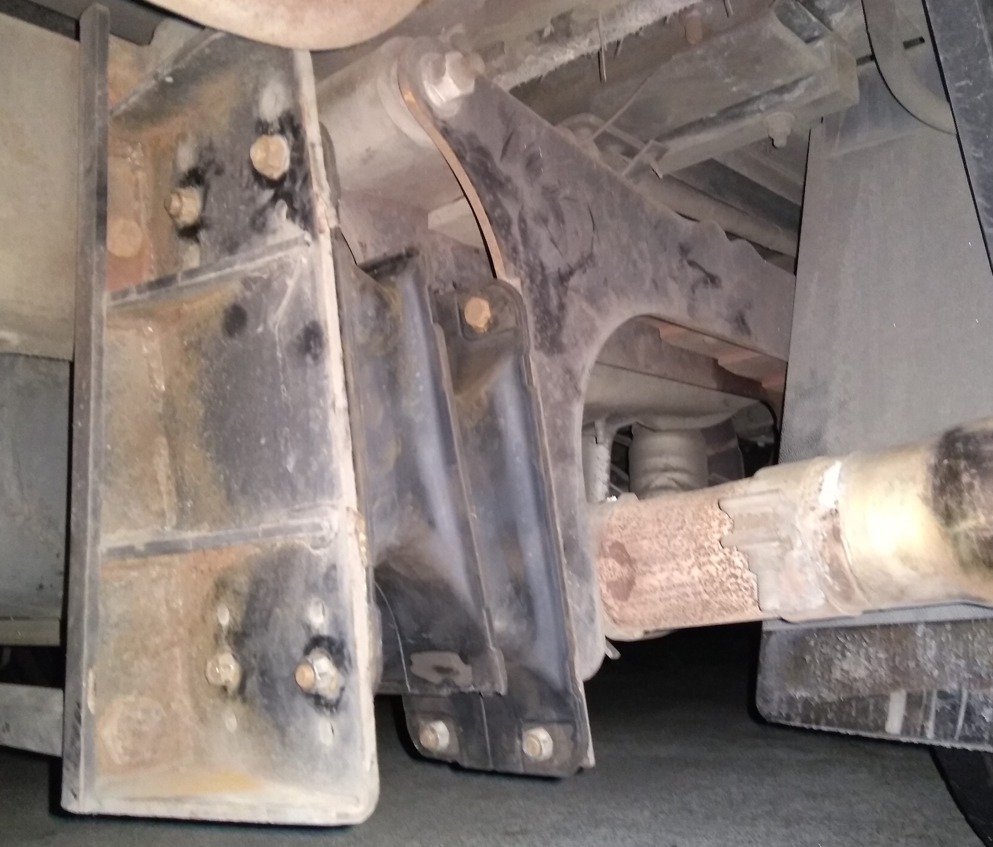

Sorry, we're talking about two different things. 1) the vertical position of the rear axle and, 2) the subsequent change of vehicle ride height (at extreme opposite ends like the bumpers).
I read something earlier in this thread and just wanted to say that an inch of adjustment in the rear spring perch does not result in an inch of adjustment in the spacing between the axle housing and the frame/bump stop).
So if you move the more ryde an inch, that moves the axle a half inch. Your description of the effect is correct. It will probably move the rear bumper quite a bit more than a half inch. The vehicle would rotate about the front axle and the front bumper would drop (slightly), if all else remained unchanged.

Clay was nice to point out that as in many things, there is a trade-off with ground clearance and vertical clearance.
I may understand Scott's comment about the actual increase in height to be half of the adjustment distance due to the connection to the front of the leaf. So, if you raise one end of the leaf up, the opposite end will raise proportionately as they are both attached to the frame, correct? What balances it out, as surely there is a limit? The length of the leaf, distance from the axle, leverage from the added length of MORryde, etc....it's making my head hurt to think about all the forces involved.

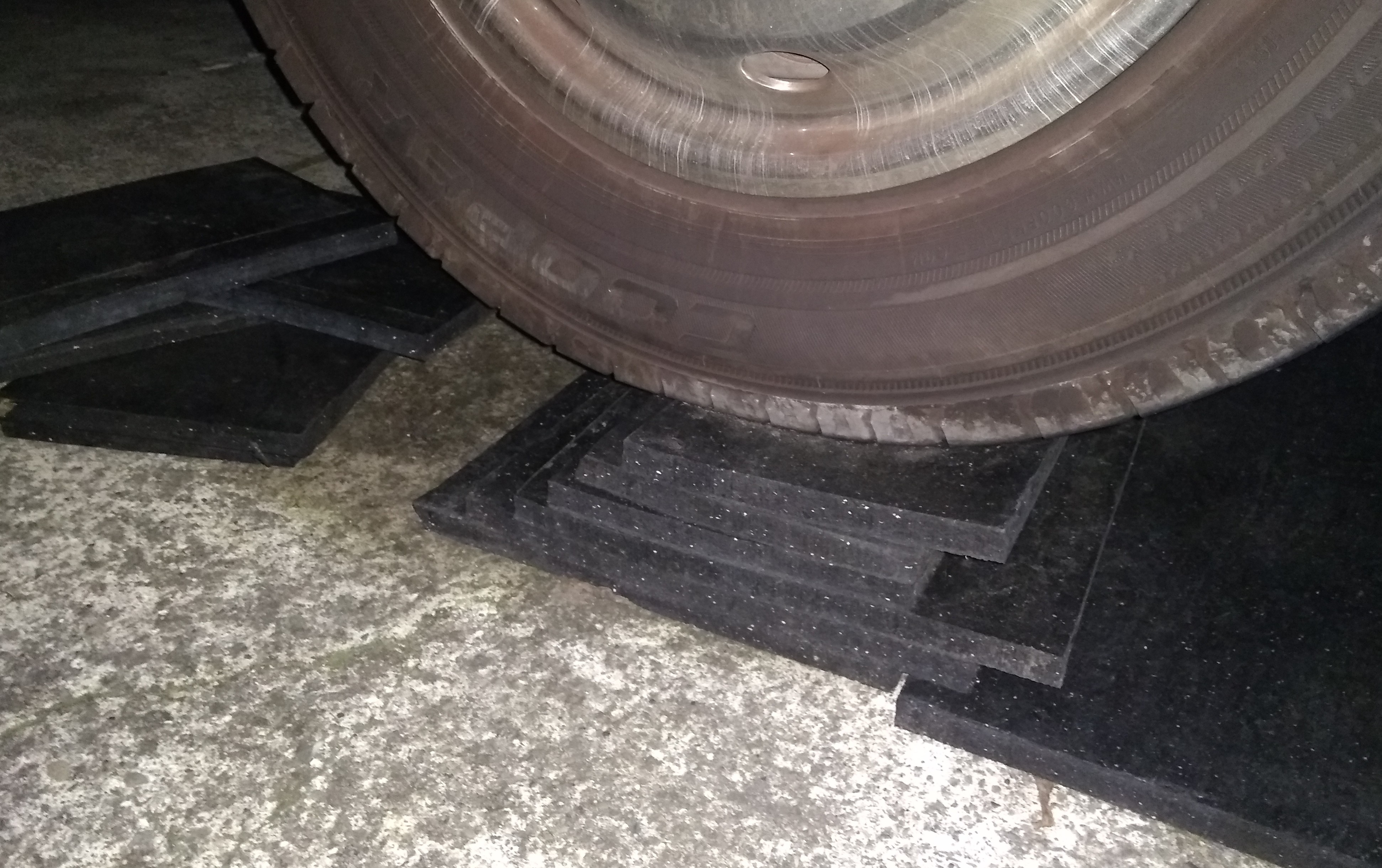

BTW, Chin, those rubber mats are used in gyms, so you can use them on the floor and create your own 24 Hour Fitness on wheels. If you just want to use them to park on, I'm on six layers right now. Gonna try to jump the Chinook off them.
The inch I am speaking of is the same inch, but from different perspectives. The perspective from the ground clearance gained looks different from the roof as you approach a low hanging obstruction.Blue~Go wrote: January 25th, 2019, 10:04 am Where is the "other" inch you are speaking of? Are you thinking the front? I don't see that as an inch for an inch because the front has comparatively "no" overhang as compared to the back.

Oh I see, you meant overhead clearance. Now I get it. Somehow that went right "over my head"
For me, the rear overhang/departure angle is a potential issue much, much more often than overhead clearance (in that sort of situation it's usually width that gets me on a narrow track, not height), so I wasn't thinking about overhead. But if you are trying to get into a specific garage and inch(es) count, maybe it is a key factor.

Update: Wanted to let you know I had a new leaf spring added to each side, and new gas struts. When they did this work they saw that both Mor-Ryde pads were torn, so they replaced those the following week. The initial work raised my rig 4 inches and the difference with the new Mor-Ryde pads was phenomenal. Before, if I drove slowly over any bump, say a rumble strip, the back end of the rig would come down hard. My dishes would rattle. Dirt roads could NOT be driven on faster than 3-4 MPH if they had ruts, potholes or washboards.
As it happened, after I got the work done, I went down a rutted dirt road. Wow-- it was almost like driving a car. The bumps were so QUIET! I could go a little faster, but most importantly my rig wasn't being shook up. Highly recommend replacing Mor-Ryde pads if you are experiencing a hard ride over bumps, and adding new leafs (leaves?) if your rig sits too low.

It would be very interesting to see a photo of your rear leafs now with the Chinook sitting down on its wheels. I'd like to see what they added and how it all looks.
