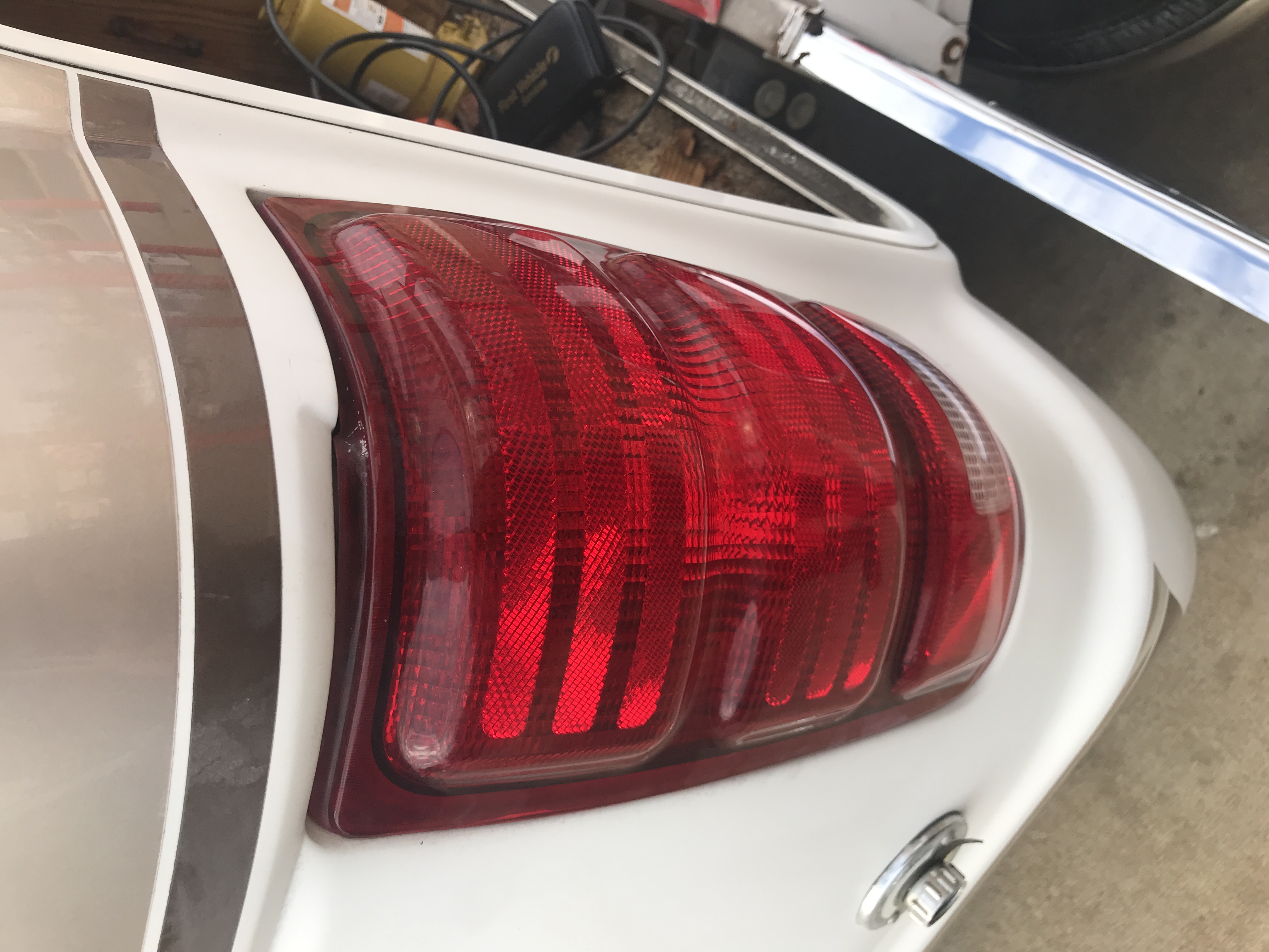

Still in SC looking to replace a left blinker, but no idea how to get the lease off. How is this done???
Re: Ft. Jackson/Columbia, SC to Seattle, WA
I don't know how to take the lenses cover apart, sorry.

I think it’s the front blinker that’s out, maybe not the rear one. Both come on when I turn the lights on, but the front doesn’t blink... the rear does but very fast.
I tried to find a Robertson a few driver, but no one knows what it is. I think it’s a star or hex?

There she is! That year (and all years newer) used the stock taillights from a Ford Expedition. The lenses just pull out/push in (no fasteners).
(One year previous [mine] they used stock Ford E-Series van taillights, which do screw in. But you don't have those.)
Robertson drive is also known as square drive. Most will be #2, but some of the interior screws are #1, so good to have both if you can.
Sometimes (at least back in the day) a fast blinker would be the flasher unit going out (often under dash). Not sure how/where/if we have one of those. But I think you can also get a fast blink with a bulb out though.
