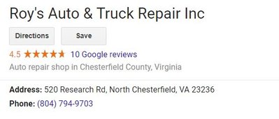

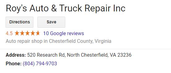

Bill, I’m going to check with Action. When I originally read this thread, I thought you had included where you had your work installed. Now I cannot seem to find it. Could I trouble you for contact info on the shop that performed your work?
Thanks,
Ken

NOt a worry! The folks at Roy's are just good working people, primarily work on area trucks, but there are always a few RV's around too. They installed my rear springs/shocks. I'd have them install a lift kit for sure. Be prepared to get your job bumped if one of their regular business customers comes in with a down truck. Every town has a company like this and glad I have one.
