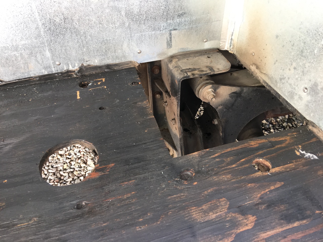

Here I present a quirky solution to sealing the generator cabinet floor effectively. My floorboard was warped with gaping holes, as shown in the first picture. Note the top view of the MorRyde suspension shackle, by the way.

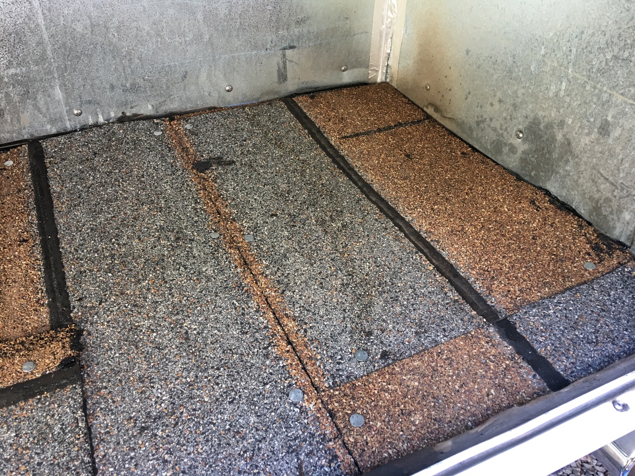

The floor is 34” x 19 1/2” and the door is too narrow to admit a one-piece rigid insert. I chose to tack down a flexible covering consisting of two layers of spare roofing shingles. These covered the gaping holes nicely with a liberal bead of roofing tar as sealant.

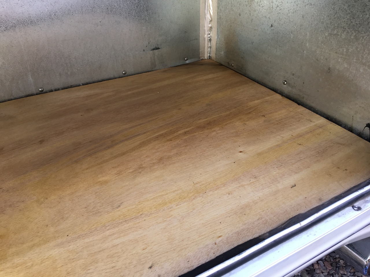

The last picture shows the overlay of 1/2” ply board. It is held in place by an interference fit and treated with Thompson’s Water Seal.

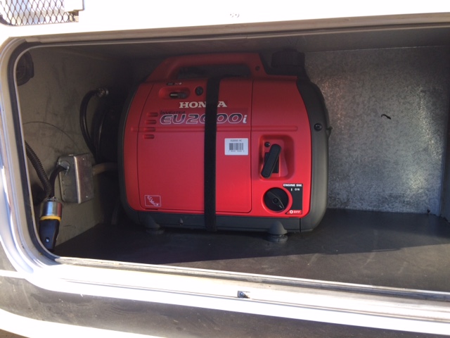

Taking out the old Gen was fun,fortunately our door frame unscrewed and was removed,I tried without taking it out and the Gen wouldn't fit through the opening,had to cut the 120v wires also, thanks for the tips!!
I put down a plywood overlay and screwed it in then undercoated all the openings underneath with a spray rubberized flexible coating and silicon-ed all around the inside.I used a cut fatigue mat over the inside bay floor to keep things from sliding around and strapped the Honda secure.
I then but a valve on the 1/4" gas line and connected it to a marine bulb pump with a 2' line that I can use to fill the Honda gen if needed, like having a 39 gallon gas can and no need to have one stored.
Then I put in a handy box and connected the 120v Onan gen feed to a pig tail that I connect to the Honda 2000i away from the coach, much more quite and not smelling up the inside when the door or windows are open.
