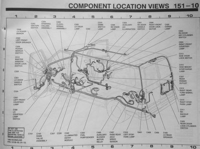

Blue~Go wrote:PS: At least on my year, the Ford trailer wiring "schnozzle" wiring runs along the driver's side frame rail under the coach. Maybe all cutaways do that since there is no interior Ford floor.
You must be right. The diagram shows lower left, but I can see now that it is likely along the frame. (see pic below)
Re: cutaway manual. I think those are only about safety and emissions compliance.
Re: your side panel being off. I also wonder if the top courtesy / maplights still follow that path? Thanks!
Electrical manual page
This is just one of many wire, ground, junction and connector location maps in the Electrical & Vacuum manuals. Most useful to us cab forward and chassis below, of course.
